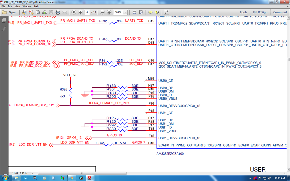

We made one customised board using AM3352 ZCZ Package and we don't want to use USB Ports both 0 & 1.We have grounded corresponding pins as shown below in schematics.
We have provided 1.8V (VDDA1P8V_USB0 & VDDA1P8V_USB1) and 3.3V (VDDA3P3V_USB0 & VDDA3P3V_USB1) supplies to USB Power pins of AM335x as per the schematics checklist provided by TI wikipage.
While booting process we are getting the following error
"ti81xx_interrupt 1146: VBUS error workaround (delay coming)"
Is there any USB drivers or pin configurations to be removed from kernel software files ... ? Please specify the path of the files to be removed ...
Thanks in advance
    What Linux version is this?
    Latest version u-boot2016.05
    We tried disabling USB drivers in kernel file ... it got stuck at loading boot image .... only
    Any other changes required ...? Please specify the path of the files to be changed ...

  • I'd lean more strongly to SW rather than HW. The issue appears to be related to the fact that with both USB ports disabled, there is no instance of VBUS_VALID. This shouldn't matter of course...
    I think the SW isn't being configured to disable/ignore USB in a USB-less design such as this.
  • Manjunath,
    If usb is not used at all, you should disable 'USB Support' under 'Device Drivers' in kernel menuconfig. Is this what you did but kernel fails to boot?
  • Hi binu,
                  Thanks ... We were successfully able to disable both USB ports ... Now that error is not coming ...

  • I notice you are using a very old SDK. Since you are using a 25MHz clock source, did you modify u-boot and the kernel. In u-boot, in include/configs/am335x_evm.h you have to change
    #define V_OSCK                          24000000  /* Clock output from T2 */
    to
    #define V_OSCK                          25000000  /* Clock output from T2 */
    In the kernel, you have to change arch/arm/mach-omap2/clock33xx_data.c
    static struct clk sys_clkin_ck = {
            .name           = "sys_clkin_ck",
            .parent         = &virt_24m_ck,
    to
            .parent         = &virt_25m_ck,
    It could be that the clocks are not set correctly.
    Steve K.

    Upto "Starting udev its fine" ...  After that some problem in booting process ... Its behaving abruptly each time when we power on and off ...
    Same files is getting booted in AM335x starter kit board ...
    We have disabled LCD Display and USB ports drivers in menu config ... We are booting through MMC0 ...
    We checked DDR3 using emulator ... Its fine ...
    What is that udev file ? Any changes are required in that file ... Please suggest us ...

    Thanks in advance.
          Thanks for the reply.We have made the changes as per the previous post in u-boot and kernel files.We compiled and checked it.
    Below is the console log.
