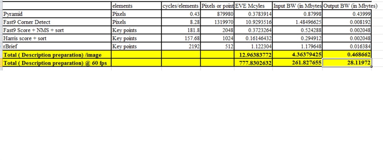

Can you please provide us with expected DDR load for ORB with following parameters.
Data Format RGBA 8888, 4 video frame, @ 60 FPS.
Scales are 256x540 & 197x415
Following are some assumptions
1. that data is in DDR and internal memory
2. Scales generated by independent scaler
3. Scales generation is done in EVE
