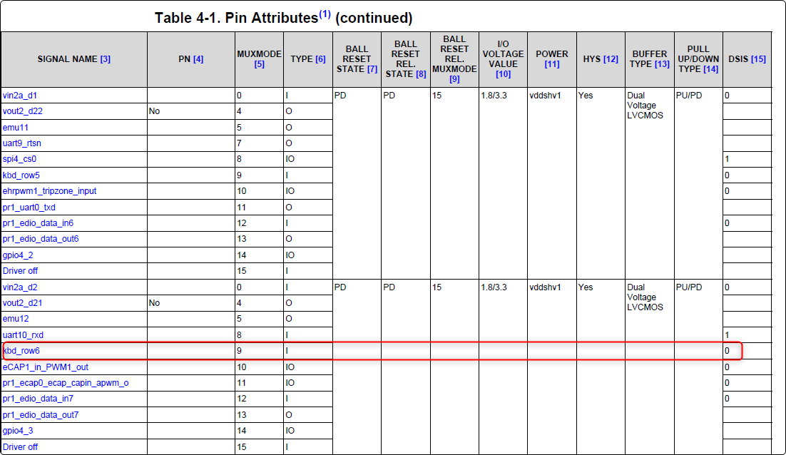

Hi:
I have a custom AM5708 based board and want to use keyboard controller to handle a key pad.
I am working with SDK Linux RT 5.00.00.15.
Attached are the dts and config file for Linux
During Linux startup I get the following message:
[    1.926557] omap4-keypad 4ae1c00000000080.keypad: no base address specified
[    1.933577] omap4-keypad: probe of 4ae1c00000000080.keypad failed with error2

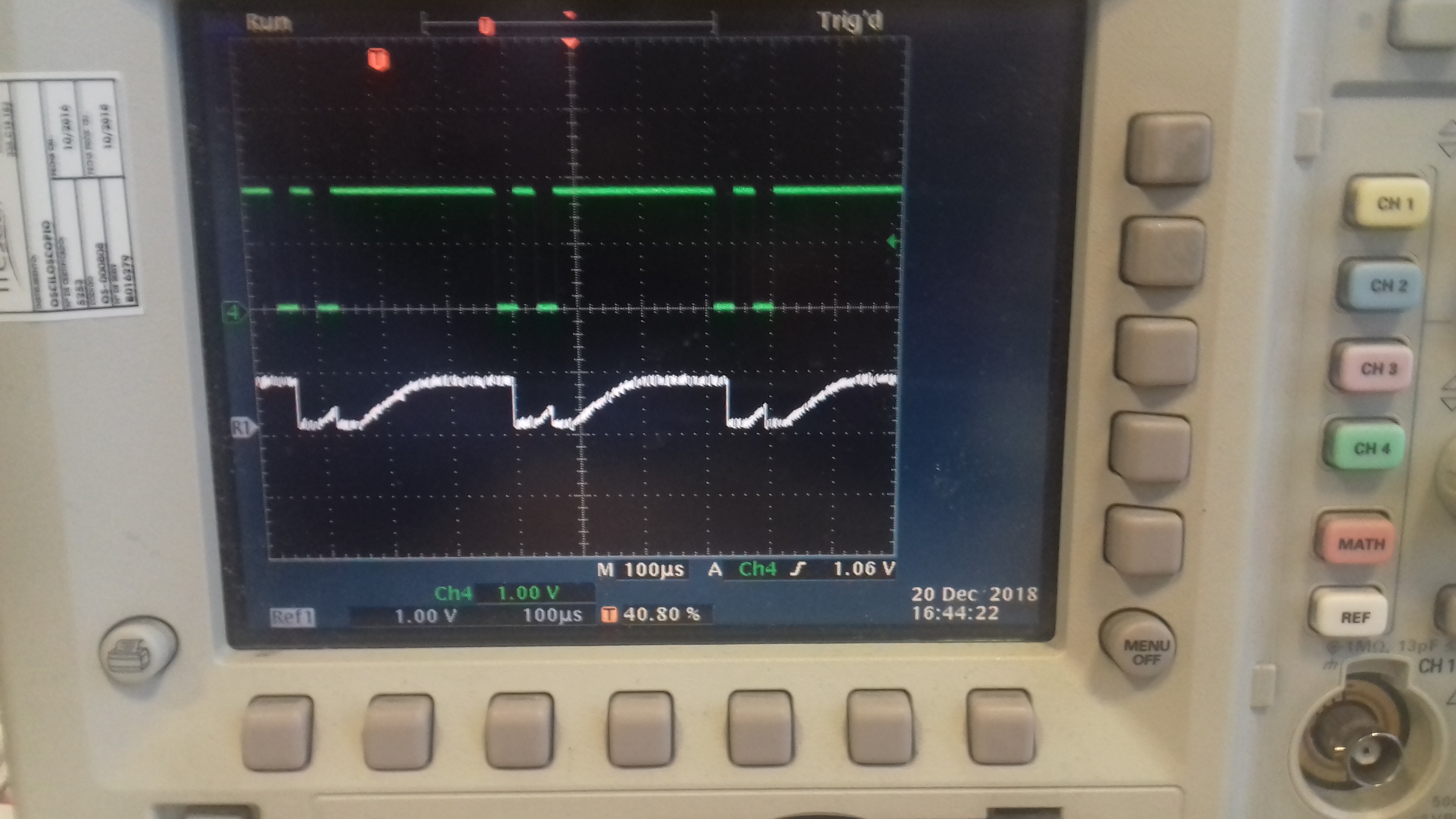

  • Brad,
    I have been testing with the ocillo the row inputs to detect glitches that can cause multiple irqs but it looks like the signals are very stable at high level all the time.
    Billa

    The data manual Pin Attributes table contains a column labeled DSIS that means "de-selected input state".  In other words, if a peripheral is not selected, what will the peirpheral see?  Here's a snippet:
    So for example this shows that for Ball A7 (vin2a_d2), if you have selected some other mode, like Driver Off, the keypad peripheral will see kbd_row6 = 0.
    Could that be our issue?  Do the unused row pins look like they're being held low all the time?  Maybe that's the interrupt flood?
    I'm going to ask some co-workers what they think.  Can you check your design to see what pins kbd_row3-8 are connected to?  Is it possible to try an experiment where you configure all those pins as kbd_row pins (INPUT enabled and pullup on)?

    I don´t know if it has to do with the columms pinmux.
    ---------------------- U-boot Pinmux ----------------------------
    => md 0x4a003554
    4a003554: 00060009 00060009 0004000e 00060009    ................
    4a003564: 0005000e 0005000e 0005000e 0001000a    ................
    4a003574: 00010009 00010009 00010009 00010009    ................
    4a003584: 0005010c 0005010c 0005000e 00010003    ................
    4a003594: 00050003 0001000a 0001010d 0001010d    ................
    4a0035a4: 0001010d 0001010d 0001010d 0005000e    ................
    4a0035b4: 0005000e 0001000a 0005000e 0005000e    ................
    4a0035c4: 0005000e 0004000f 0004000f 0004000f    ................
    4a0035d4: 0004000f 0004000f 0004000f 0004000f    ................
    4a0035e4: 0004000f 0004000f 0004000f 0004000f    ................
    4a0035f4: 0004000f 0004000f 0004000f 0004000f    ................
    4a003604: 0004000f 0004000f 0004000f 0004000f    ................
    4a003614: 0004000f 0004000f 0004000f 0004000f    ................
    4a003624: 0004000f 0004000f 0004000f 0004000f    ................
    4a003634: 0004000f 0004000f 000d0003 00090003    ................
    4a003644: 0004000f 000d0003 000d0003 00050003    ................
    => md 0x4a003574
    4a003654: 00050003 00050003 00050003 00050003    ................
    4a003664:
    ---------------------- Linux Pinmux -----------------------------
    root@am57xx-evm:~#
    root@am57xx-evm:~# devmem2 0x4a003554
    /dev/mem opened.
    Memory mapped at address 0xb6fa1000.
    Read at address  0x4A003554 (0xb6fa1554): 0x00060009
    root@am57xx-evm:~# devmem2 0x4a003558
    /dev/mem opened.
    Memory mapped at address 0xb6f83000.
    Read at address  0x4A003558 (0xb6f83558): 0x00060009
    root@am57xx-evm:~# devmem2 0x4a003560
    /dev/mem opened.
    Memory mapped at address 0xb6f78000.
    Read at address  0x4A003560 (0xb6f78560): 0x00060009
    root@am57xx-evm:~# devmem2 0x4a003574
    /dev/mem opened.
    Memory mapped at address 0xb6f3c000.
    Read at address  0x4A003574 (0xb6f3c574): 0x00010009
    root@am57xx-evm:~# devmem2 0x4a003578
    /dev/mem opened.
    Memory mapped at address 0xb6f5e000.
    Read at address  0x4A003578 (0xb6f5e578): 0x00010009
    root@am57xx-evm:~# devmem2 0x4a00357c
    /dev/mem opened.
    Memory mapped at address 0xb6f8d000.
    Read at address  0x4A00357C (0xb6f8d57c): 0x00010009
    root@am57xx-evm:~# devmem2 0x4a003580
    /dev/mem opened.
    Memory mapped at address 0xb6f65000.
    Read at address  0x4A003580 (0xb6f65580): 0x00010009
    root@am57xx-evm:~#
    root@am57xx-evm:~#

    I have checked your keyboard pinmux and I see that for not used row pins (kbd_row3/4/5/6/7/8) you have Pull disabled in the Control Module registers. And this seems to be in conflict with AM570x TRM section 28.2.3 Protocols and Data Formats, where we have the below note:
    NOTE: When using the keyboard controller with a smaller keypad (for example, 5 × 5), unused rows must be tied high to prevent disturbing the scanning process. Normally, all rows must be pulled up internally at the I/O cells of the device.
    I can suggest you to reconfigure these registers (i.e. CTRL_CORE_PAD_VIN2A_VSYNC0, 0x4A003564) with pull up enable and check if there will be any improvement.
    CTRL_CORE_PAD_VIN2A_VSYNC0[16] VIN2A_VSYNC0_PULLUDENABLE = 0 - Enables weak Pull Up/Down
    CTRL_CORE_PAD_VIN2A_VSYNC0[17] VIN2A_VSYNC0_PULLTYPESELECT = 1 - Pull Up is selected
    Pavel

  • All the the registers from kbd_row3 to kbd_row8 are used for different purposes .
  •  Brad,
    Here attached is a column signal taken with an oscillo from AM5708 output pin.
    The white one corresponds to a pinmux PIN_OUTPUT, that is with pull up/down disabled.
    The green one corresponds to a pinmux PIN_OUTPUT_PULLUP, that is with pull up enabled.
    According to the comments, those col pins should be configured as PIN_OUTPUT, but in our case it only works if they are configured as PIN_OUTPUT_PULLUP.
    Another question, accordingto the oscillo, the scan period of the column is when signal is low level (aprox. 25 useg). Is that period length correct? Is it possible to lengthen it?
    Billa
    Yes.  Rows should be configured as PIN_INPUT_PULLUP and columns should be PIN_OUTPUT.  Can you please provide the devmem2 output for these registers:
    * ROW0: CTRL_CORE_PAD_VIN2A_CLK0, 0x4A00 3554
    * ROW1: CTRL_CORE_PAD_VIN2A_DE0, 0x4A00 3558
    * ROW2: CTRL_CORE_PAD_VIN2A_HSYNC0, 0x4A00 3560
    * COL0: CTRL_CORE_PAD_VIN2A_D3, 0x4A00 3574
    * COL1: CTRL_CORE_PAD_VIN2A_D4, 0x4A00 3578
    * COL2: CTRL_CORE_PAD_VIN2A_D5, 0x4A00 357C
    * COL3: CTRL_CORE_PAD_VIN2A_D6, 0x4A00 3580
    This seems very short.  The KBD controller functional clock is supposed to be 32 kHz, and according to KBD_CTRL we have a prescaler of /256.  So I really would expect things to be much slower, e.g. 8ms.  Can you get a clock tree dump:
    omapconf --force dra72x export ctt am570x-clocks.txt
    Then attach the txt file and I'll rename to *.rd1 on my side.
