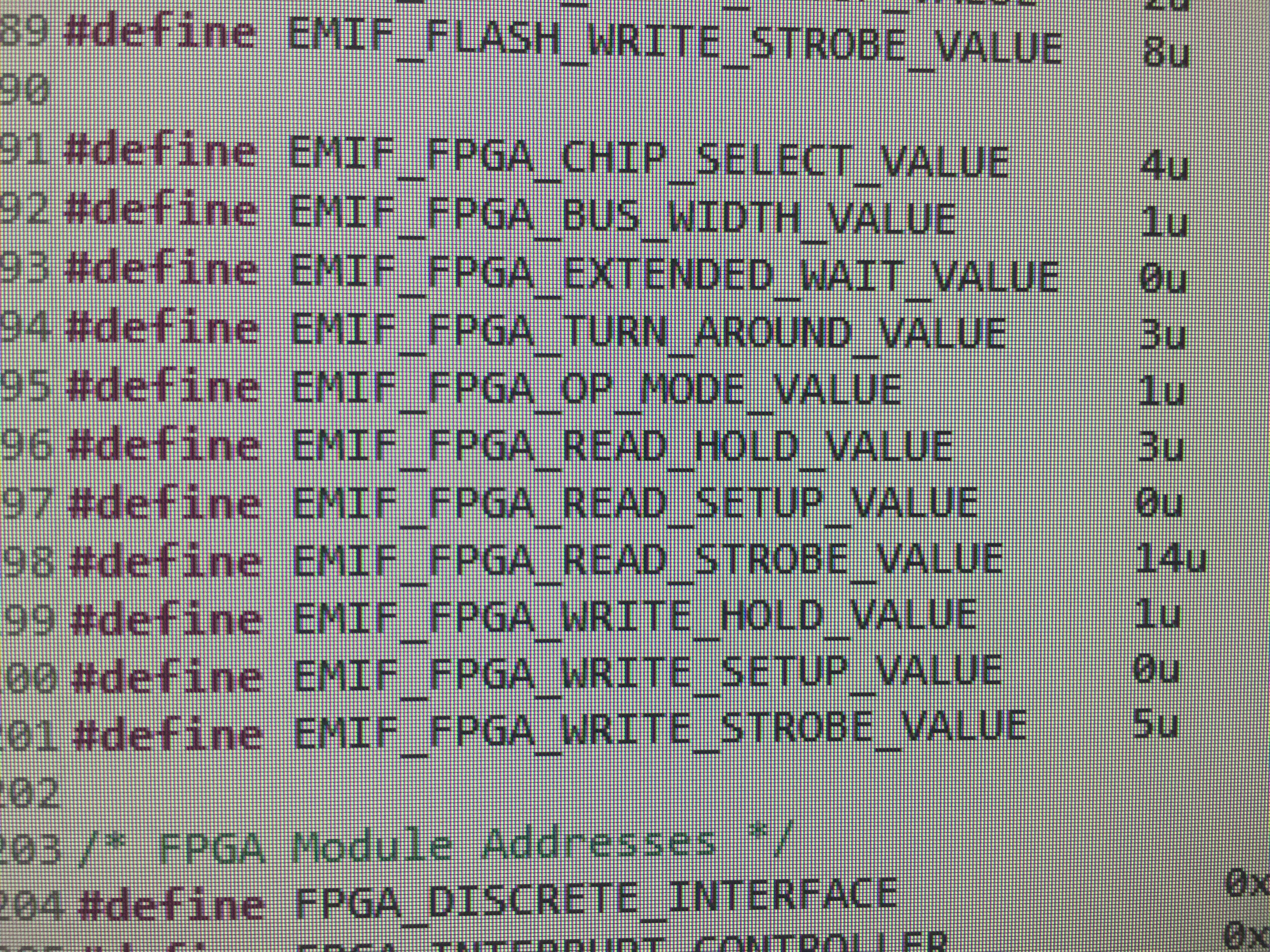

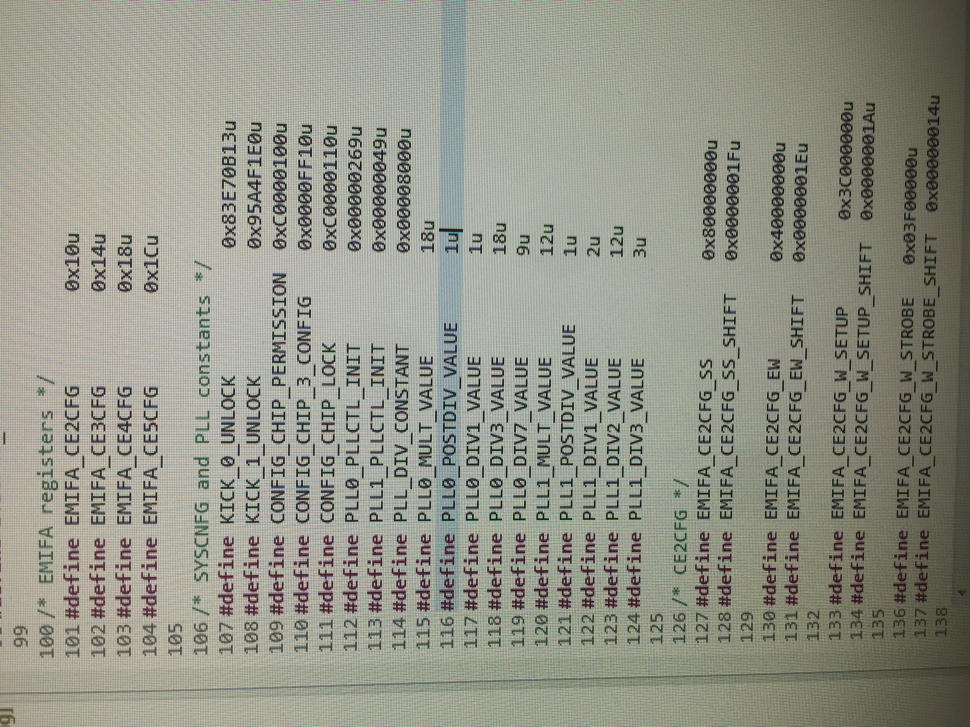

Firstly, we aimed to configure CPU speed as 450 Mhz and EMIF speed as 25 Mhz.
For that purpose, we used below values for FPGA EMIF (EMIFA_CE4CFG register)
In order to to configure CPU speed as 450 Mhz and EMIF speed as 25 Mhz, we set up PLL0 register with below values;

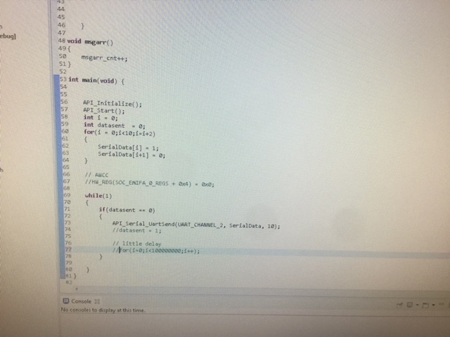

Then we run a simple code which sends 10 bytes (1,0,1,0...). But 1 byte transfer rate was bigger than 800 ns.
We tried different values for "write strobe" and the most efficient transfer rate became 710 ns as shown below Oscilloscope analysis (shown with yellow line).
We did not understand why the transfer rate is so much. We expected much more small transfer rates for data transfer on EMIF bus.

We are using EMIFA asynchronously. We have not tried DMA. You can find the oscilloscope screen below.
Yellow signal is bit 0 and blue signal is write enable. When we change the strobe values blue signal is also changing. Blue signal time length can be as small as one clock but data can not be faster than below.
