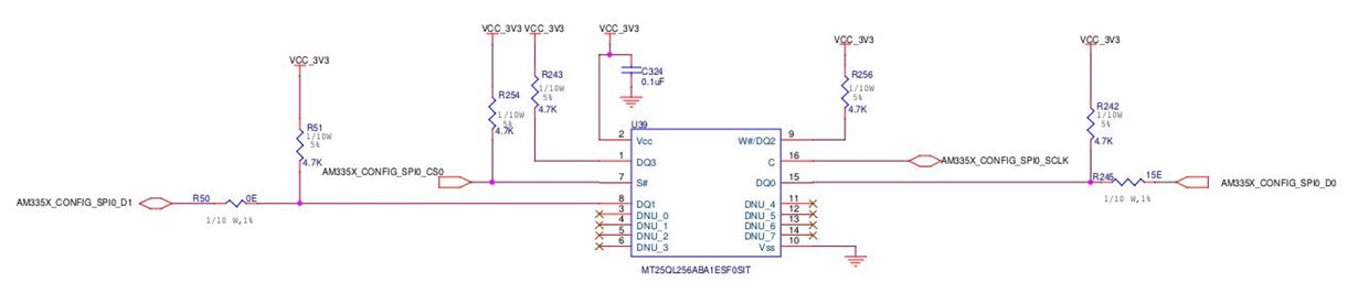

We are working on AM335x processor which is connected to MT25QL256ABA Micron Serial NOR Flash Memory.
We are checking SPI interface between them. Please find Schematic and DTS definitions below.
Note: Our NOR flash is connected to SPI0.
Schematic:
SPI definition in DTS:

  • Hi Vamsi,
    From what I understand you are using AM335x custom board, correct?
    Do you use AM335x PSDK Linux v5.02?
    Pavel
  • Yes Pavel,
    Our custom board is similar to starter kit & SDK we are using is ti-processor-sdk-linux-am335x-evm-05.00.00.15.
    Vamsi
  • Vamsi,
    You are using spi1_d0 and spidev1.0 in your test, but I do not see SPI1 attached to your SPI NOR flash. If I am not missing something, you should remove the reference to spi1 and spidev1.0, as I do not see how this are related to NOR flash.
    Check also below e2e threads:
    e2e.ti.com/.../770985
    e2e.ti.com/.../771421
    Pavel

  • Vamsi,
    In your DTS file, you need to make below update:
    channel@0
    #address-cells = <1>;
    #size-cells = <0>;
    -compatible = "spidev";
    +compatible = "rohm,dh2228fv";
    spi-max-frequency = <48000000>;
    reg = <0x0>;
    In later version of kernels the compatible string was changed from "spidev" to "rohm,dh2228fv". Refer to the below pointers for details:
    software-dl.ti.com/.../Foundational_Components_Kernel_Drivers.html
    linux-4.14.x/drivers/spi/spidev.c
    static const struct of_device_id spidev_dt_ids[] = {
    { .compatible = "rohm,dh2228fv" },
    { .compatible = "lineartechnology,ltc2488" },
    { .compatible = "ge,achc" },
    { .compatible = "semtech,sx1301" },
