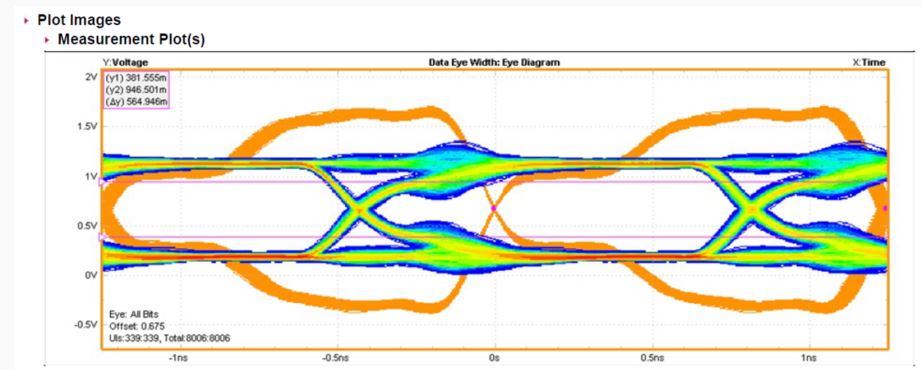

We are currently performing SI tests on a new design where we are using a TI AM3358 ZCZ.
Timing and signal integrity looks a bit strange on the DDR3 Interface
Below is a measurement of a write data eye DQS1 is orange in the back and the colored data eye is D9.
Interface voltage 1.35V
DQS1: Etch Length is 18.2mm, trace is 80 Ohm Diff
D9 : Etch length 19.3mm, trace is 40 Ohm single

  • Interface voltage is 1.35V
    DQS is 80 ohm Diff, length approx. 20mm
    DQ is 40 ohm single ended, length is approx. 20mm
    Are there any known problems or special considerations with the specifications above.
    If I make a simulation of DQS, SI looks fine:
    When I measure, the data write eye doesn’t look too good.
    It actually looks like the PHY driver is too weak.
    I changed ddr_data0/1_ioctrl (io_config_i) to 33Ohm ( 111) with only marginal improvement if SI.
    Write eye with PHY out 33 Ohm looks like below:
    One could argue that if we could get timing better, the weak drive would be less of a problem.
    Any advice or comments on the above observations will be much appreciated.
  • From the eye diagram, the closed left side of both the DQS and DQ eye indicates improper termination. Can you send the GEL that was used to configure the DDR controller and PHY for this test?
    Do you have a length report for all DQS and DQ signals? This will identify possible length matching issues between DQS and DQ
    Also, why is DQS rising to 1.5V and falling below 0V? There may be unwanted reflections on this signal. What is the topology of the DDR? Is it a single 16-bit DDR3 device?

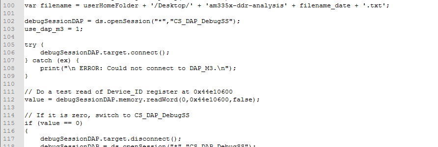

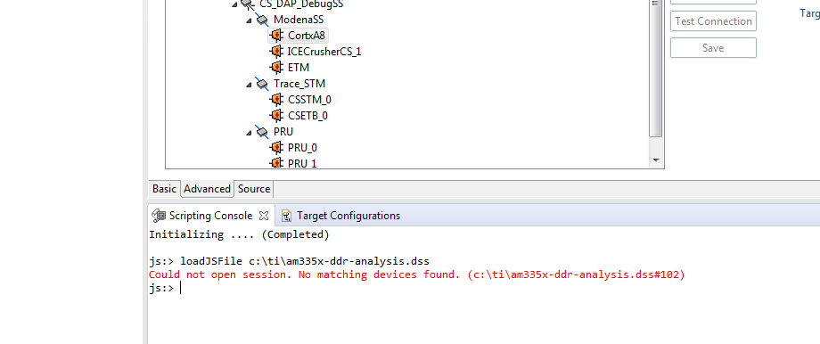

  • I still can’t run the script.
    I do the following
    create the .ccxml,
    select segger and AM2258
    save
    Launch configuration
    I don’t connect
    View – Scripting Console
    c:\ti\am335x-ddr-analysis.dss
    Get a fail #102
    Can you check what is going wrong:
    I have attached  both .DSS and the CMXL file.
    I am pretty sure that I follow the README on GIT.
    RE__[EXTERNAL]_AM3358_DDR3_timing_and_SI_issue. (1).zip
  • Can you try replacing CS_DAP_M3 on line 102 with CS_DAP_DebugSS
    James
  • I just tried, I get the exact same error.
  • The issue is the Segger JTAG unit.  It only supports connection to the Cortex A8 and not the DAP_M3 or the DAP_DebugSS.  I will update the README to clarify on supported JTAG units.
    I recommend buying a XDS110 (US $99):
    http://www.ti.com/tool/TMDSEMU110-U
    It will support connections to all the underlying cores which will allow all of the debug scripts to be usable.

  • Referring to the eye diagram is the at the bottom.
     The multicolored signal is the data bit, and the single color orange, is the DQS.
     The Tektronix DDRA option represents the DQS with higher amplitude.
     It is a bit misleading I agree.
     Here is a snip from a different design that works fine.
     I am pretty sure that what we see on the current design is severe undershoot.

  • I had a webex and was able to get the script working.  Linux was booting on the board and disabling the debug clock.  From Linux console we executed the following to turn it back on:
    devmem2 0x44e00414 w 0x12500002
    After that, the script was able to run.
