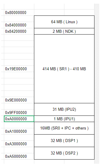

Our system does not have enough shared memory to do more algorithm,
So we want to adjust the memory block position & size for increasing the SR1 size.
After reading the URL http://processors.wiki.ti.com/index.php/VSDK/VisionSDK_UserGuide_MemoryMap#Memory_Map_of_the_Application, our adjustments are still fail.
Even we only move the IPU1 & IPU2 position & size. ( not out of 0xA0000000 )
Could you help us ?
Thank you very much.

  • Hi Eten,
    If you don't intend M4 to perform a CPU access and all operations happen using DMA, you can add a carveout between 0xA0000000 - 0xC0000000 and use this as shared memory (refer the dra7-evm-infoadas.dts in kernel on how to add a reserved memory node).
    You then need to add the corresponding entry OSA_memInit to mmap this reserved region to userspace.
