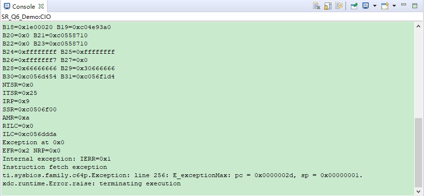

The customer transplanted demo USB_DEV_MSC in PDK into his own application prj. USB_DEV_MSC and his project have been independently tested successfully independently. And the integrated project can be built successfully. But when load to board error occurred as below:

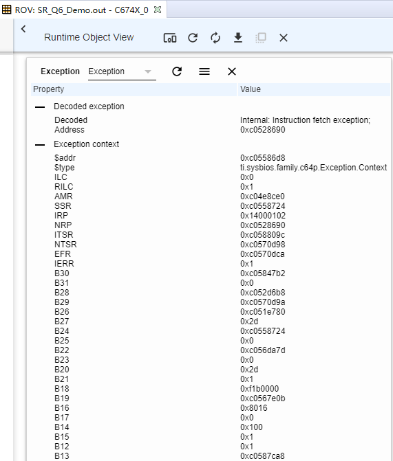

He monitor that exception error by ROV. This is screenshort.
Could you please help analyze from ROV screenshot?
Your SP=0x1, is possible that you code running out of the stack? Increasing the stack size may help:
Program.stack = xxxxx;
See: RTOS/TMDXLCDK6748: Internal exception: IERR=0x1 Instruction fetch exception ti.sysbios.family.c64p.Exception...
https://e2e.ti.com/support/tools/ccs/f/81/t/108133
Regards, Eric

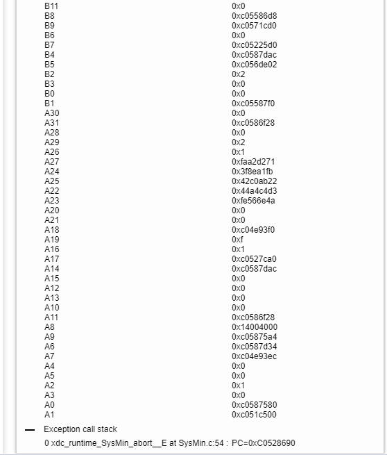

Thanks! At least PC, SP and B3 all looked invalid. Are they able to step through the code to see where it crashed?
Regards, Eric
