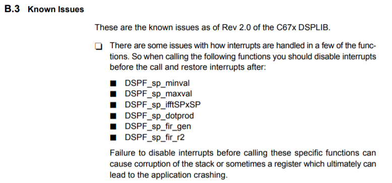

Hello Egor,
Referring to the TMS320C67x DSP Library Programmer's Reference Guide, there is a known issue with how interrupts are handled when calling DSPF_sp_fir_r2 which can lead to the application crashing.
So can you try the suggested workaround of disabling interrupts before the call and restoring them after?
