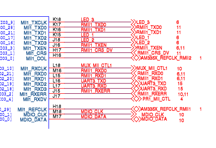

I have the IceV2 example working and I can ping the board; however, the TLK110 is connected to the PRU (I believe for Ecat reason). The BBblack connects a different chip to the MAC port. Has anyone done a board with TLK110 on the MAC port and got it to work with NDK? LWIP work, but I would like to switch to NDK. Any help would be great!

    I think I may have not been clear enough. I have looked at the schematic and what I'm looking at is the TLK110 are connected to the PRUs. In our boards the two PRU are used for Ecat using the TLK110 and the MMII1 port is connected to a TLK110 for Ethernet. From what I can tell there are no examples that use the TLK110 connected to the MII1 connects (beyond LWIP), however, I could be wrong? And if I want to create a HW link to NDK I need to use the Ethernet Mini-Drive guide to create that link - am I missing something, I hope so?

    Yes, I understand that; however, the MII1 is not PR1_MII0 or PR1_MMI1. MII1 is separate and apart from it (referring to part 2 of the schematic starting at pin K18 down). I do see that some of the line are connected to U3, but not all of the (TX0-3 & RX0-3, for example). For instants, I do see PR1_MII0RX1 is connect to RMII1_RX1. The other pins are tied to other functions, like LED3 verses MII1_CLK. missing something??

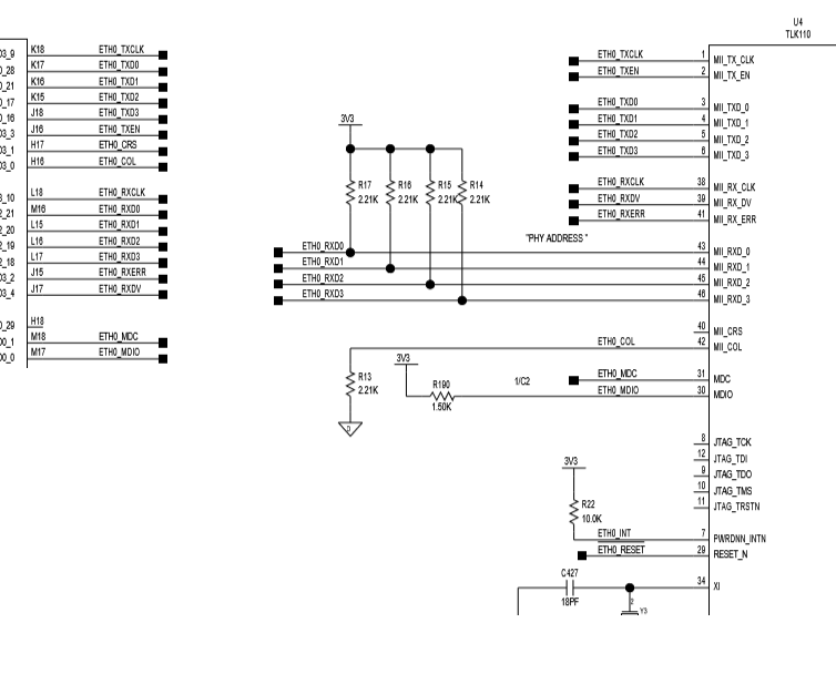

  • HI again here a schem. that work fine with Lwip, just liking to move to NDK.

    CPSW ports are configured to RMII (two transmit/receive data bits) while the PRU ports are configured to MII (four transmit/receive bit), so the pins/signals connecting to PHY U3 varies.

  • I'm finally getting back to this... I can now build the board lib files.. I can read the Beaglebone black ID register with no issues. I am trying to read the ID register from my board that is using TLK110 and I get 0. It seem the MII register in the arm are set correctly. I believe the configuration and address for the two phys, to at least, get this info should be the same? is there a different I'm missing?
    I call this function below inside the board lib "ENETPHY_Init". I get the right info from BBB and 0 from my board.
    CSL_MDIO_phyRegRead(miibase,PhyAddr,ENETPHY_ID2,(uint16_t *) &phy);
      ENET_PHY_log("ID reg data with CSL read = %x\n",(int) phy);
    Rob
  • Problem solve -  Ican now configure the phy! Now I need to get the ping up and running
