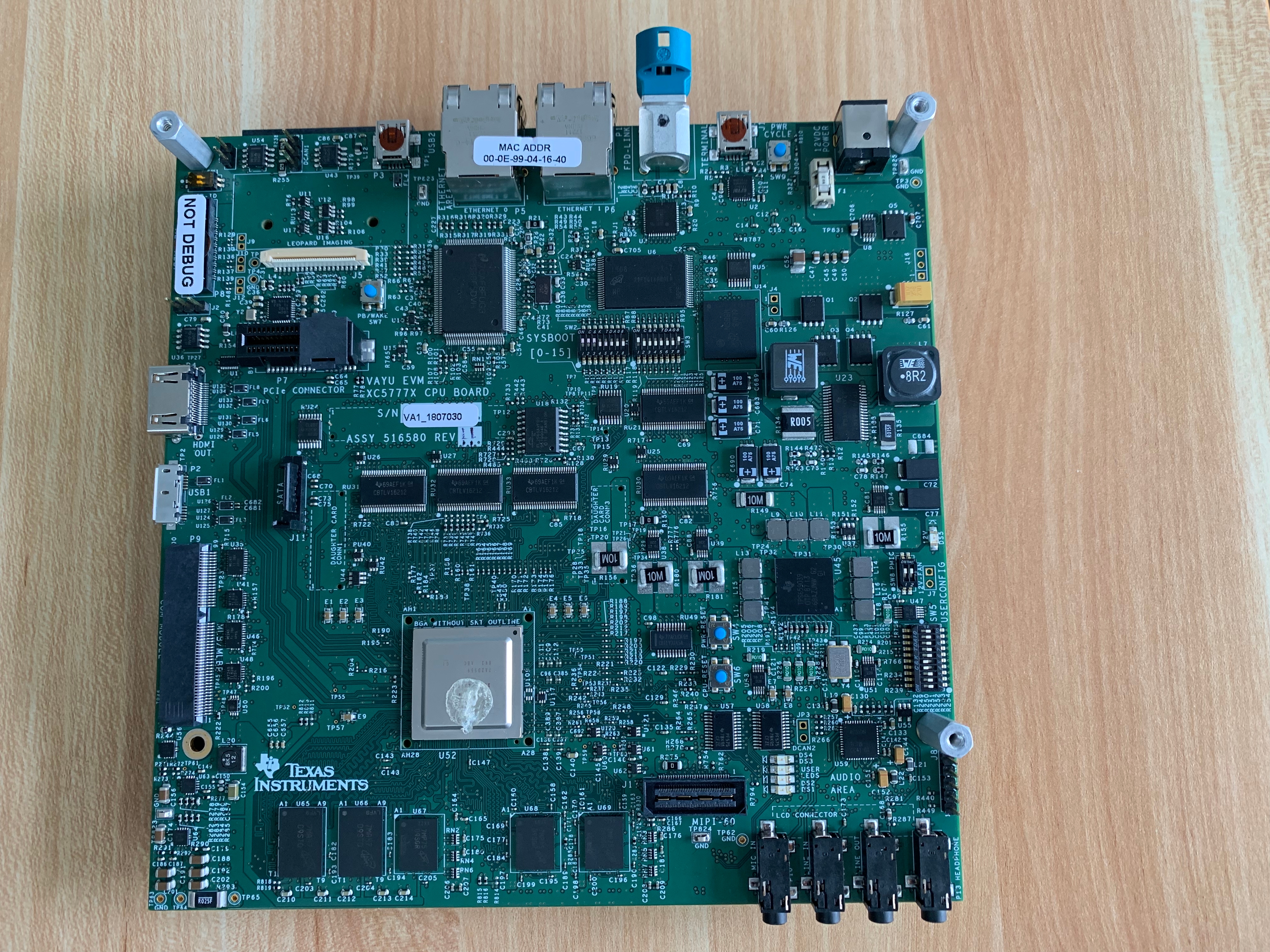

TDA2EVM5777: Modify 512MB Bios Memory map to 1GB Bios Memory map
Part Number: TDA2EVM5777
I follow the VisionSDK_UserGuide_MemoryMap.pdf try to Modify 512MB Bios Memory map to 1GB Bios Memory map. My evm board is VAYU EVM XC5777X , my vision SDK version is PROCESSOR_SDK_VISION_03_07_00_00_setuplinux.
I rebuild the Appimage and MLO and update to sd card.But it cannot boot up.Here's the boot log.
 TDA2xx SBL Boot
 DPLL Configuration Completed
 Clock Domain Configuration Completed
 Module Enable Configuration Completed
 TI EVM PAD Config Completed
 DDR Config Completed
 App Image Download Begins
 SD Boot - file open completed successfully
 MPU CPU0 Image Load Completed
 IPU1 CPU0 Image Load Completed
 IPU1 CPU1 Image Load Completed
 IPU2 CPU0 and CPU1 Image Load Completed
 DSP1 Image Load Completed
 DSP2 Image Load Completed
 EVE1 Image Load Completed
 EVE2 Image Load Completed
 EVE3 Image Load Completed
 EVE4 Image Load Completed
 App Image Download Completed
 Putting MPU CPU1 in Off mode
 EVE MMU configuration completed
 PMCCNTR counts once every 64 clock cycles, multiple by 64 to get actual CPU cycles
 SBL Initial Config Cycles - 144545  (12.33 ms)
 SOC Init Cycles - 170703  (14.56 ms)
 DDR Config Clock Cycles - 43425  (3.70 ms)
 App Image Load Cycles - 50179923  (4282.2 ms)
 Slave Core Bootup Cycles - 208031  (17.75 ms)
 SBL Boot-up Cycles - 50747687  (4330.46 ms)
 Time at which SBL started IPU1_0 - 150587  (4595.55 ms)
 Jumping to MPU CPU0 App
It just stop here.............
