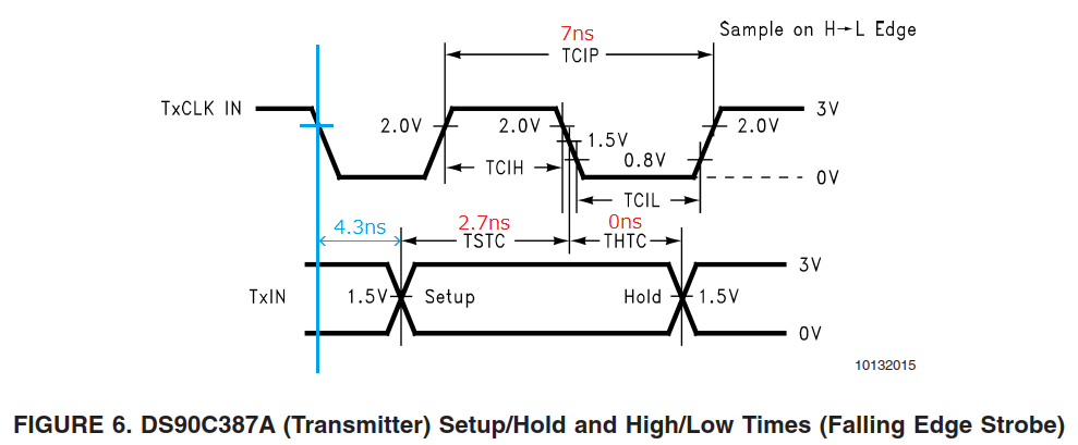

Our customer wants to connect AM5728 (VOUT2) to DS90C387A (Single-to-dual) with 144MHz PCLK, but it does not seem possible.
For DS90C387A, the setup time and hold time are as follows.
 - TxIN Setup to TxCLK IN (TSTC): 2.7ns
 - TxIN Hold to TxCLK IN (THTC): 0ns
For AM5728 (VOUT2), the delay time of each Manual IO Timings Modes that supports 144MHz PCLK is as follows.
 - MANUAL1 (Alternate): 1.51ns (MIN) - 4.55ns (MAX)
 - MANUAL3: 2.78ns (MIN) - 5.91ns (MAX)
 - MANUAL4: 3.55ns (MIN) - 6.61ns (MAX)
To meet the setup time of DS90C387A, the maximum delay time must be less than 4.3ns, but AM5728 (VOUT2) does not meet it.
Can you tell me how to connect AM5728 (VOUT2) to DS90C387A with 144MHz PCLK?

    The MANUAL2 (Default) Timings mode does not support 144MHz (< 7ns) PCLK because the minimum cycle time for output pixel clock is 11.76ns.

    There is sufficient margin at a PCLK of 144MHz to interface these devices.  However, the clock must be delayed to meet the set-up and hold requirements.  You can use the dielectric constant of your PCB material to calculate the signal propagation delay.  You will need to length-match the data and control signals.  Then you can add extra track length to the clock to delay it.  You can use the Alternate Switching Characteristics if you add 1ns of delay to the clock signal.  Assuming standard FR4 PCB material, this will be about 6 inches of copper track added to the clock signal relative to the matched length of the data and control signals.
    Stripline signal propagation delay (in picoseconds per inch) = 84.6*SQRT(Dk)
    For standard FR4 material with a Dk=4, the stripline signal propagation delay is 170ps/in
    Microstrip routes are faster and have a signal propagation delay = 84.6*SQRT(0.475*Dk+0.67)
    For standard FR4 material with a Dk=4, the microstrip signal propagation delay is 135ps/in
    You may also need to account for signal propagation delay through vias if the number of vias per route vary or the via barrel length varies significantly.  Most PCB layout packages can calculate accurate signal propagation delays to simplify this process.
    Another solution is implementation of a zero-delay clock buffer.  Many of these buffers have configurable delay options that can be controlled by selection of a load capacitor.
