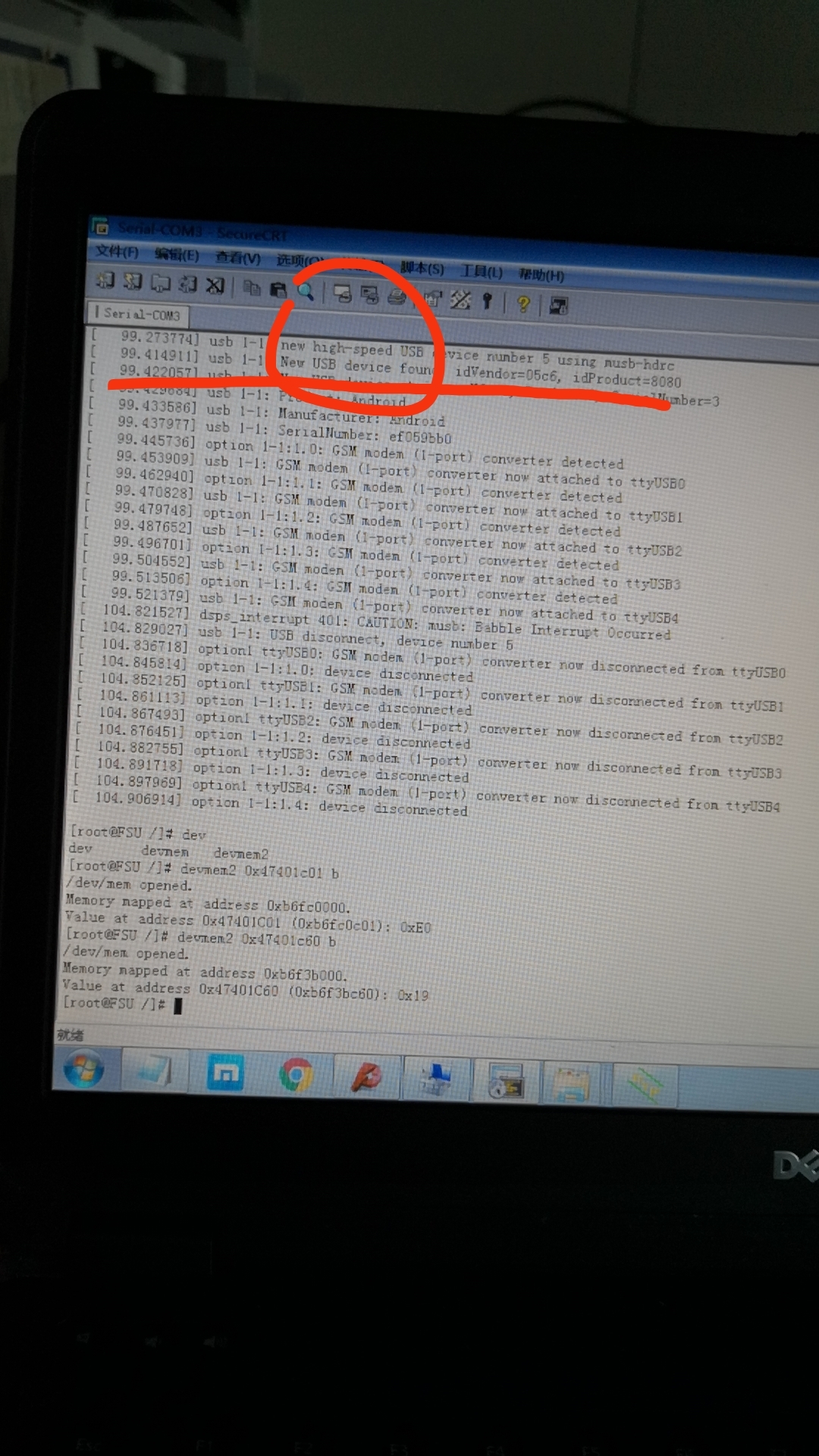

    However, after running for a period of time, the 4G modem's network is disconnected, check the cause, and find the USB printing information prompt error of the kernel, as follows:
Prompt "Babble Interrupt Occurred usb1-1: USB disconnect, device number 2" error messages, and it can not be restored to normal, only restart the product.

  • When you forced USB1 in full-speed, the log above shows babble condition happened, and the musb driver restarted, but the 4G modem is not enumerated after musb restarted.
    Can you please run the following command on the Linux console to dump some registers? Please do so after babble happened and Linux is at the point as shown in your screenshot above.
    # devmem2 0x47401c01 b
    # devmem2 0x47401c60 b

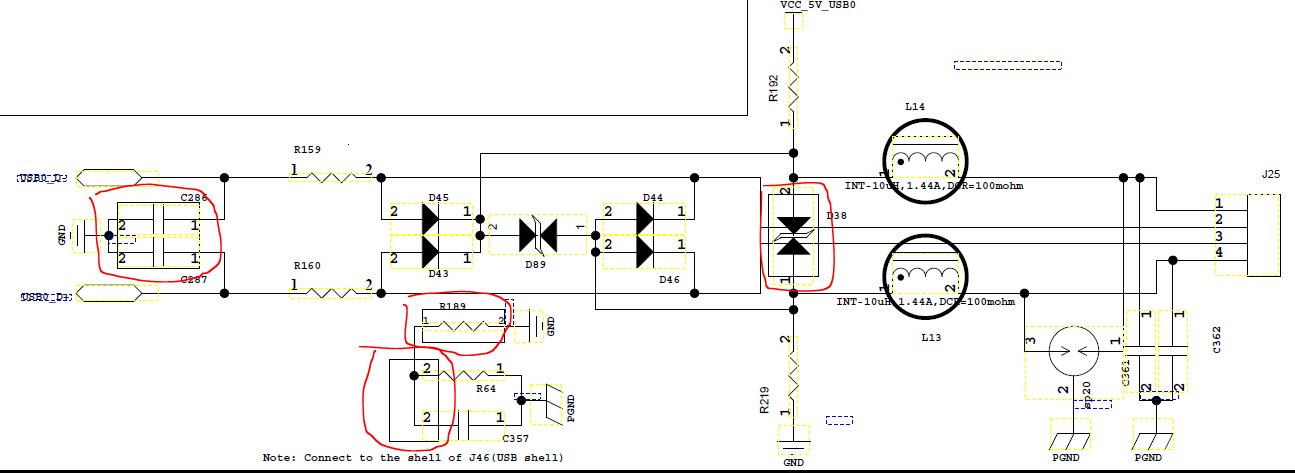

    Please also share the USB portion of your board schematics.
    0xE0.
    0x19.
    Replace R159 and R160 with 0ohm resistor, same result.

    The register dumps TienSen posted above shows the USB controller is no longer in host mode in the failure cases.
    Where is this 'VCC_5V_USB0' signal connected to in the schematics screenshot you posted above? Please post the whole USB0 portion of the schematics, including all the connections of AM335x USB0 pins to the USB type-A receptacle.

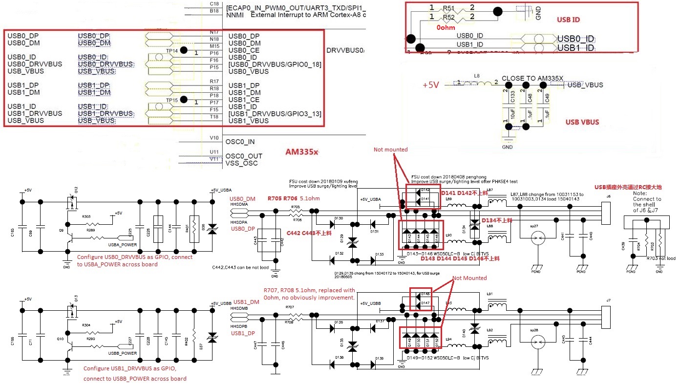

    As USB signal across boards, some net name is not same, I marked it in the schematic.
    Customer said when failure happen:
    USB0/1_DRVVBUS:
    usb@47401000: host, okay
    usb@47401800: host, okay
    And +5V_USB is active.

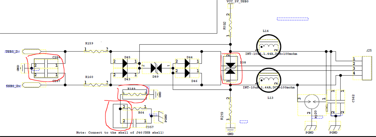

  • Hi Tony,
    Thanks for the screenshot of the schematics.
    The comment in the schematics shows USBx_DRVVBUS is used to control the VBUS power, but the pin is configured as a GPIO. Is there any reason why this pin mode is modified?
    If this pin is in default DRVVBUS mode, the MUSB controller would control it automatically without any software involved, and many timing issues could be avoided.

    The pin is set to the default DRVVBUS mode, and there is still a problem of BABBLE;It is the same phenomenon that pin is configured as GPIO mode.

  • Hi TianSen,
    All we do here in software will not eliminate or reduce babble condition, which has something to do with hw design. The issue we are trying to understand now is why the MUSB controller doesn't enumerate the 4G modem after the babble recovery, the controller is actually in device mode as shown by the register dump provided earlier in this thread.
    Based on the description in the TRM, for MUSB to transition to host mode, USB1_VBUS pin has to be low first, then the software tells the MUSB controller to assert USB1_DRVVBUS pin to turn on VBUS, and VBUS has to raise to VBUS_VALID threshold (4.4v) within 100ms.
    So please use a scope to measure USB1_DRVVBUS and USB1_VBUS pins after babble happens. USB1_DRVVBUS should go low after babble happened, then go high, and USB1_VBUS should be high within 100ms.
