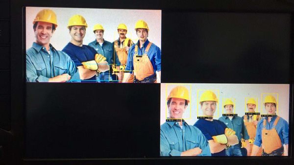

Hi:

   and I change the "keep_top_k: 200" to "keep_top_k:20" in the deploy.prototxt.But the model converted runs very poor at objection detetion.And this caffemodel has a good performrnce on the PC,here is the contrast:
 SO my first Question is why could be this?
AND there is another question that when i convert caffemodel using “/...../sparse/ti-helmet-detection_ssdJacintoNetV2_iter_120000.caffemodel" ,  but the model converted runs very slow  on TDA2x platform,it caused black screen and
i even couldn't load cpu info or print performance statistics.Obviously EVE didn't call.

  • Hi Wang,

  • Hi Praveen,
    I think i solved last question.I reset 'rawSampleInData = 0',and Output 'markedBoxes.ppm' is right now.
    But i still wonder why does this work?
    And the converted model can't work on TDA2x,so shold i change some paras?
    Thank you,
    Wang

    Alright,i made a mistake,i forgot to Modifiy 512*256 to 512*512.Now i got the output like below
    So,is this means sparse process wrong?Here attached runl.og from sparse.run.log
    Wang
