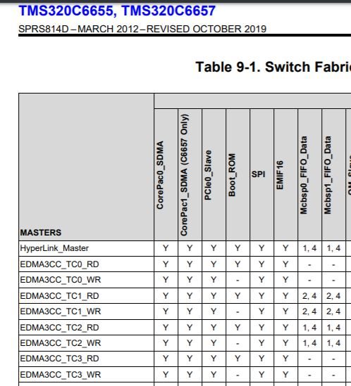

My customer is debugging C6657 MCBSP EDMA.
When edma init, he set 36/37/38/39 event to Q0/1/2/3. But Q0 and Q3 not working.
So customer set 36/37 to Q1 and 38/39 to Q2, it can work.
Customer want to know the reason? And how to check who used the Q0 and Q3.

Hi Yordan,
Customer don't use RTOS, they used they own bare-metal software.
Please help this from hardware aspect, Are there any limited for EDMA usage?

Denny,
I thought this is answered by Mukul already. Also, the C6657 only has one EDMA CC, it has four TCs. I saw the code used "gpEDMA_CC2_regs->TPCC_DMAQNUM[4]". Please make sure that gpEDMA_CC2_regs points to EDMA base address 0x2740000.
