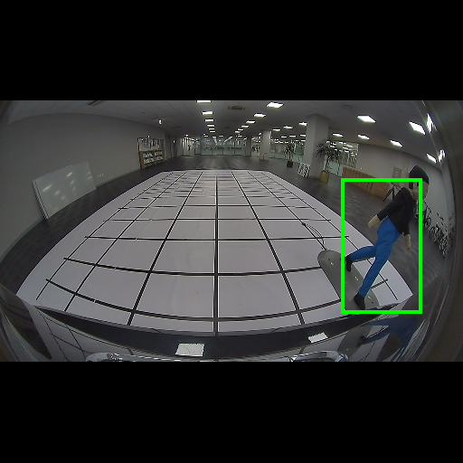

But when we are trying to run the same model trained on "Padded input data" we are facing the huge mismatch in PC and target side results.
I have attached PC and target board output below for comparison:
PC
Target
Please find the import and inference config files attached:

    Can you answer the following questions which will help me understand the problem better?
    1. When you say PC results, are these generated by the training framework, or TIDL host emulation?
    2. Did you retrain your network use padded inputs?
    3. Is the resolution same between training, inference, PC run and target run?
    - Subhajit
  • Hi Subhajit,
    Please find answers in square brackets.
    1. When you say PC results, are these generated by the training framework, or TIDL host emulation? [Training Framework]
    2. Did you retrain your network use padded inputs?[Yes]
    3. Is the resolution same between training, inference, PC run and target run?[Yes]
    Sankalp
  • Sankalp Kallakuri,
    TIDL does not guarantee that the results will match will match the results obtained from training framework due to quantization.
    Can you send the console output of the import process and the layersminmax file?
    - Subhajit

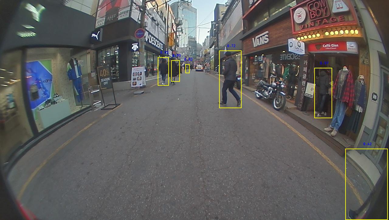

  • Dear Sir,
    We have experimented with L1 Regularized model and facing the similar FP's on the detection, Please find for your reference:
    Parameters used while importing:
    Confidence threshold: 0.3
    numparambits =12
    numfeaturebits = 12
    quantizationstyle = 2
    Kindly help us to resolve the issue.
    Thanks and Regards,
    Vyom Mishra
  • Dear Sir,
    We have experimented with the configuration as below:
    numparambits =8
    numfeaturebits =8
    quantizationstyle =3
    above parameters were giving good results for the un-padded model.
    While experimenting with the same parameters for the L1 Regularized padded model we observed
    a) No FP's
    b) Missed detections
    c) very low scores for True Positives
    ** Detected bounding boxes score were matching the PC scores when parameters were numparambits = numfeaturebits =12
    I am sharing you some results please find it for your reference:
    Kindly do the needful.

    a) The double-digit difference is observed between "meanOrigFloat" and " orgmax"
    b) Layer ID: (Having difference >5) :4,6,10,12,14,16,18,20 are Depth Wise convolution
    As per the observations Depthwise Convolution has the maximum Quantization loss.
    2)
    Configuration:
    model: L1 Regularized trained on Padded Input data

  • Refer below page for debugging accuracy mismatch issues.
    Comparing the input tensor to TIDL with Reference
    • It is important to match the input tensor to TIDL net with the input tesnor of network which was trained.
    • Save the input tensor from the training code that you are using in float format.
    • Use writeTraceLevel = 3 to write the layer level traces from the TIDL to files.
    • By default the data normalizing batchNorm layer is merged to following convolution layer. So set foldPreBnConv2D = 0 to avoid this.
    • Compare the output of this batchNorm layer with input tensor from training code. Refer Link
    http://software-dl.ti.com/jacinto7/esd/processor-sdk-rtos-jacinto7/latest/exports/docs/tidl_j7_01_01_00_10/ti_dl/docs/user_guide_html/md_tidl_fsg_steps_to_debug_mismatch.html

  • Hi Kumar,
    We have seen improvement in the results after the suggestions made by you. We are however still facing some cases where some the Caffe output is not matching with the import tool output.
    I have attached a few images to show this phenomenon. What worries us is that the score of the detection is quite high for the detection on Caffe side but the detection is completely missed in the import tool side.
    I will email few of the images to Karthik. The output of import tool and PC[Caffe] are stitched together the input images have been sent separately.
    Sankalp Kallakuri
  • Hi Sankalp,
    I have tried with the images that you have shared.
    16-bit results are matching with the expected output, but the 8-bit mode is missing a few detections as you observed.
    Could you please quantify the overall accuracy drop with the 8-bit mode?
    The 16-bit inference runtime would be considerably higher compared to 8-bit.
    we would recommend using quantization aware training (QAT) to get the best results in 8-bit mode. Please refer below link for more information on the same.
    https://github.com/TexasInstruments/jacinto-ai-devkit
    Note : This dev-kit is for PyTorch. You may not be able to use it for current model immediately.
    We are also working on improving the import tool to improve the calibration for 8-bit mode. This will be available around 3Q this year.
    So, we would recommend using 8-bit mode for now and use to QAT / improved calibration for 8-bit mode later
    Kumar.D

    Kindly suggest what can be done from our side.
    Thanks &Regards
    Sithara Tresa Chacko
  • Sithara ,
    We have recently fixed a bug in 16-bit flow object detection layer and we are not observing this multiple detections now.
    This bug fix is not part of 6.2 SDK release.
    We will update you on the TIDL patch release date for this soon (After aligning internally). BTW, 16-bit mode is not fully optimized will have performance impact
    Could you quantify the accuracy degradation with 8-bit mode?
  • Dear Kumar,
    For now we feel the speed drop is ok for our current model with 16 bit. But the FPs which are appearing are less tolerable.
    Keeping this in mind until you provide the new SDK we will  stick to 8 bit.
    We will try and give you numbers for accuracy on the 8 bit mode too.
    Sankalp
  • Dear Sir,
    Thankyou for the suggestion to set flip =false.
    The new model with Flip=False gives better results compared to the previous model. We had observed precision of 93.23571 .
    Still in some cases, we observed localization issue.
    Can we improve the model .Please suggest.
    Thanks & Regards
  • Hi Sithara,
    Can you share the precision difference between the TIDL inference and caffe PC inference
    We have observed,
    Caffe PC  side:
    Precision:92.44 and Recall:76.65
    TIDL inference side:
    Precision :93.23 and Recall:68.66
    Thanks &Regards
  • We hope the issue is solved with the patch release shared with you.
