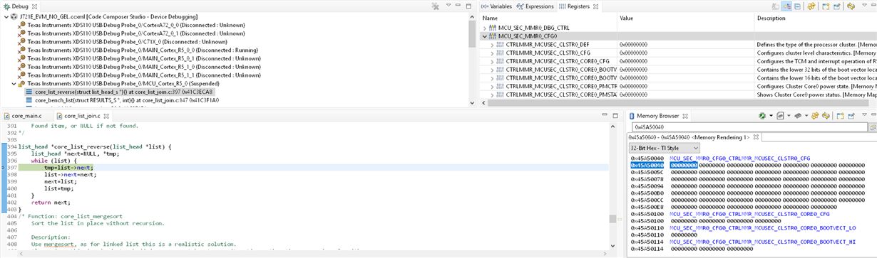

I have a few questions regarding the lockstep for R5F using u-boot.
I am using the 06_02 SDK version.
In the k3-j721e-mcu-wakeup.dtsi file the lockstep for MCU R5F is enabled, but the R5F boots without the lockstep.
I attached the screenshot from the CCS debugger with the CTRLMMR_MCUSEC_CLSTR0_CFG register settings.
According to the data from the register the CPU lockstep bahaviour is disabled and the LOCKSTEP is turned off.
How can we enable the lockstep for the MCU R5F cores using u-boot?
How can we enable the lockstep for the MAIN R5F cores using u-boot? Does enabling the lockstep in k3-j721e-main.dtsi file is enough to enable the lockstep?
  • Hi Adam,
    I believe you are loading the mcu r5f firmware at the R5 SPL level. Then in that case the default efuse values are used.
    That can be either in split mode or lockstep based on the samples.
    Now if you load the firmware and boot the r5fs in u-boot or linux then the DT property takes effect and you
    can boot any of the r5fss in either lockstep-mode or split-mode based on the DT property.
    So if you want to start/load any of the r5fs in the lockstep-mode advice you to load the firmware and start them from u-boot
    instead of R5 SPL.

    I will also repeat my question.
    Is the way we are booting the R5F cores the one that uses the configuration from the device tree?
  • Hi Adam,
    R5 SPL is doing 2 things:
    1) Loads main_r5fss0_core0 firmware and starts it in split mode as the DT has lockstep-mode = <0> in arch/arm/dts/k3-j721e-main.dtsi.
    Hence you see the message in your boot log:
    Remoteproc 2 started successfully.
    Remoteproc 2 for r5 is the main_r5fss0_core0  if you see the arch/arm/dts/k3-j721e-r5-common-proc-board.dts:
    aliases {
    remoteproc0 = &sysctrler;
    remoteproc1 = &a72_0;
    remoteproc2 = &main_r5fss0_core0;
    remoteproc3 = &main_r5fss0_core1;
    So main_r5fss0 is booted in split mode as per the DT configuration.
    Please check:
    http://www.ti.com/lit/pdf/spruil1
    CTRLMMR_SEC_CLSTR0_CFG Register Address: 0x45A40040
    bit 3: lockstep_en if its set then lockstep mode is supported on the device.
    You could try to change arch/arm/dts/k3-j721e-main.dtsi:
    main_r5fss0: r5fss@5c00000 {
    compatible = "ti,j721e-r5fss";

    I checked the CTRLMMR_SEC_CLSTR0_CFG Register and the lockstep for the MAIN R5F is also not enabled.
    I'm attaching the screenshot:
    Does this mean that even if i enable the lockstep for MAIN R5F in  arch/arm/dts/k3-j721e-main.dtsi it won't work?
    Or if i enable the lockstep in the device tree the MAIN R5F should boot in a lockstep mode?
    Kind regards,
    Adam
  • Hi Adam,
    As replied earlier only of the LOCKSTEP_EN is enabled on your device it can be supported.
    lockstep_en = !!(stat & PROC_BOOT_STATUS_FLAG_R5_LOCKSTEP_PERMITTED);
    if (!lockstep_en && cluster->mode) {
    dev_err(cluster->dev, "lockstep mode not permitted, force configuring for split-mode\n");
    cluster->mode = 0;
    The above code in Linux clearly checks that and supports only split-mode if lockstep_en is not set.
    So for your case this will not be supported.
