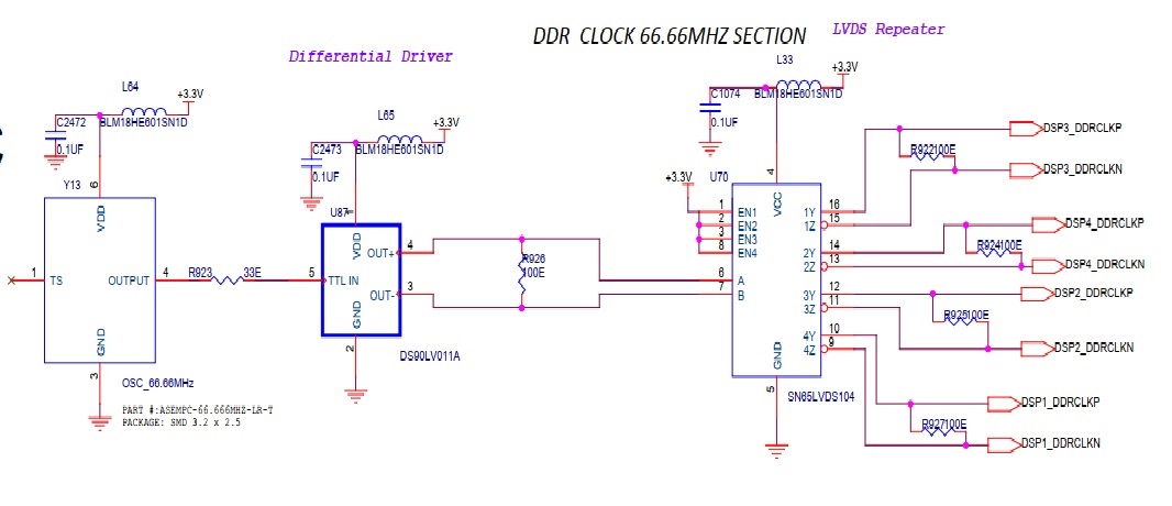

    If any hardware problem to this DSP3, like power and clock jitter?
    Same Power and (core,pa,ddr) clock from clock driver is driven by all the DSP's on board . Out of which DSP3 alone is showing crash.
    Today, we tune DDR PLL to work at lesser clock 400MHz instead of 666.6 MHz and helloworld application seems to work for prolonged time.
    And i guess thats the reason when i set PLL flag to 1, helloworld worked without crash.
    If clock jitter is issue, then it should affect all the DSP's on the board.Why DSP3 alone.
    Can you provide your suggestion on this,
    I'm from the software side and you may provide details how the clock are generated to each SOC for our hardware people to look at. You can also comment if issue happened on one board or multiple boards.
    Regards, Eric
  • HI,
    This is happening in all of our production boards. We are using 4 CDCM6208  clock generator to generate Core/Pass clock, SRIO clock, Pcie Clock, MCM clock. Below is our DDR Clock section.
    Please share your observation,
    I will let the hardware expert to comment the DDR clock portion.
    You mentioned that when code moved from DDR to MSMC, it also crashed. The MSMC is clocked from core PLL (CLK/2), not DDR PLL. So there still something disconnected. Is any clock issue to SOC3 core PLL?
    Do you have a comparison of the IBL PLL code and EVM_init() with pllflag = 1 code, if they do the same thing?
    Regards, Eric

    Voltage and clock measured are the same in all the 10 Boards.
  • We have configured the Core to 1GHz and sysclk measures 166.6MHz.
    Both the PLL code is the same in IBL and evm_init.
    The clock source is common for all the DSP's. We doubt how one DSP is not able to work properly when other DSP's are able to work perfectly.
    As you have 10 boards and all have DSP3 failure running the same code, it is a hardware issue rather than software.
    Are you able to isolate this is only a DDR PLL issue? You indicated that reducing the DDR clock speed helped. I would suggest you totally disable the DDR initialization during this test for DSP3, and look at the application memory map to make sure nothing is placed into DDR3, and to see if the test crash or not.
    Next, scope captures of the clocks into a good and bad DSP also help to see if any clock distribution issue into DSP3. Also, a capture of the CORECLKOUT to verify that clock PLL programmed correctly.
    Regards, Eric
  • Hi Eric,
    As you suggested, we checked the clocks around DSP3 with the one working. DSP3 clocks seem good and we dint find any voltage drop during the failure case.
    Since the other DSP's are working fine from the same source input, we are not able to narrow down the cause for DSP3 failure.
    what could be the reason for DSP3 DDR instability to work at 666.6 MHz.
    Could you suggest on this,
  • Vidya,
    Have you proven that the failure is related to DDR on DSP3?  Eric mentioned that you moved the code to MSMC and it still failed.  Can you re-run this test where you also skip the DDR initialization to prove that your application is absolutely not using DDR?  If we can prove that the intermittent fault is due to the DDR implementation, that is a different path for debug.
    Tom
  • Tom,
    we are able to run a simple application without crashing when using MSMCRAM excluding DDR memory.
    Our actual application requires huge memory as it tests all interfaces (SRIO, PCIe, Ethernet) and its bandwidth.
    Even we made this application into micro-level, testing one interface at a time i.e., testing only SRIO excluding pice, ethernet. Even this crashes.
    I suspected that memory is not able to handle when we do continuous write/read cycle so tried at lower DDR clock and the application worked fine.
    Both the DSP and the DDR chip supports 400,533,666,800 MHz. And the same DDR chip is been used for all the DSP's.
  • Vidya,
    OK, that does provide indication that the problem is probably in the DDR layout.  This also correlates with the result that DSP3 fails on all 10 boards while the other 3 run robustly.  The KeyStone I DDR3 interface bring-up Application Report (SPRACL8) provides step by step guidance and links to other documents and tools to help commission a robust DDR interface.  Please provide a length report for each DSP showing that the routing rules have been met.  We will need to see the PHY_CALC sheet fora each DSP as well.
    Tom
