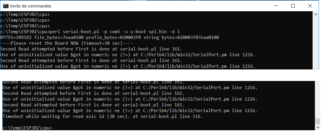

  • After some issues to install SerialPort on ActivePerl 5 I finally managed to launch the script, but it end in a timeout after less than 1 second (even if the log say I have 30sec to reset the board...)

  • Hi
    the perl script is now working with strawberryperl 32bits.
    The script ends with "u-boot-spl.bin file download completed", then I connect to the serial port with teraterm but I don't see the CCC characters and the YMODEM send doesn't work
    I am not sure if I am using the good spl file, where is it located in the SDK ?
    Christophe

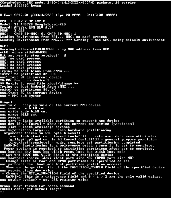

  • Thanks the u-boot load is now working !
    But I am facing a new issue :
    How do i send the kernel file through UART ?
    And what I have to do with MLO file ?
    For now I sent u-boot-spl.bin through perl, and u-boot.img through YMODEM
    UART will be very slow to send a kernel file and rootfs... Perhaps can I go through NFS kernel and filesystem now I have a working u-boot ?

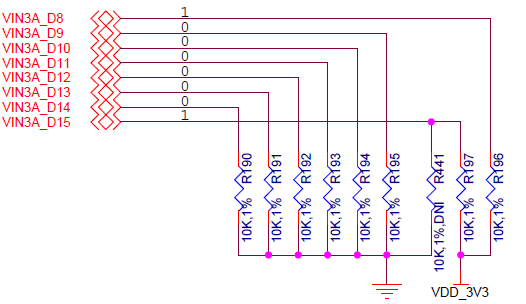

  • my SYSBOOT15 pin was not at the good level, I changed it to have a pull up on it and I have CTRL_CORE_BOOTSTRAP=0x00008113 on my board like in EVM

  • Can you provide some feedback on why SYSBOOT15 was not at a good IO level?  According to your previous feedback, these pins are not shared with other functions.  Giving feedback on issue with SYSBOOT15 might point us to other issues.
  • It was an error in my BOM, R441 was mounted instead of R197
  • I found why we have this difference and our BOM. We started from beagleboard-X15 schematic that changed the sysboot15 config :
    As the beagleboard is working I don't think the issue is due to this...

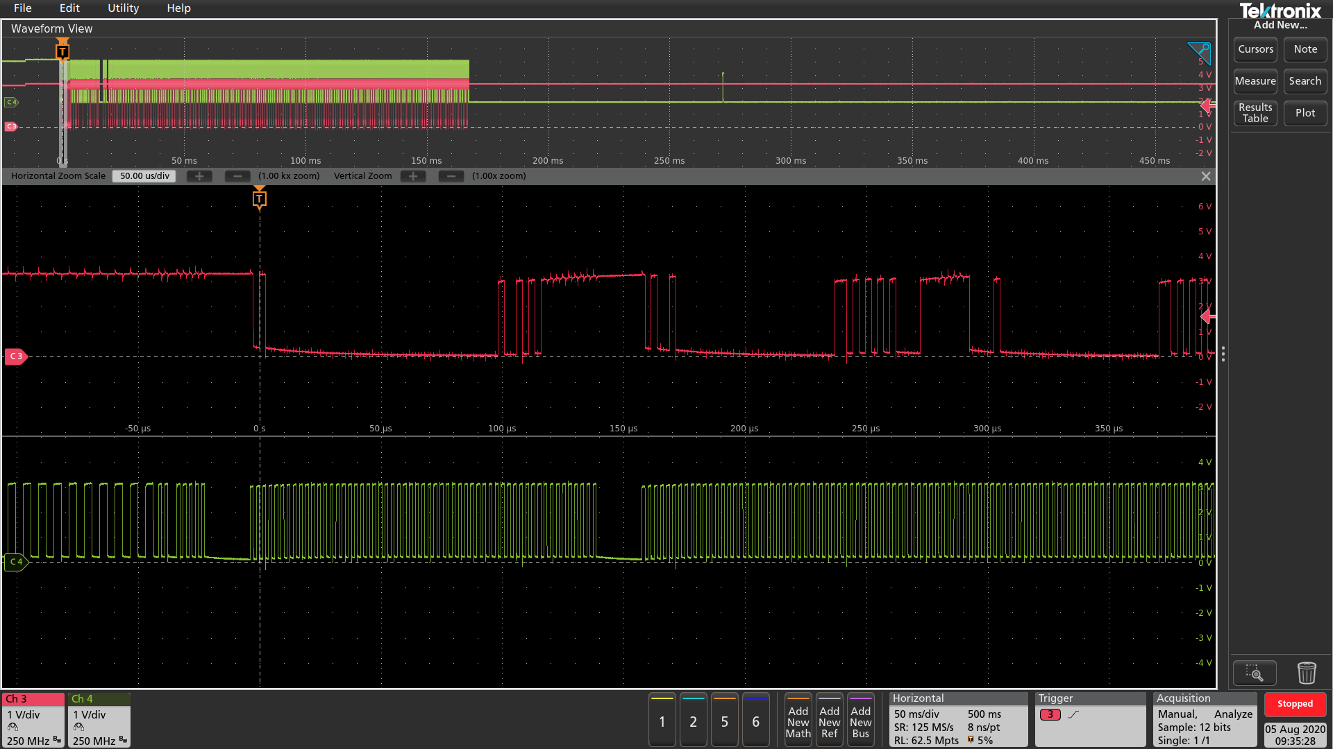

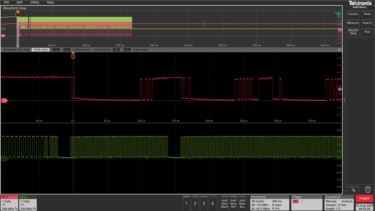

  • Ok.  Good you are able to download a simple code and run.  Which boot mode are you configured for right now (UART or SD)?
    If you are configured for UART - after downloading code, can you connect with JTAG and verify if SDRAM is stable?
    If you are configured for SD card boot - do you have access to a scope?  Do you see any activity on the SD_CLK and SD_CMD signals?
  • I am in SD boot mode. After pressing the reset button I can see activity on SD cmd and clock signals during 170ms :
    After that I am able to connect with JTAG.
    I have successfully launched a helloworld and some diag programs from pdk
