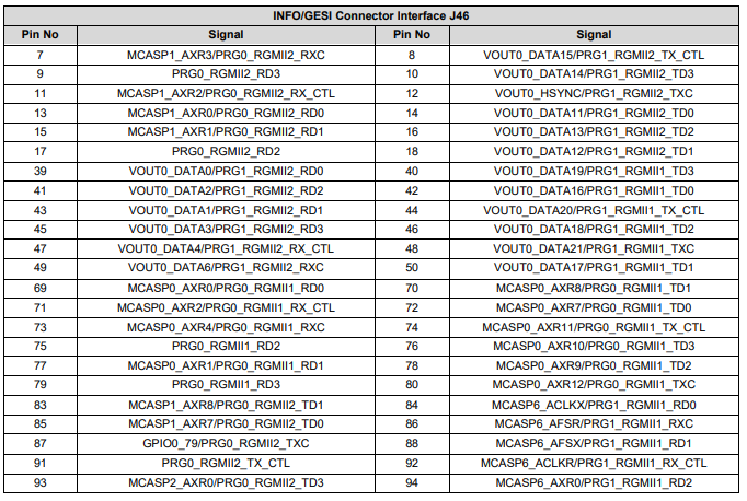

Hi Jian,
If we use J46 to operate MDIO and I2C, what should we do in addition to modify the device tree?
Moreover, how do we change the device tree? Any standard operation procedure?
Jia Hong
Jia Hong,
PRGx_RGMII pins are driven by the ICSSG firmware. Could you clarify in your last question - are you trying to use those RGMII ports, or just want to use the MDIO pins? These MDIO pins are intended for ICSSG firmware to control PHYs directly. So there will not be driver support unless you unable ICSSG firmware.
Back to J46, it seems pins 97 and 99 is the MDIO the port you needed. I see they are on A29-30 of the x1Lane PCIe slot (J11). So our intention is to modify the device tree so use the MDIO pins to configure PHYs on the PCIe card? please confirm my understanding.
Documentation on device tree is scattered, so you will have to reference to the CPSW2G driver section of the SDK user guide (Sec 3.2.2.6) for generic MDIO support. For MDIO in the main domain, I saw the CPSW9G need to be called via R5F firmware. So need to check with the team on if there is standalone MDIO driver. That would be ideal.

Hi Jian,
Our solution is that we design an adapter board or a connector to connect our board with the TI platform.
The connecting interface is J46. There are 3 interfaces (I2C/MDIO/RGMII) on the connector.
We hope that the connector will be working normally. Therefore, we want to get your suggestions.
The information on the TI website is so scattered, so we want to the simple SOP for modify the device tree or driver to shorten the development time.
Thanks a lot.
Jia Hong
Update from offline email discussions, we confirmed (J46) with below pins available for CPSW9G.
Additional conversations in offline email are regarding to software bring up of customer board.
Will keep this ticket open till MDIO clarified.
jian

I checked pinmux (not sure if you already used – you can download the pinmux tool from the DRA829 product folder), it seems that the 4 RGMII ports are muxed between ICSSGx and CPSW9G. Specifically:
The common Processor board schematics did not show the RGMIIx pins, where only the PRGx_RGMIIx port pins are show. But you can configure to use CPSW9G to drive those pins. You may want to double check using the pinmux tool:
Jia Hong reported expansion board is working upon building the ethfw in visionapps:
all standing issues resolved.
