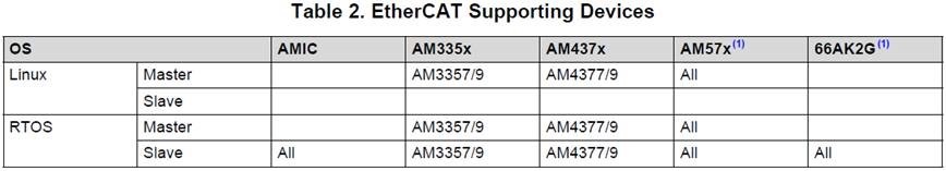

Hi Expert,
Does EtherCAT slave drivers support Linux?

Hello Daniel,
No, TI does not support EtherCAT slave on AM335x Linux. As per post EtherCAT Slave on Linux, some people have have gotten EtherCAT slave working on RT Linux. However, TI is unable to support that development if you decide to implement it yourself.
