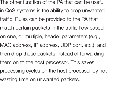

From Keystone Architecture Packet Accelerator (PA) User Guide,
"The PDSP firmware classifies data packets by submitting lookup requests to the LUT1 module, and the LUT1 returns the results of the lookup based on the contents of the entries stored in its lookup table. Based on the results from the LUT1 module, the PDSP will direct the packet to the next destination, or drop the packet if it did not match any of the LUT1 entries."

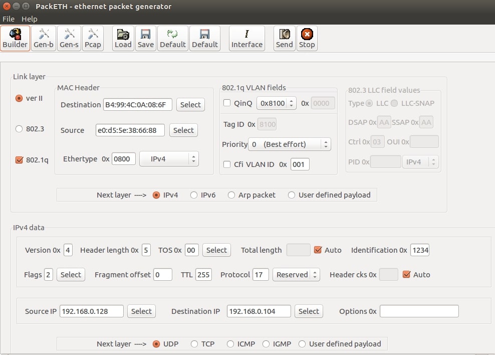

    1. Here I sent packets from ethernet,PA LLD contains MAC, IP header information from pktMtachBuff & it matches pa_addMAC, pa_addIP functions containing MAC, IP. It process the packets on wire related above asking questions.
    Results
        Sending (pktmatchbuff) packets on wire based on added MAC, IP on (pa_addMAc, pa_addIP)APIs.
    2. Now I need to receive packets from ethernet based on using packetEth UDP packet generator to send packets on PC to EVM ethernet wire, it should matches pa_addMAC, pa_addIP & should process the receive packets from packet accelerator.
    Results:
        Sending packets from PC to EVM    - >       Not capturing packets on EVM ethernet.

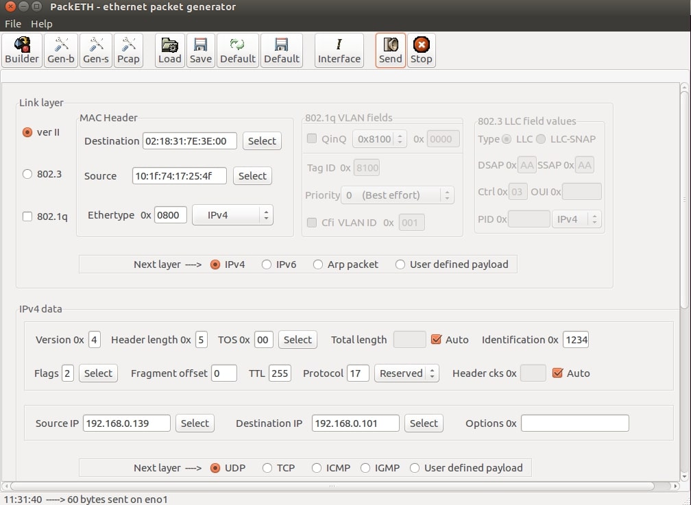

  • Dear Aravind,
    "Can you please confirm, on the out of box loopback example, just by changing the information in the packet for MAC/IP/UDP (and update in the cooked up packet in the example) for the expected MAC/IP/UDP, did the example work? It should work given it had worked for you with out of box mac/ip/udp information"
    Response:
    Example application works correctly on the expected MAC/IP/UDP with loopback example & sending packets on wire also captured in wireshark application.
    "After example (updated as above) works, then you can send the same packet via Wire to the EVM and see if the packets are received. Note that when you are expecting the same packets from wire, you can comment the push to PA input queue test code in cppi_qmss_mgmt.c file ( Do not need this code, since there is loopback test and packets are expected to be arriving via the Eth interface. Qmss_queuePushDescSize (gPaTxQHnd[TF_PA_Q_INPUT], pCppiDesc, SIZE_HOST_DESC);)"
    Response
    Here I commented sendPacket() Api & we sending packets from UDP packet generator like packeth application we need to try to give correct MAC, IP & PORT with UDP packets & we are trying to get udp packets on match with PA LUT entries
    Please check above respone & our trying inputs are correctly or not?

       "How are you sure that packets are going to PA and matching the MAC, IP and UDP entries?"
        Response:
        Here we ping <ip> from what we added IP in example applicaition code.
        ping from EVM & ping from PC    < Here you will confuse, If I am pinging <IP> from EVM to PC & PC to EVM is discarding the packets.>

        Using Packeth application to sent packets:
        Before running PA LLD code.
        Sent packets    ---------   Laptop to EVM   ---------- SUCESS (Note: Laptop is added as a Source MAC on PA rules using Pa_addMAC )
        Sent packets    ---------   PC to EVM       ---------- SUCESS (Note: PC information is not added as a Source MAC on PA rules using Pa_addMAC)
        After running PA LLD code.
        Sent packets    ---------   Laptop to EVM   ---------- Failure -> not capturing Packets (Note: Laptop is added as a Source MAC on PA rules using Pa_addMAC )
        Sent packets    ---------   PC to EVM       ---------- SUCESS -> Capturing Packets (Note: PC information is not added as a Source MAC on PA rules using Pa_addMAC)

       From Receiving side of EVM, We need to use PA rules to compare the headers extraction from LUT table what we added.
    "I am getting a feel that you are adding a MAC, IP and UDP port match rule in PA, to match a packet received from an ethernet port and route to host queue"  -> Exacyly We need this.

       Above laptop information we are not added means, that is unwanted packets coming to EVM. We need to avoid that one.
       All devices are connected to EVM only with using hub & below test results are here please verify.
       1. Not receiving the packets from EVM, (ie) We added PA rules with PC as a source, using Packeth(UDP packet generator) to sending packets from PC to EVM.
       2. Receiving the packets from EVM, (ie) We are not added PA rules with Laptop as a source, using Packeth(UDP packet generator) to sending packets from Laptop to EVM.

    Capturing Packets from EVM on Laptop
    root@AM5K2E04:~# tcpdump -i eth0 -c500 -nn src 192.168.0.120
    [  263.524927] device eth0 entered promiscuous mode
    tcpdump: verbose output suppressed, use -v or -vv for full protocol decode
    listening on eth0, link-type EN10MB (Ethernet), capture size 262144 bytes
    10:23:50.452160 IP 192.168.0.120.1234 > 192.168.0.104.5678: UDP, length 16
    10:23:50.549773 IP 192.168.0.120.1234 > 192.168.0.104.5678: UDP, length 16
    10:23:50.734045 IP 192.168.0.120.1234 > 192.168.0.104.5678: UDP, length 16
    10:23:51.014296 IP 192.168.0.120.1234 > 192.168.0.104.5678: UDP, length 16
    ^C
    4 packets captur[  268.112777] device eth0 left promiscuous mode
    ed
    4 packets received by filter
    0 packets dropped by kernel
    root@AM5K2E04:~#
    root@AM5K2E04:~# tcpdump -i eth0 -c500 -nn src 192.168.0.128
    [  736.887196] device eth0 entered promiscuous mode
    10:31:42.436042 IP 192.168.0.128.1234 > 192.168.0.104.5678: UDP, length 16
    10:31:44.884396 IP 192.168.0.128.1234 > 192.168.0.104.5678: UDP, length 16
    10:31:45.987640 IP 192.168.0.128.1234 > 192.168.0.104.5678: UDP, length 16
    10:31:46.202750 IP 192.168.0.128.1234 > 192.168.0.104.5678: UDP, length 16
    10:31:46.402552 IP 192.168.0.128.1234 > 192.168.0.104.5678: UDP, length 16
    10:31:46.595093 IP 192.168.0.128.1234 > 192.168.0.104.5678: UDP, length 16

    Step 2:
       Sending UDP Packets from PC & laptop to EVM
       Results in testing from Packeth (udp packet generator application)
        Attached screenshots from PC to EVM. Please verify.
    Screenshot from Laptop to EVM

    From the diagram of the packet generator you shared,
    I see the entries you added do not match to the packet either from Laptop or from PC, which can explain why you are not seeing the packets in the Rx queue.
    MAC Lookup:
    1. The MAC address of PC does not match to the source mac address you have added in the MAC LUT lookup, hence packets would not be forwarded to next stage from PA, from MAC
    If your intent is to match the packets from PC or Laptop, you need to have the exact matching parameters OR have wild card (don't care) fields to match wide range.
    2. I do not see a specific entry added for Laptop MAC ID added as the source mac ID in the Add_Mac(), hence none of the packets from this MAC source would be matching and hence they would not be forwarded to next stage (IP lookup).
    IP Lookup:
    1. I see you added IP packet source = 192.168.0.120 designated to 192.168.0.104, which are originating from the MAC source and designated to the EVM MAC ID as shown in the above diagram.
    As per your test, I do not see any packets matching this MAC/IP combination, so you would not see any packets from IP Lookup to proceed to LUT2 look up.

        commented SendPacket() in PA lld code with loop back example modification & we are sending Packeth (UDP packet generator) packets to EVM with matching MAC. IP information is not working.
        I am not able to receive packets from PA application, but able to receive packets on Wireshark application.
         Not able to capture packets in PA Input queue.

           Below attached document there mentioned for Packet Accelerator with QoS features for packet discarding & priority on QoS queues(check on 4th page )
           QualityOfService(QOS).pdf

        One more information from my side.
        We are able to receive the packets on PA subsystem. PA able to see the packets & matching the packet information to discarding the packets not matched.
        Attached file Please check clearly tcpdump to passing my source & capture the packets before running PA LLD appplication & After running application.
    ^C
    ed
    root@AM5K2E04:~#
    [  722.367287] device eth0 entered promiscuous mode
    /************** Dear aravinth, Packet is not reaching in EVM from Laptop (Laptop information is added on PA rules)************************/
    ^C
    0 packets captur[  731.550881] device eth0 left promiscuous mode
    10:31:46.794627 IP 192.168.0.128.1234 > 192.168.0.104.5678: UDP, length 16
    10:32:46.210981 IP 192.168.0.128.57914 > 239.255.255.250.1900: UDP, length 172
    /************** Dear aravinth, Packet is reaching in EVM from PC (PC information is not added on PA rules)************************/

    ############### Dear Aravind, Before running PA example application, We able to capture packets on EVM #################
    root@AM5K2E04:~# tcpdump -i eth1 -c500 -nn src 192.168.0.139
    listening on eth1, link-type EN10MB (Ethernet), capture size 262144 bytes
    05:49:46.511251 IP 192.168.0.139.1234 > 192.168.0.101.5678: UDP, length 16
    05:49:46.675711 IP 192.168.0.139.1234 > 192.168.0.101.5678: UDP, length 16
    05:49:46.860345 IP 192.168.0.139.1234 > 192.168.0.101.5678: UDP, length 16
    05:49:46.996085 IP 192.168.0.139.1234 > 192.168.0.101.5678: UDP, length 16
    05:49:47.210452 IP 192.168.0.139.1234 > 192.168.0.101.5678: UDP, length 16
    05:49:47.479990 IP 192.168.0.139.1234 > 192.168.0.101.5678: UDP, length 16
    05:49:47.659450 IP 192.168.0.139.1234 > 192.168.0.101.5678: UDP, length 16
    05:49:47.809057 IP 192.168.0.139.1234 > 192.168.0.101.5678: UDP, length 16
    05:49:47.979311 IP 192.168.0.139.1234 > 192.168.0.101.5678: UDP, length 16
    05:49:48.173019 IP 192.168.0.139.1234 > 192.168.0.101.5678: UDP, length 16
    05:49:48.352578 IP 192.168.0.139.1234 > 192.168.0.101.5678: UDP, length 16
    05:49:48.632373 IP 192.168.0.139.1234 > 192.168.0.101.5678: UDP, length 16
    ^C
    12 packets captu[   68.293816] device eth1 left promiscuous mode
    red
    12 packets received by filter
    root@AM5K2E04:~#

  • Hi Santhana,
    Sorry you are still not successful.
    I think, there are issues in the way you are checking the packets. Also, by the way, were you able to figure out how to check the logs for mailbox and switch via JTAG?
    I still do not understand what you are doing or trying to achieve. I see you are adding entries from the user mode program and running tcpdump to capture the packets?
    You can not add an entry in the PA rule routing the packets to Host Queue "N" and kill that user mode program and run tcpdump for the capture.
    You should be checking for packets from the user mode example itself (not tcpdump).
    My understanding so far from you:
    My understanding was you are having external packet generators sending packets towards the EVM from PC and Laptop and you are testing to receive the packets by adding the appropriate entries in the PA. Based on your PA rules, the packets should arrive on the receive queue in the user mode application.
    Since you wanted the packets from two different sources, I suggested to add two different entries in PA, which can still route to same queue in the multicore example.
    Note that I had also suggested multicore example is not meant to demonstrate the QOS queue (Interface based or Priority based routing) - You would need to implement it using different APIs.

  • Hi Santhana,
    "Anyway we are receiving packet from ethernet port on EVM, for this reason I am checking on tcpdump to capture packets on tcpdump."
    How would tcpdump receive the packets from the user mode queue that you are programming?
    I think, for your setup (using a different flow from user mode application and routing the packet to host queue at user mode) and expecting the tcpdump to see that packet is not correct.
    I am not an expert on Linux Kernel/tcpdump details. I can provide you details on how PA works. Based on the entries and routing information you added,  I see that  after the example is run, you are re-routing the traffic to some queues that are using a different flow than the one used by Linux. Hence tcpdump is not seeing the packets.
    To verify if the packets are received at the queue you are programming, you can run the user mode program and wait until you receive the packets at the programmed host queue.
    The packet source can be the packet generator (external).
    Since you already verified packet routing to the host queue is working with the SendPacket, the LUT entries are good for the signature of the cooked up packet that you are sending from SendPacket().
    If you did not receive packet in the user mode application's host queue, from the external packet generator,
    the issue could be:
    1. Your packet signature is different from external source, hence PA LUT match does not happen
    2. OR there is something, preventing the packet reaching to PA. If you need to check if packets are reaching to PA, you need to check the mail box registers at PA to make sure packets are reaching to PA.
    I have provided all the details for you to make changes for your needs.
    -Thanks,
    Aravind
  • Dear Aravind,
          "Your packet signature is different from external source, hence PA LUT match does not happen"
            Attached my packet generator screenshot with MAC, IP & Ports , I thought my PA LUT is matching only,
