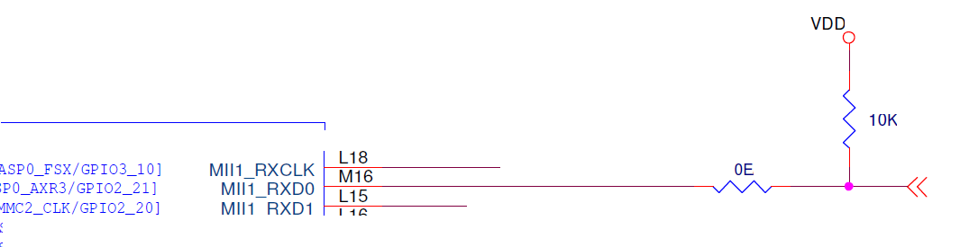

    I am using gpio2_21 pin as input in my am335x ZCZ package. In hardware i am getting the signal as 1 and 0
    But using with this declaration in my dts and using system calls is getting always 0.
    Please check the below declaration to read the gpio in am335x and suggest me.

    please find the below circuit to read the input signal.
    lofna
  • find the circuit.
  • Hi
    First make sure the two resistors are solder well. For PIN M16, It shows "L" during reset (Ball Reset State) and "L" with an active pull down after reset (Ball Reset Rel State).  you can try changing 10k to 4.7k. if this doesn't solve this, check your code again.
    regards
    wang jian
  • What is the connection off the right side of the schematic?
    James
