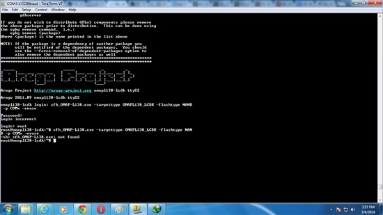

    I have purchased  OMAP L138 LCDK i am not able to perform the Procedure to Flash and boot the LCDK with the serial port method given on the link http://processors.wiki.ti.com/index.php/L138/C6748_Development_Kit_(LCDK)#USB_UART_Port_.28J3.29 i connected the USB UART with my windows PC with teraterm the os on the SD card boots after logging in and executing the commands given which is sfh_OMAP-L138.exe -targettype OMAPL138_LCDK -flashtype NAND -p COMx -erase it gives error saying sfh_OMAP-L138.exe not found. pls help we are not able to process anything we want to use opencv library for image processing also pls help regarding how to use OPENCV library on OMAP L138 LCDK . i hv attched the error  snap shot.
  • Hi Vivek,
    First set the boot pins to UART2 boot mode from SD Card boot, then flash writer tool should be in the default directory if you installed OMAP-L138 starter ware kit or please check the local path and point to the flash writer tool.
     C:\ti\OMAPL138_StarterWare_1_10_03_03\tools\flash_writer
    Open the command prompt window in your windows PC and go to the flash writer path mentioned above and place the command sfh_OMAP-L138.exe -targettype OMAPL138_LCDK -flashtype NAND -p COMx –erase
    Please make sure this command will erase all the content of the NAND flash

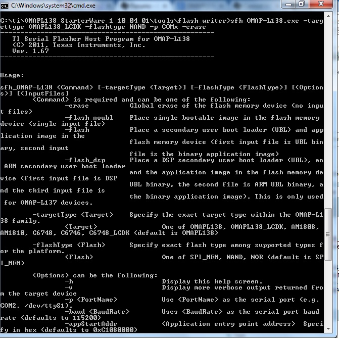

     how can i know that this command sfh_OMAP-L138.exe -targettype OMAPL138_LCDK -flashtype NAND -p COMx –erase will erase the NAND flash i have done the above process i comes like this
    C:\ti\OMAPL138_StarterWare_1_10_04_01\tools\flash_writer>sfh_OMAP-L138.exe -targ

  • Hi Vivek,
    Please use the below command to erase the NAND flash.
    sfh_OMAP-L138.exe  -targetType OMAPL138_LCDK -flashType NAND -p COMx -erase
    x ---> is the COM serial port no which you have connected your console cable to your PC.
    Ex:
    If i have connected your board serial console cable to windows in COM1 then (confirm by device manager)
    sfh_OMAP-L138.exe -targetType OMAPL138_LCDK -flashType NAND -p COM1 -erase
    Please let me know the results.

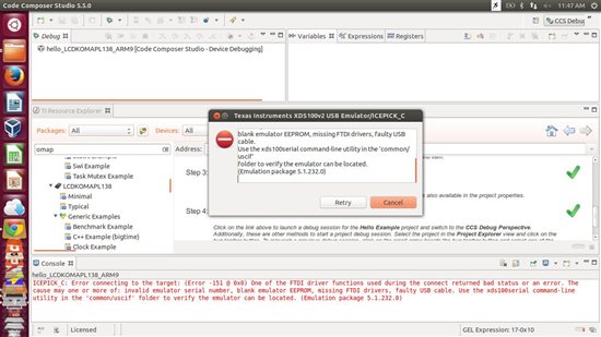

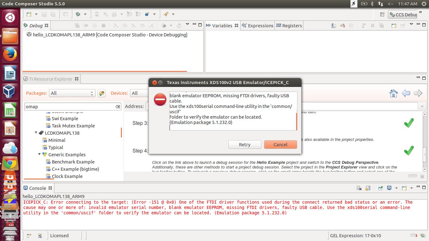

    after reflashing the  NAND now i have another problem with my XDS100V2 emulator when i execute any programme in ccs with OMAPL138LCDK kit it generates an error while Debugging and Importing project  in ccs which is
    error connecting to the target:
    (Error -151 @ 0x0)
    One of the FTDI driver functions used during
    the connect returned bad status or an error.
    The cause may one or more of: invalid emulator serial number,
    blank emulator EEPROM, missing FTDI drivers, faulty USB cable.
    Use the xds100serial command-line utility in the 'common/uscif'
    folder to verify the emulator can be located.
    (Emulation package 5.1.232.0)
    earlier it was fine when i reflshed the NAND with the above post after that i am getting the erros on CCS i cannot able to correct  and cant understand what to do .PLS HELP.....???
  • Hi Vivek,
    Please refer the following TI wiki links to troubleshoot the emulator problems.
    If not solved,
    Can you please create a new thread for this issue as posting on the same thread will get only less attention when compared to the new one. And as well, this thread seems to be a closed one.
    And also, I observed that all your posts have the same heading/title as "OMAPL138 LCDK".  Try to match it with your problem; so that it would be easy to differentiate various problems.
    Thanks for your understanding.
