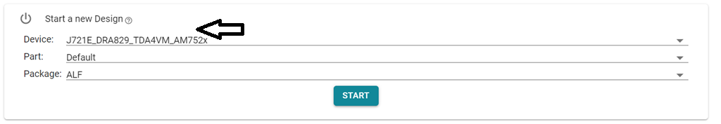

    1. Go to: https://dev.ti.com/sysconfig/?fromPinmux=true#/start
    2. In the “Start a new Design” Pick an existing design that matches your part number . Ex: J721E_DRA829_TDA4VM_AM752x
      Keep the “Part” tab default & “Package” ALF. Click “Start” button. As shown in the screenshot below:

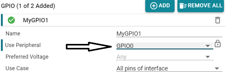

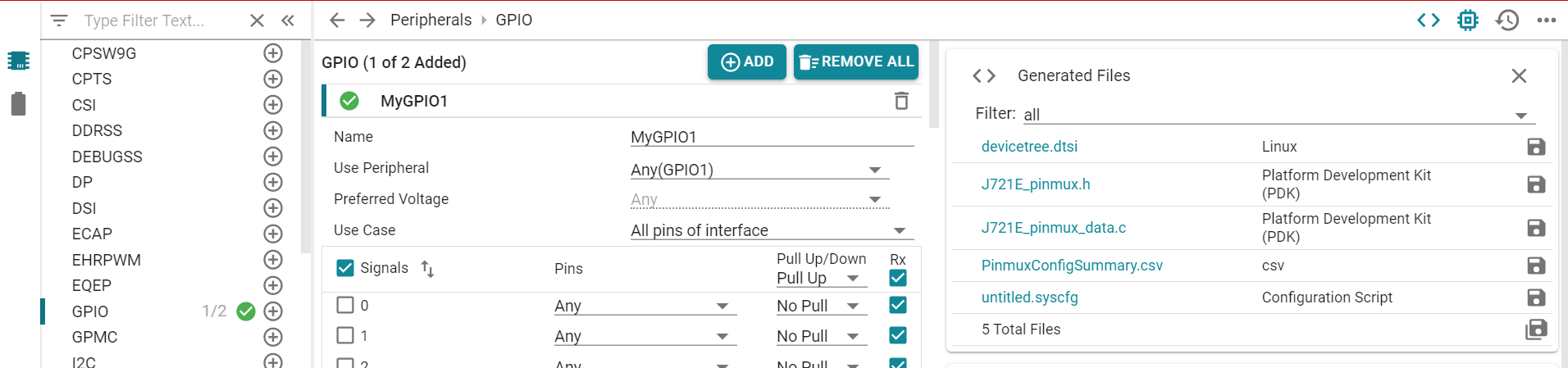

    3. Choose the peripheral by entering the corresponding name in the “Type Filter Text” (Left top of the page).
      ex: GPIO & Click “+” sign. This will add a module on the center.
    4. MyGPIO1 will have some defaults.  Choose the exact module instance in the “Use peripheral” menu.
      By default it will be ANY. Select the appropriate instance using the drop down menu. Ex: In our case let’s say: GPIO0

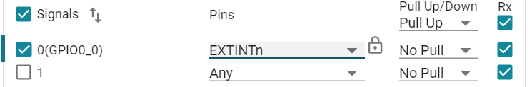

    5. With this, we are done with module level selection. Now we just need to pick the ball name that maps to the one present in the board schematics.
      This can be accomplished by choosing the right ball name in the “Pins” drop down menu.
      Based on schematics pick appropriate “Pull Up/Down” from the drop down menu.
      Ex: Refer the Manual audit section below on how we pick the pin name EXTINTn

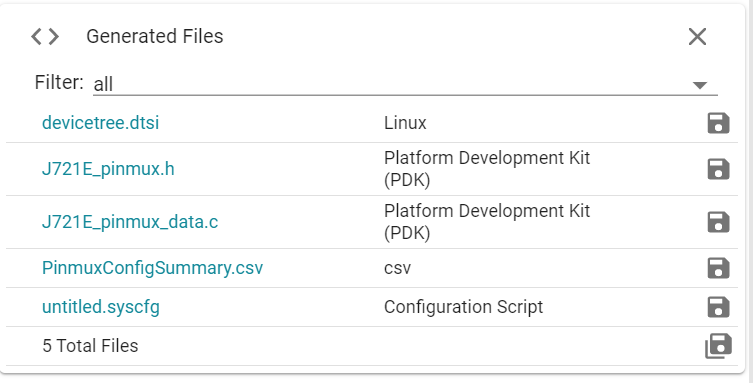

    6. From the “Generated Files” section, based on the choice of OS, download one of these files:
           - Linux: devicetree.dtsi: Just need to copy paste the node as is under the right parent pinmux node (see below for details)
           - PDK(RTOS): J721E_pinmux.h/ J721E_pinmux.c
    7. Ex: Linux: devicetree.dtsi.
      We have chosen main gpio0 hence the pinmux node for the example mygpio1_pins_default should come under main_pmx0 node in arch/arm64/boot/dts/ti/j721-common-proc-board.dts file.
