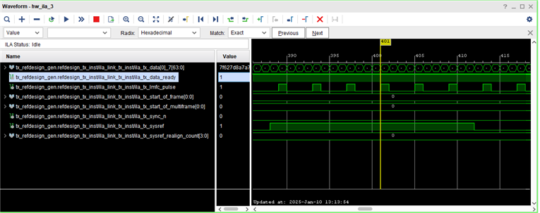

  • As a side question:  Why is tx_lane_data_ready always high in this configuration?  I would expect tx_lane_data_ready to be high 1/6 of the time:
    Note - I have added the signal explicitly to the ila_link_tx_inst:
    ila_link_tx_inst (
    .sys_clock (tx_sys_clock),
    .tx_lane_data (tx_lane_data),
    .tx_lane_data_ready (tx_lane_data_ready),
  • Hi Jesse,
    One potential issue here is the sys_clk frequency. The DAC JESD link has a strict requirement where the tx_sysclk must be equal to LaneRate/80. In this case you are using a frequency that is 6x, can you change the PLL to output 30.72MHz for the sys_clk and see if that helps with the link bring up issues?

  • David,
    Thank you for your quick answer.  This has indeed fixed the initialization issue with one caveat.  On 8 out of 10 tries, I had to assert then de-assert master_reset_n after AFE.deviceBringup() since de-asserting rx_sync_reset did not bring up the AFE->FPGA link (data valid remained low). On the other two tries, de-asserting rx_sync_reset did establish the AFE->FPGA link. My full procedure:
