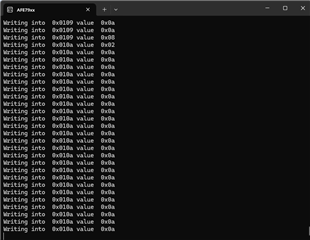

Please refer to the attached configuration script for additional details. after running the below script we are facing below errors in the Latte log.
#fpgaside 24410 afeside 12410 1 inst's are there ############## Read me ############## #In HSDC Pro DAC tab, Select AFE79xx_2x2TX_44210; Data Rate = 245.76M #In HSDC Pro ADC tab, Select AFE79xx_2x2RX_44210; Data Rate = 245.76M ---> To capture 4 RX channels sysParams=AFE.systemParams sysParams.__init__();sysParams.chipVersion=chipVersion setupParams.skipFpga = 1 # setup FPGA (TSW14J56) using HSDC Pro ############## Top Level ############## sysParams.FRef = 491.52 sysParams.FadcRx = 2949.12 sysParams.FadcFb = 2949.12 sysParams.Fdac = 2949.12*4 sysParams.externalClockRx=False sysParams.externalClockTx=False ############## Digital Chain ############## ##### RX ##### sysParams.ddcFactorRx = [12,12,12,12] #DDC decimation factor for RX A, B, C and D sysParams.rxEnable = [True,True,False,False] sysParams.rxNco0 = [[9500,9500], #Band0, Band1 for RXA [9500,9500], #Band0, Band1 for RXB [9500,9500], #Band0, Band1 for RXC [9500,9500]] #Band0, Band1 for RXD ##### FB ##### sysParams.fbEnable = [False,False] sysParams.ddcFactorFb = [12,12] #DDC decimation factor for FB 1 and 2 sysParams.fbNco0 = [9500,9500] #Band0 for FB1 and FB2 ##### TX ##### sysParams.ducFactorTx = [48,48,48,48] #DUC interpolation factor for TX A, B, C and D sysParams.txEnable = [True,True,False,False] sysParams.txNco0 = [[9500,9500], #Band0, Band1 for TXA [9500,9500], #Band0, Band1 for TXB [9500,9500], #Band0, Band1 for TXC [9500,9500]] #Band0, Band1 for TXD ############## JESD ############## ##### ADC-JESD ##### sysParams.jesdSystemMode= [3,3] #SystemMode 0: 2R1F-FDD ; rx1-rx2-fb -fb #SystemMode 1: 1R1F-FDD ; rx -rx -fb -fb #SystemMode 2: 2R-FDD ; rx1-rx1-rx2-rx2 #SystemMode 3: 1R ; rx -rx -rx -rx #SystemMode 4: 1F ; fb -fb- fb -fb #SystemMode 5: 1R1F-TDD ; rx/fb-rx/fb-rx/fb-rx/fb sysParams.jesdTxProtocol= [0,0] # 0 - 8b/10b encoding; 2 - 64b/66b encoding sysParams.LMFSHdRx = ["24410","24410","24410","24410"] #changed by Lakshmi ["44210","44210","44210","44210"] # The 2nd and 4th are valid only for jesdSystemMode values in (0,2). # For other modes, select 4 converter modes for 1st and 3rd. sysParams.LMFSHdFb = ["14810","14810"] sysParams.rxJesdTxScr = [True,True,True,True] #changed by Lakshmi sysParams.fbJesdTxScr = [True,True] sysParams.rxJesdTxK = [16,16,16,16] sysParams.fbJesdTxK = [16,16] sysParams.jesdTxLaneMux = [0,1,2,3,4,5,6,7] # Enter which lanes you want in each location. # For example, if you want to exchange the first two lines of each 2T, # this should be [[1,0,2,3],[5,4,6,7]] ##### DAC-JESD ##### sysParams.jesdRxProtocol= [0,0] sysParams.LMFSHdTx = ["24410","24410","24410","24410"] sysParams.jesdRxLaneMux = [0,1,2,3,4,5,6,7] # Enter which lanes you want in each location. sysParams.serdesRxLanePolarity = [1,1,0,0,0,0,0,0] # For example, if you want to exchange the first two lines of each 2R # this should be [[1,0,2,3],[5,4,6,7]] sysParams.jesdRxRbd = [4, 4] sysParams.jesdRxScr = [True,True,True,True] sysParams.jesdRxK = [16,16,16,16] ##### JESD Common ##### sysParams.jesdABLvdsSync= False sysParams.jesdCDLvdsSync= False sysParams.syncLoopBack = True #JESD Sync signal is connected to FPGA ############## GPIO ############## sysParams.gpioMapping = { 'H8': 'ADC_SYNC0', 'H7': 'DAC_SYNC0', #'ADC_SYNC1', 'N8': 'ADC_SYNC2', 'N7': 'ADC_SYNC3', 'H9': 'ADC_SYNC1', #'DAC_SYNC0', 'G9': 'DAC_SYNC1', 'N9': 'DAC_SYNC2', 'P9': 'DAC_SYNC3', 'P14': 'GLOBAL_PDN', 'K14': 'FBABTDD', 'R6': 'FBCDTDD', 'H15': ['TXATDD','TXBTDD'], 'V5': ['TXCTDD','TXDTDD'], 'E7': ['RXATDD','RXBTDD'], 'R15': ['RXCTDD','RXDTDD']} ############## LMK Params ############## lmkParams.pllEn = True lmkParams.inputClk = 983.04 # Valid only when lmkParams.pllEn = False lmkParams.lmkFrefClk = True setupParams.fpgaRefClk = 245.76 # Should be equal to LaneRate/40 for TSW14J56 ############## Logging ############## logDumpInst.setFileName(ASTERIX_DIR+DEVICES_DIR+r"\Afe79xxPg1.txt") logDumpInst.logFormat=0x0 #Modify to 0x1 to save register scequence to log file. Script takes more time to execute. logDumpInst.rewriteFile=1 logDumpInst.rewriteFileFormat4=1 device.optimizeWrites=0 device.rawWriteLogEn=1 device.delay_time = 0 #--------------------------------------# #setupParams.skipLmk = False #AFE.initializeConfig() #lmkParams.sysrefFreq = AFE.systemStatus.sysrefFreq #lmkParams.lmkPulseSysrefMode = False #AFE.LMK.lmkConfig() #-------------------------------------------------------------------------------------------------# AFE.deviceBringup() AFE.TOP.overrideTdd(15,3,15) # bit-wise; 4R,2F,4T #setupParams.skipLmk = 1 #AFE.deviceBringup() #AFE.TOP.overrideTdd(15,0,15) #setupParams.skipLmk = 0

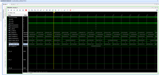

Currently, eventhough we got errors in log file,we are observing that the TX_RESET_DONE and RX_RESET_DONE signals are being asserted as expected; however, the SYNC signal is not coming from the DAC_JESD_rx or the RX_FPGA JESD. Interestingly, if I manually assert the reset again after configuring the AFE, the TX_SYNC signal is generated, but the RX_SYNC signal is still absent.
For further reference, please find the attached screenshot detailing the issue. If the RX_SYNC signal is not being generated, the ADC JESD_TX should be sending comma characters. However, I am observing random data instead.

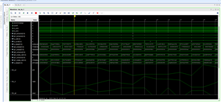

In a separate scenario, I reset the system and started configuring the AFE board, but I de-asserted the reset before the AFE configuration was completed.This time is didn't get any errors in latte log,And I was able to observe both RX_SYNC and TX_SYNC signals; however, random data is being received from the ADC on the RX side, which does not appear to be correct. I have attached a screenshot for reference.

Hi Ajay,
I believe that the issue you are facing is caused by the bringup sequence. If the FPGA is not sending data to the AFE before device configuration then you would receive the errors you show above.
Can you try following the sequence below and see if that fixes the errors you are seeing?
David Chaparro
Hi David,
Thank you so much for your valuable assistance. We followed your instructions, and the issue has been resolved.
