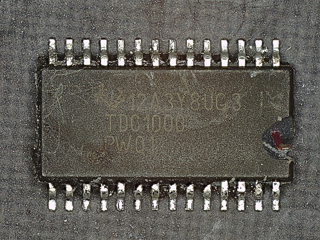

Bosch customer return which was analyzed internally at SSI. FA determined TDC1000QPWRQ1 was the reason for failure but FA was rejected due to the damage to suspect unit. TI Quality advised we submit ticket on here to get in touch with responsible apps and systems experts.
Upper management at SSI Tech and our customer are pushing for some sort of analysis on this component if possible through TI and/or if there is a 3rd party that would take for further testing. Please advise

    I am assuming that the visible damage was caused during operation is that correct? I just want to ensure that the device wasn't received in this manner or that the visible damage wasn't incurred during the removal process from the PCB.
    Do you have a count of how many units are showing this damage?
    My thought is that if the damage is only isolated to one unit and this issue is not showing on several units it might be difficult for the team to justify FA.
    Just to be safe has the SSI team tried placing a new device on the board to ensure the problem does not follow the board?

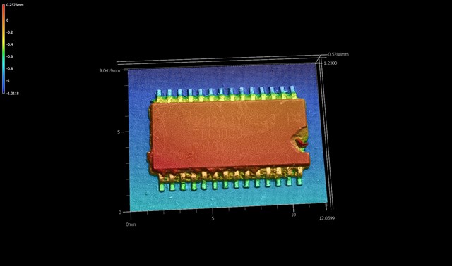

  • Hi Isaac,
    It is my understanding that the part obtained visible damage during removal process of the MCU. When the epoxy is flowing over the board, it also flows under this component so removing causes issues as it's basically bonded to the board. This is a warranty claim, so they would like us to try every available avenue to obtain FA of this device. In the past we have returned parts to TI with visible damage but it was determined that the functionality was not affected by this.
    Preventative action of not removing MCU was proposed to prevent damage during FA, but we were informed that FA is not supported through customer return portal on customer PCBs. This is very understandable, but it causes us to be in a tough position. Are there 3rd party companies which could perform some sort of FA on this with the damage obtained?
    The failure was noted prior to removal and we did perform A-B-A swap to confirm failure followed the component. Know good boards are used during FA so it was confirmed to not follow board. I am unsure if schematics would be the issue as this device has been used since
    Our FA tech has some further information he will relay to me tomorrow on how far down the damage goes. He does not believe it goes down to any of the leads or portion of the part that would affect functionality.

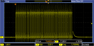

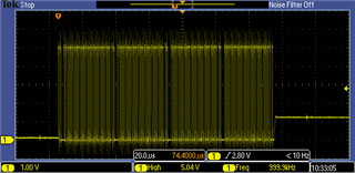

    I have received some feedback from our FA technician which is below. O-scope readings are on the attachment. Thank you for taking time to discuss this, it is much appreciated!
    The damage to the IC is superficial, and the exposed metal is an unused portion of the leadframe that is exposed on the ends of each IC.
    The IC was placed on a known good PCBA and tested. The issue followed the TDC1000. The known good board showed the same increased signal time at the PZT that was shown on the returned PCBA.
    The attached document shows the o-scope readings where the failure follows the TDC1000. Please let me know if you have issues with the document.

    I reviewed the scope captures, so it seems like the device still seems to be transmitting the signal used to the drive the piezo transducer, the main difference I noted is that the signal looks rather noisy compared to the good unit.
    Was this added noise also occurring during the listening period of the echo? I am not sure if this added noise would make much of a difference during the transmission period that was shown here but my concern is mainly during the return period. The added noise may falsely trigger the threshold to generate a STOP signal. Is this how the fail was detected or do you monitor the driving signal (signals on the attached doc) as part of the test procedure during production?
    I did check internally with the team and it seems like the FA team cannot accept physically damaged devices because the device typically will indicate various types of failures that usually are not be related to the failure you may have experienced on your system all due to the physically damage on the device. I am waiting to hear back from them to see if there is a 3rd party FA lab that we can recommend to help you perform the necessary checks you need. If you do have more than one device showing this failure though please do your best not to damage the device at removal. You may also want to check with the quality team if you can provide your board if you are concerned about damaging your device at removal and see if they can accept your return in this form.
    The main difference noted at two different SSI facilities is the duration of the signal.
    It is unknown if there is noise during the listening period with the suspect IC.
    In this application, the T0 for concentration is between 30us and 40us. Which is why the known good START pulse is so brief.
    The suspect TDC1000 is still sending the START pulse during the normal listening period where the first 3-4 echoes (STOP pulses) would normally be present. Therefore, the first ~100uS of the listening period is “listening” to the START pulse.
    The TDC1000 is initialized by the microcontroller upon power up. The suspect IC is obviously not interpreting the microcontroller’s commands correctly, as the long signal duration follows the IC, not the PCBA.
    The duration of a good concentration START pulse is less than 4uS. The failing IC’s START pulse duration is ~128uS regardless of concentration or level.
    Correct Concentration Signal Duration
    Failing Concentration Signal Duration
    The duration of a good level START pulse is less than 25uS. The failing IC's initial level duration is ~128uS regardless of concentration or level
    Correct Level Signal Duration
    Failing Level Signal Duration
    The sensor failed to read level or concentration in the customer application and was sent back to SSI for Failure Analysis. The o-scope readings show the difference in signal duration, which did not match a known good senor’s signal duration. The signal duration’s excessive length IS why the sensor failed in the customer’s application.
    The sensor passed SSI’s End-of-Line testing. This shows that the sensor was operating normally after production (i.e. the sensor gave valid level and concentration readings)
    -Estrella

    As mentioned by the FA tech the duration of transmission pulses of the bad device are significantly longer than the transmission of the pulses in the good device. I agree with the techs assessment that the device is not interpreting or listening to the microcontrollers commands.
