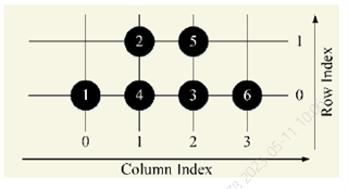

Actually, I need to design new antenna with spacing 0.7 lamda.
I would like to know how to set the parameters for 2x4 virtual antenna with 0.7 wavelength spacing like EVM as below figure.
Teach me the way to set parameters of custom antenna array by my self.

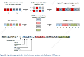

    The threads which you have linked describe the process to do this with the previous version of the SDK but  with the release of SDK 5.2 and the addition of the antennaGeometryCfg CLI command this has been made much simpler.
    Please see section 3.2.5 (Antenna Pattern Configuration) of the parameter tuning guide. The guide can be found at <SDK_INSTALL_LOCATION>/docs/MotionPresenceDetectionDemo_TuningGuide.pdf. This section describes how to modify the CLI command for custom antenna layouts.

    According to the document you mentioned, Virtual antenna array seems to be the same distance from each element in column index.
    I thought that it is from the spacing of between TX antennas and among RX antennas.
    Is it possible to have different spacing between TXs and among RXs? (For example TXs have 0.7 lamda and RXs have 0.5 lamda spacing in column way.)

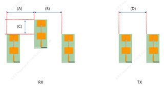

    About the answer of Q2, I thought my question is not clear to understand you.
    Of course, the elements spacing of virtual antenna array is depend on the physical TX and RX antenna geometry.
    I meant it is possible to have different gaps.
    To get it easier, I attached a figure.
    It seems (A) and (B) must be same.
    But, is it possible that all different lamda can be applied for (A), (C), (D)?
    Yes, A and B must be the same. And D must also be the same (A=B=D). C does not need to be the same however.
    If A,B,D is not the same we will have nonuniform spatial sampling.  Typically we want them to be lambda/2. Where lambda corresponds to Tx frequency in the middle of the ADC acquisition period.
