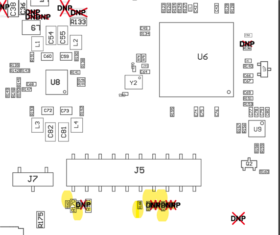

I'm working with AWR1243Boost and AWR1642Boost modules (both of Revision A) with DCA1000 boards.
I'm trying to synchronize them using hardware trigger. I'm feeding the external trigger to SYNC_IN PIN of the boards (J6-PIN10 on AWR1243Boost and J6-PIN9 on AWR1642Boost).
But I'm not getting any frames.
As mentioned in both radars user guides, the SYNC_IN is connected to these PINs in Revision B:
Does this mean that I should bring out the SYNC_IN usning a PMUX command?
I also found the following thread that says the SYNC_IN PIN is fed to the DCA1000 board and should be disconnected from that by removing R120 on DCA1000 to be usable:
https://e2e.ti.com/support/sensors-group/sensors/f/sensors-forum/710632/awr1243-dca1000-and-1243-hardware-trigger-sts_no_lvds_data
How can I remove the SYNC_IN connection to the 60pin HD connector?
Could you please help me with this issue?
