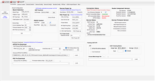

I am trying to capture the raw data using IWRL6432BOOST WITH DCA1000 EVM Interface. However, I am unable to do so. Can you please help me to capture the raw data using IWRL6432 with DCA1000 EVM.
Are there any detailed user guide/instructions document. As per DCA1000 EVM document I have setup the hardware and I am using mmWave Studio 02.01.01.00. I have changed the Ethernet settings also and I derving power from Radar board by changing the switch position.
Please guide me to get working setup.

  • Thanks Pedrhom, I tried to follow the same step mentioned int the above link, however I still unable to get the succeess.
    RSTD.Transmit("/Settings")

    [14:43:55] [RadarAPI]:
    [14:43:55] Reset FPGA :
    [14:43:55] Timeout Error! System disconnected
    [14:43:55] --xw_status=0
    [14:43:55] xw_status = mws.captureCardEthernetCfg("192.168.33.30", "192.168.33.180", "12.34.56.78.90.12", 4096, 4098, 1)
    [14:43:55] [RadarAPI]: Sending eeprom command to DCA1000
    [14:44:05] [RadarAPI]:
    [14:44:05] EEPROM Configuration :
    [14:44:05] Timeout Error! System disconnected
    [14:44:05] --xw_status=0
    [14:44:05] xw_status = mws.captureCardModeCfg(1,1,1,2, 1, 25)
    [14:44:05] [RadarAPI]: Sending fpga command to DCA1000
    [14:44:15] [RadarAPI]:
    [14:44:15] FPGA Configuration :
    [14:44:15] Timeout Error! System disconnected
    [14:44:15] [RadarAPI]: Sending record command to DCA1000
    [14:44:25] [RadarAPI]:
    [14:44:25] Configure Record :
    [14:44:25] Timeout Error! System disconnected
    [14:44:25] --xw_status=0
    [14:44:25] xw_status, s_version, s_dllVersion = mws.getCaptureCardFPGAVersion()
    [14:44:25] [RadarAPI]: Sending fpga_version command to DCA1000
    [14:44:35] [RadarAPI]:
    [14:44:35]
    [14:44:35] Unable to read FPGA Version. [error -5]

    [14:44:38] xw_status = mws.fwRprcDownload(0, 2, "C:\\ti\\MMWAVE_L_SDK_05_04_00_01\\firmware\\mmwave_dfprfevalfirmware\\appss\\mmwave_plt_rfeval_rprc.bin")
    [14:44:38] Error : Could not find a part of the path 'C:\ti\MMWAVE_L_SDK_05_04_00_01\firmware\mmwave_dfprfevalfirmware\appss\mmwave_plt_rfeval_rprc.bin'., at System.IO.__Error.WinIOError(Int32 errorCode, String maybeFullPath)
    [14:44:38] at System.IO.FileStream.Init(String path, FileMode mode, FileAccess access, Int32 rights, Boolean useRights, FileShare share, Int32 bufferSize, FileOptions options, SECURITY_ATTRIBUTES secAttrs, String msgPath, Boolean bFromProxy, Boolean useLongPath, Boolean checkHost)
    [14:44:38] at System.IO.FileStream..ctor(String path, FileMode mode, FileAccess access, FileShare share, Int32 bufferSize, FileOptions options, String msgPath, Boolean bFromProxy, Boolean useLongPath, Boolean checkHost)
    [14:44:38] at System.IO.File.InternalReadAllBytes(String path, Boolean checkHost)
    [14:44:38] at APIFramework.ConnectionApi.ConnectionAPI.fwRprcDownload(Byte c_deviceId)
    [14:44:38] --xw_status = -1
    [14:44:38]
    [14:44:38] &&&&&&&&&&&&&&&&&&&&
    [14:44:38] ***Script FAILED!***
    [14:44:38] Exception message is:
    [14:44:38] ...labExamples\LUA_examples\common_device_setup_60G.lua:54: ERROR: API failed
    I am getting above error. Also I have modified the lua script as per mentioned

    Please help me to resolve the issue.

    Unfortunately "Unable to read FPGA Version. [error -5]" is a generic error that can be caused by several different reasons. Fortunately there is a plethora of a threads across E2E that cover several solutions to this issue. I will note that this specific error is due to the inability to establish communication between DCA1000 and the PC, and has no relation to the mmWave sensor, Below are some example solutions.

    I tried with all other settings mentioned in above threats still unable to resolve the above issue.
    Can you please help to resolve the same.
    Thanks & Regards
    Prashant Koparde
