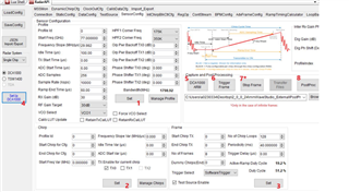

  • Hi Artzy,
    In the attachment that you shared; I could not see the Frame Ended log, are you doing the post processing before the frame stop?
    Can you first try with the configuration given in the user guide and see if you are getting the same error there as well.
    Please follow the sequence (numbers are indicated) given in the above image.
    I know the layout of AWR1843. On layout Tx1, Tx3 are azimuth and Tx2 is elevation antennas. But in mmWave studio the options are Tx0, Tx1, Tx2. That's why I am asking which of the two of Tx0, Tx1, Tx2 are azimuth antennas?
    for this, you can consider the TX1,TX2,TX3(in the layout) as TX0,TX1,TX2(in the studio).

  • Hi Artzy,
    You can refer to page number 29 (section 9.3) in the studio user guide. The user guide has snapshots with sequence mentioned, you can follow the same.
