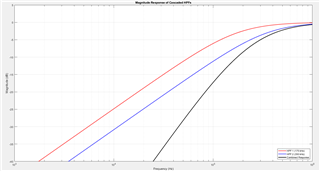

  • Greetings Sir!
    I was slightly confused on the overall response by the cascaded HPF1 and HPF2 but after some studying and searching on the blog, I found out that the cascaded approach is indeed aimed at increasing the roll-off rate so that low frequency/ DC components can be suppressed more aggressively. As I understand, two cascaded High Pass Filters with single pole each with roll off rate of 20dB/ decade equals a single Hight Pass filter with 2nd order pole and a 40dB/ decade roll-off rate.
    I did a simulation to validate my understanding. Your comments are highly appreciated.
    Best Regards
  • Hi Maaz,
    Your understanding is correct.  I would like to close this ticket.
