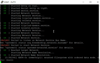

I am having problems with the serial communication of the MMWCAS-DSP-EVM + MMWCAS-RF-EVM.
What have I done:
I have followed the mmWave Studio Cascade guide`s until chapter 5. Booting the EVM. After I open up the COM port, nothing is sent over UART. I have a similar issue to e2e.ti.com/.../mmwcas-dsp-evm-no-communication-over-the-serial-port-nor-the-ethernet.
When I connect over Putty/TerraTerm to the COM port the FTDI`s TX leds blink a few times, than they stay on. When I close Putty the leds turn off. I have all the leds on both RF and DSP are on.
Small mention: one time after many reset cycles I have managed to get the attached response in the terminal. But only once, never again.
What have I tried to make it work:
1. I have tried several times to reset the TDA2XX board with S1.
2. I have checked wether S4 boot selection switches are in place. Switched them back and forth for a few times to make sure they make contact.
3. I have flashed several SD-cards with the sdimage_3_7_1.img.xz that can be found in TDA2Firmware.
4. I have removed the RF-EVM from DSP-EVM and tried booting it without.
5. I have removed the SSD from DSP-EVM and tried booting it without.
6. I have tried to update the FTDI drivers.
7. I have tried to boot the DSP without an SD card to see how it behaves but its the same.

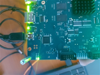

  • Yes, it is a brand new board.
    Yesterday I was further investigating this subject trying to point out where / what issue could be with the EVM.
    I found out when the EVM is cooled down to 6-10 degrees celsius, and i press U29 with my finger downwards the EVM indeed does boot, and logs are sent over UART:
    In case that I do not press U29 DDR down, but still with a 10 degree celsius EVM it sends broken characters over UART:
    I have also attached the UART logs that I got, maybe it could be helpfull to find the specific issue:

    [    5.163203] systemd[1]: sysinit.target: Found dependency on basic.target/start
    [    5.171394] systemd[1]: sysinit.target: Found dependency on sockets.target/start
    [    5.178889] systemd[1]: sysinit.target: Found dependency on dbus.socket/start
    [    5.186064] systemd[1]: sysinit.target: Found dependency on sysinit.target/start
    [    5.193521] systemd[1]: sysinit.target: Breaking ordering cycle by deleting job alignment.service/start
    [    5.202983] systemd[1]: alignment.service: Job alignment.service/start deleted to break ordering cycle starting with sysinit.target/start
    [ SKIP ] Ordering cycle found, skipping alignment.service
    [    5.240841] systemd[1]: Created slice System Slice.
    [  OK  ] Created slice System Slice.
    [    5.267927] systemd[1]: Created slice system-getty.slice.
    [  OK  ] Created slice system-getty.slice.
    [    5.297297] systemd[1]: Listening on Journal Socket (/dev/log).
    [  OK  ] Listening on Journal Socket (/dev/log).
    [    5.327185] systemd[1]: Listening on Syslog Socket.
    [  OK  ] Listening on Syslog Socket.
    [    5.347130] systemd[1]: Reached target Remote File Systems.
    [  OK  ] Reached target Remote File Systems.
    [    5.392276] systemd[1]: Listening on Journal Socket.
    [  OK  ] Listening on Journal Socket.
    [    5.447390] systemd[1]: Starting Create list of required static device nodes for the current kernel...
             Starting Create list of required st... nodes for the current kernel...
    [    5.479864] systemd[1]: Starting Journal Service...
    [    5.509693] systemd[1]: Mounting POSIX Message Queue File System...
    [    5.540112] systemd[1]: Mounting Temporary Directory...
    [    5.569594] systemd[1]: Starting Setup Virtual Console...
    [    5.597366] systemd[1]: Listening on udev Kernel Socket.
    [  OK  ] Listening on udev Kernel Socket.
    [    5.627287] systemd[1]: Listening on /dev/initctl Compatibility Named Pipe.
    [  OK  ] Listening on /dev/initctl Compatibility Named Pipe.
    [    5.687338] systemd[1]: Starting Load Kernel Modules...
    [    5.701091] systemd[1]: Created slice User and Session Slice.
    [  OK  ] Created slice User and Session Slice.
    [    5.727215] systemd[1]: Reached target Slices.
    [  OK  ] Reached target Slices.
    [    5.747351] systemd[1]: Started Forward Password Requests to Wall Directory Watch.
    [  OK  ] Started Forward Password Requests to Wall Directory Watch.
    [    5.777352] systemd[1]: Listening on Network Service Netlink Socket.
    [  OK  ] Listening on Network Service Netlink Socket.
    [    5.807428] systemd[1]: Started Dispatch Password Requests to Console Directory Watch.
    [  OK  ] Started Dispatch Password Requests to Console Directory Watch.
    [    5.837140] systemd[1]: Reached target Paths.
    [  OK  ] Reached target Paths.
    [    5.888113] systemd[1]: Mounting Debug File System...
    [    5.907170] systemd[1]: Reached target Swap.
    [  OK  ] Reached target Swap.
    [    5.927333] systemd[1]: Listening on udev Control Socket.
    [  OK  ] Listening on udev Control Socket.
    [    5.957940] systemd[1]: Created slice system-serial\x2dgetty.slice.
    [  OK  ] Created slice system-serial\x2dgetty.slice.
    [    6.017384] systemd[1]: Starting Remount Root and Kernel File Systems...
    [    6.041412] systemd[1]: Mounted Debug File System.
    [    6.043008] EXT4-fs (mmcblk0p2): re-mounted. Opts: (null)
    [  OK  ] Mounted Debug File System.
    [    6.067353] systemd[1]: Mounted POSIX Message Queue File System.
    [  OK  ] Mounted POSIX Message Queue File System.
    [    6.097196] systemd[1]: Mounted Temporary Directory.
    [  OK  ] Mounted Temporary Directory.
    [    6.129068] systemd[1]: Started Journal Service.
    [  OK  ] Started Journal Service.
    [  OK  ] Started Create list of required sta...ce nodes for the current kernel.
    [  OK  ] Started Setup Virtual Console.
    [FAILED] Failed to start Load Kernel Modules.
    See 'systemctl status systemd-modules-load.service' for details.
    [  OK  ] Started Remount Root and Kernel File Systems.
             Starting udev Coldplug all Devices...
             Starting Apply Kernel Variables...
             Starting Create Static Device Nodes in /dev...
             Starting Flush Journal to Persistent Storage...
    [  OK  ] Started Apply Kernel Variables.
    [  OK  ] Started Create Static Device Nodes in /dev.
    [    6.869961] systemd-journald[104]: Received request to flush runtime journal from PID 1
    [  OK  ] Started Flush Journal to Persistent Storage.
             Starting udev Kernel Device Manager...
    [  OK  ] Reached target Local File Systems (Pre).
             Mounting /media/ram...
             Mounting /var/volatile...
    [  OK  ] Mounted /var/volatile.
    [  OK  ] Mounted /media/ram.
    [  OK  ] Started udev Kernel Device Manager.
    [  OK  ] Reached target Local File Systems.
             Starting Create Volatile Files and Directories...
    [    7.383334] omap-rproc 55020000.ipu: assigned reserved memory node ipu2_cma@95800000
             Starting Load/Save Random Seed...
    [    7.415675]  remoteproc0: 55020000.ipu is available
    [    7.448124]  remoteproc0: Note: remoteproc is still under development and considered experimental.
    [  OK  ] Started Create Volatile Files and Directories.[    7.479169]  remoteproc0: THE BINARY FORMAT IS NOT YET FINALIZED, and backward compatibility isn't yet guaranteed.
    [    7.507428] omap-rproc 40800000.dsp: assigned reserved memory node dsp1_cma@99000000
    [    7.522516]  remoteproc1: 40800000.dsp is available
    [  OK  ] Started udev Coldplug all Devices.
    [    7.544730]  remoteproc1: Note: remoteproc is still under development and considered experimental.
    [  OK  ] Started Load/Save Random Seed.[    7.591725]  remoteproc1: THE BINARY FORMAT IS NOT YET FINALIZED, and backward compatibility isn't yet guaranteed.
    [    7.668077]  remoteproc1: Direct firmware load for dra7-dsp1-fw.xe66 failed with error -2
    [    7.685996] omap-rproc 41000000.dsp: assigned reserved memory node dsp2_cma@9f000000
    [    7.702411]  remoteproc1: failed to load dra7-dsp1-fw.xe66
    [    7.726963]  remoteproc2: 41000000.dsp is available
    [    7.766964]  remoteproc2: Note: remoteproc is still under development and considered experimental.
    [    7.790948]  remoteproc2: THE BINARY FORMAT IS NOT YET FINALIZED, and backward compatibility isn't yet guaranteed.
    [    7.806574]  remoteproc0: registered virtio0 (type 7)
    [  OK  ] Found device /dev/ttyS0.[    7.818245]  remoteproc2: Direct firmware load for dra7-dsp2-fw.xe66 failed with error -2
    [    7.857023]  remoteproc2: failed to load dra7-dsp2-fw.xe66
    [    7.863850] omap-des 480a5000.des: OMAP DES hw accel rev: 2.2
    [    7.924731] omap_rng 48090000.rng: OMAP Random Number Generator ver. 20
    [    7.971820] omap_rtc 48838000.rtc: rtc core: registered 48838000.rtc as rtc0
             Starting Update UTMP about System Boot/Shutdown...
             Starting Network Time Synchronization...
    [    8.218781] SCSI subsystem initialized
    [  OK  ] Started Network Time Synchronization.
    [    8.409776] omap-aes 4b500000.aes: OMAP AES hw accel rev: 3.3
    [    8.438160] CAN device driver interface
    [    8.457321] omap-aes 4b700000.aes: OMAP AES hw accel rev: 3.3
    [    8.469198] omap-sham 4b101000.sham: hw accel on OMAP rev 4.3
    [  OK  ] Started Update UTMP about System Boot/Shutdown.
    [    8.577369] c_can_platform 4ae3c000.can: c_can_platform device registered (regs=fce3c000, irq=254)
    [    8.593421] ahci 4a140000.sata: SSS flag set, parallel bus scan disabled
    [    8.607829] ahci 4a140000.sata: Enable 32-bit DMA instead of 64-bit.
    [    8.654808] ahci 4a140000.sata: AHCI 0001.0300 32 slots 1 ports 3 Gbps 0x1 impl platform mode
    [  OK  ] Reached target System Time Synchronized.
             Starting Synchronize System and HW clocks...[    8.720605] ahci 4a140000.sata: flags: 64bit ncq sntf stag pm led clo only pmp pio slum part ccc apst
    [  OK  ] Started Synchronize System and HW clocks.
    [    8.847069] scsi host0: ahci
    [    8.850324] ata1: SATA max UDMA/133 mmio [mem 0x4a140000-0x4a1410ff] port 0x100 irq 240
    [    8.914395] [drm] Initialized pvr 1.14.3699939 20110701 on minor 2
    [  OK  ] Reached target System Initialization.
    [  OK  ] Started Daily Cleanup of Temporary Directories.
    [  OK  ] Reached target Timers.[    9.079693] FAT-fs (mmcblk0p1): Volume was not properly unmounted. Some data may be corrupt. Please run fsck.
    [  OK  ] Listening on dropbear.socket.
    [  OK  ] Listening on D-Bus System Message Bus Socket.
    [  OK  ] Reached target Sockets.
    [  OK  ] Reached target Basic System.
    [    9.223307] EXT4-fs (nvme0n1p1): recovery complete
    [    9.240133] EXT4-fs (nvme0n1p1): mounted filesystem with ordered data mode. Opts: (null)
    [    9.246987] ata1: SATA link down (SStatus 0 SControl 300)
    [  OK  ] Started Launching Vision SDK App.
    [  OK  ] Started Kernel Logging Service.
    [  OK  ] Started System Logging Service.
             Starting Login Service...
    [  OK  ] Started D-Bus System Message Bus.
             Starting rc.pvr.service...
             Starting Network Service...
             Starting Permit User Sessions...
    [    9.722598] PVR_K: UM DDK-(3699939) and KM DDK-(3699939) match. [ OK ]
    [  OK  ] Started Permit User Sessions.
    [    9.829882] net eth0: initializing cpsw version 1.15 (0)
    [    9.857839] net eth0: initialized cpsw ale version 1.4
    [    9.870187] net eth0: ALE Table size 1024
    [    9.919364] net eth0: phy found : id is : 0x2000a231
    [  OK  ] Started rc.pvr.service.
    [    9.952123] IPv6: ADDRCONF(NETDEV_UP): eth0: link is not ready
    [   10.007730]  remoteproc0: powering up 55020000.ipu
    [   10.023564]  remoteproc0: Booting fw image dra7-ipu2-fw.xem4, size 4396172
    [   10.052579] omap-iommu 55082000.mmu: 55082000.mmu: version 2.1
    [   10.119410]  remoteproc0: remote processor 55020000.ipu is now up
    [  OK  ] Started Network Service.
    [   10.128015] virtio_rpmsg_bus virtio0: rpmsg host is online
    [   10.170236] virtio_rpmsg_bus virtio0: creating channel rpmsg-proto addr 0x50
    [   10.197992] NET: Registered protocol family 41
    [  OK  ] Listening on Load/Save RF Kill Switch Status /dev/rfkill Watch.
             Starting weston.service...
    [  OK  ] Started Getty on tty1.
    [  OK  ] Started Serial Getty on ttyS0.
    [  OK  ] Started weston.service.
    [  OK  ] Started Login Service.
             Starting telnetd.service...
             Starting tiipclad-daemon.service...
    [  OK  ] Started telnetd.service.
    [  OK  ] Started tiipclad-daemon.service.
    [FAILED] Failed to listen on Network Service Bus Name.
    See 'systemctl status org.freedesktop.network1.busname' for details.
    [FAILED] Failed to start Network Service.
    See 'systemctl status systemd-networkd.service' for details.
    [  OK  ] Reached target Network.
             Starting Network Name Resolution...
    [  OK  ] Started Network Name Resolution.
    [   14.516981] EXT4-fs (nvme0n1p1): mounted filesystem with ordered data mode. Opts: (null)
    [   16.554461] DMA: Module install successful, device major num = 241
    [   16.561014] DRV: Module install successful
    [   16.828766] omap_l3_noc 44000000.ocp: L3 application error: target 3 mod:2 (unclearable)
    [   16.836955] omap_l3_noc 44000000.ocp: L3 debug error: target 3 mod:2 (unclearable)
     _____                    _____           _         _
    |  _  |___ ___ ___ ___   |  _  |___ ___  |_|___ ___| |_
    |     |  _| .'| . | . |  |   __|  _| . | | | -_|  _|  _|
    |__|__|_| |__,|_  |___|  |__|  |_| |___|_| |___|___|_|
                  |___|                    |___|
    Arago Project http://arago-project.org dra7xx-evm ttyS0
    Arago 2016.12 dra7xx-evm ttyS0
    dra7xx-evm login: root
    root@dra7xx-evm:~# [   29.748064] random: nonblocking pool is initialized

    SCSI:  SATA link 0 timeout.
    AHCI 0001.0300 32 slots 1 ports 3 Gbps 0x1 impl SATA mode
    flags: 64bit ncq stag pm led clo only pmp pio slum part ccc apst
    scanning bus for devices...
    Found 0 device(s).
    Net:   Could not get PHY for ethernet@48484000: addr 2
    Warning: ethernet@48484000 using MAC address from ROM
    eth0: ethernet@48484000
    Hit any key to stop autoboot:  0
    ## Error: "board_findfdt" not defined
    i2c_write: error waiting for data ACK (status=0x116)
    pcf8575_i2c_write_le16 i2c write failed to addr 21
    switch to partitions #0, OK
    mmc0 is current device
    SD/MMC found on device 0
    reading boot.scr
    ** Unable to read file boot.scr **
    reading uEnv.txt
    185 bytes read in 3 ms (59.6 KiB/s)
    Loaded env from uEnv.txt
    Importing environment from mmc0 ...
    ▒ailed to it▒rate ov▒r d▒rec▒ory▒boot
    ** File not found /boot/zImage **
    boot-when-pressed-2.txt
    boot-when-pressed-3.txt
    boot-when-pressed-4.txt
