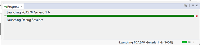

The issue is simple, I try to launch the debugger and it gets stuck at "Launching PGA970_Generic_1_6: (100%)". I tried cleaning and rebuilding the project with no errors. I am able to test the debug probe connection from the .ccxml file and it reports a success. I tried rebooting the computer and unplugging/replugging the debug probe. My coworker said he needed the USB2ANY attached to get it to work, but I've tried both with and without the USB2ANY connected with the same issue.

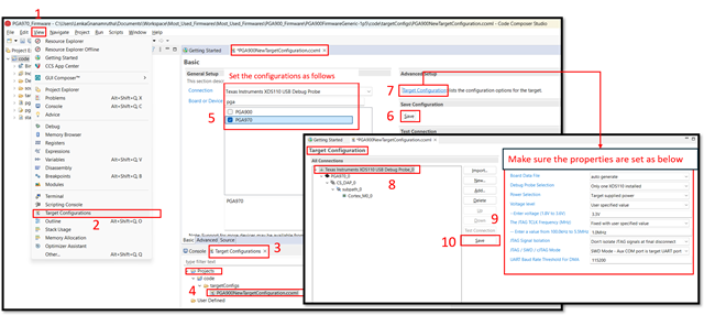

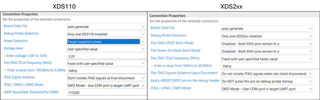

    What settings do you have your .ccxml file set to? These are the recommended settings with an XDS200 debugger:
    You can adjust those settings in CCS as follows (this image shows the configuration for an XDS110 debugger):
    It is also possible your Debug configuration in CCS is not setup correctly. You can follow the instructions here.

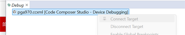

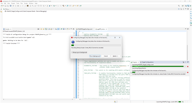

  • This is what CCS looks like when I try to debug:
    I checked the configuration and it matches. Here is my ccxml file:

    How are you launching your debug session? I'm using CCS v12.8, and this is the progress bar I see when I launch a debug session:
    I've never seen your issue before, but my best guess is that the target configuration file is not being launched correctly. I'll talk to my team to see if anyone else has seen this issue.

  • I was clicking the debug icon in the top bar. I followed your step by step instructions. Step 1 starts but gets stuck at launching 100%. The option for step 2 is grey:

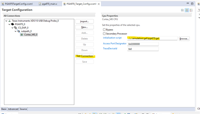

  • Hi Nathan,

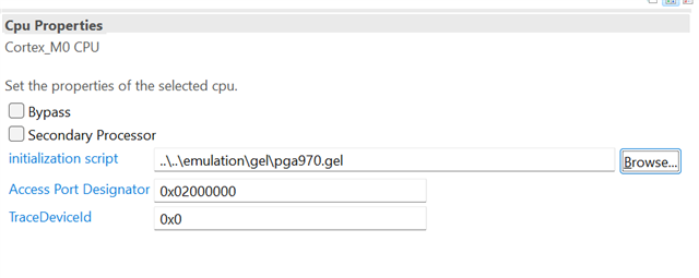

    What .gel file are you using? Can you please post it?
    Are you sure your target config file is linking to the correct .gel file?
    If you click "test connection" do you have a successful connection?
    You mentioned previously that a colleague was able to debug on their machine. Does your hardware setup match theirs? Are you using the same CCS project as them?
    Maggie
  • I am using the gel provided in the 1.6 firmware folder (I assume it's okay to post)
    pga970.gel
    I re-chose the gel file and nothing changed:
    Test connection reports a successful connection.

    I heard back from my team - none of them have encountered this error before. One colleague mentioned that your JTAG clock frequency in the target configuration is set to Adaptive. In our XDS110 target configuration, we set the JTAG clock frequency to Fixed. Can you try changing your clock frequency to Fixed?
    I assume you and your colleage are using separate PGA970 devices and XDS debuggers? Are you able to try your setup with your colleague's PGA970 and XDS debugger (so the only difference between their setup and your setup are the computers)?
    Maggie
  • I switched to fixed at 1MHz and it's still stuck at launching 100%. We use the same PGA970EVM and XDS200. I had him bring his desktop to my office and it worked on his desktop with my exact hardware setup.
