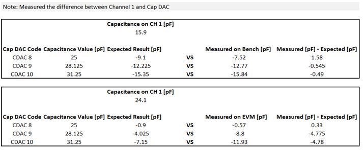

  • I checked with the Designers and Validation team, there has been no issue seen with this. A quick experiment was conducted.
    Using our bench board, the difference between measured and expected is never too high. Moore error on CAPDAC Code 8 is normal because we are activating the 4th bit "1000". Using the EVM board and software seems that passing between CAPDAC code 8 and code 9 the step is more than 1. It could be an error in the EVM GUI increasing the CAPDAC code.
    I would suggest trying another FDC part to verify that it's the part rather than the firmware or the hardware.

    Also from the above results i am having few doubts. In EVM there is a 4.7pF difference in CAPDAC 9 and 10 range. But in bench results i could see only 0.5pF difference in CAPDAC 9 and 10 range. But capacitance i/p is different in both the cases. Have you tried with 24.1pF in bench experiment with CAPDAC ranges 8, 9 and 10. Am having little doubt that may be same variation we can see in bench results too if i/p is 24.1pF.
  • From what we can see just by the numbers above, with using the EVM board and the GUI, it seems like it is passing between CAPDAC code 8 and code 9 the step is more than 1. It could be an error in the EVM GUI increasing the CAPDAC code.
    For instance:
    CAPDAC code 8 = Code 8
    CAPDAC code 9 = Code 10
    CAPDAC Code 10 = Code 11
    SO the missing code 9 will introduce error in all the next steps.
    This behavior is not seen in the bench results...

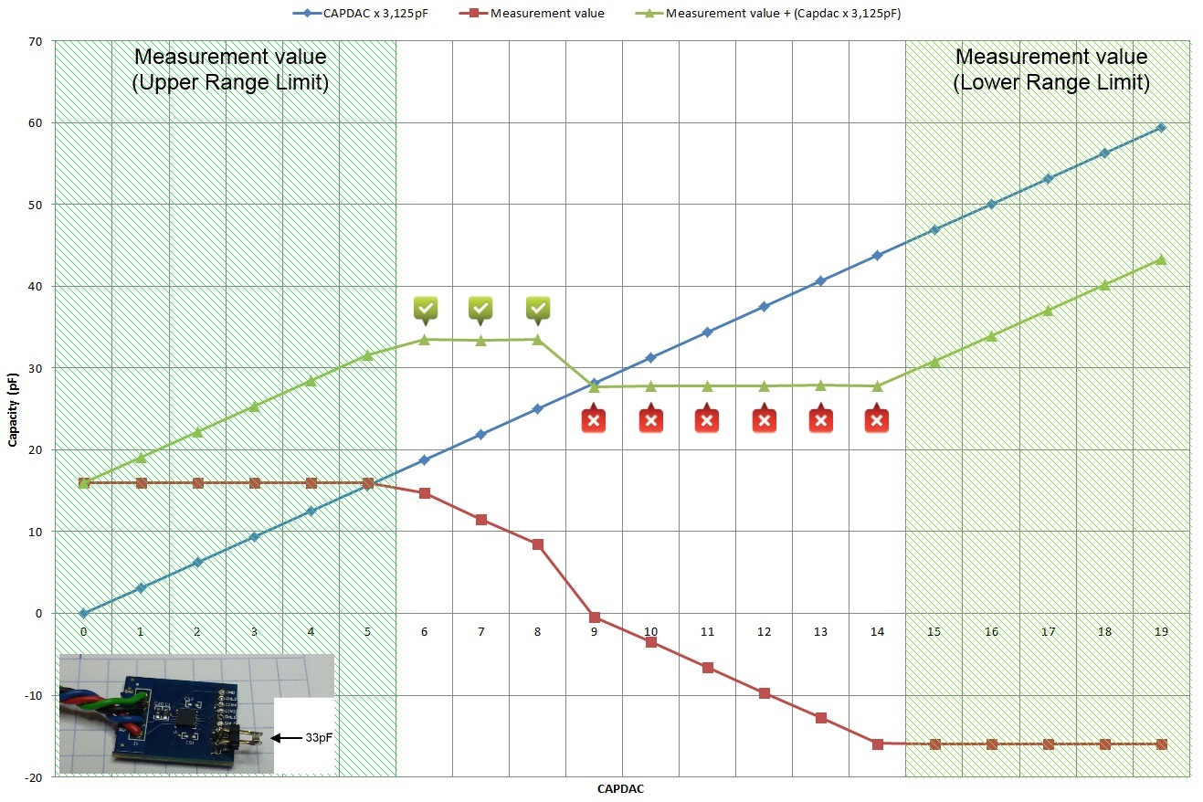

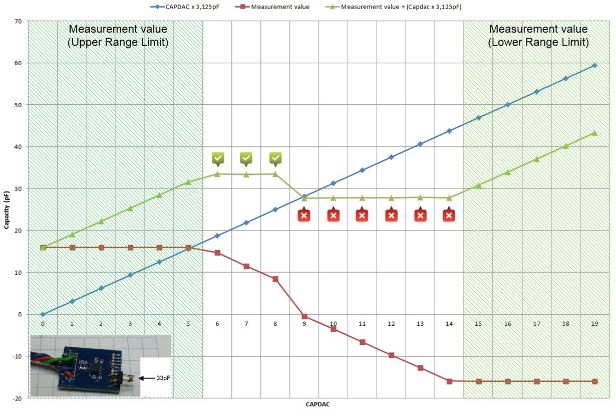

    I would like to participate in your discussion, as I observe the same behavior as Kandhasamy.
    In my application, I have to measure capacities in the range from 0pF to 80pF.
    If I choose a CAPDAC less or equal to 8, the FDC1004 shows the expected behavior and the
    addition of the measurement value and CAPDAC leads to the correct result (with very small deviations).
    The problems occurs after increasing CAPDAC from 8 ( 25pF ) to 9 (28.125pF). After setting CAPDAC to 9,
    the addition of the measurement value and capdac, leads to a result which differs by approximately -6pF from the correct value.

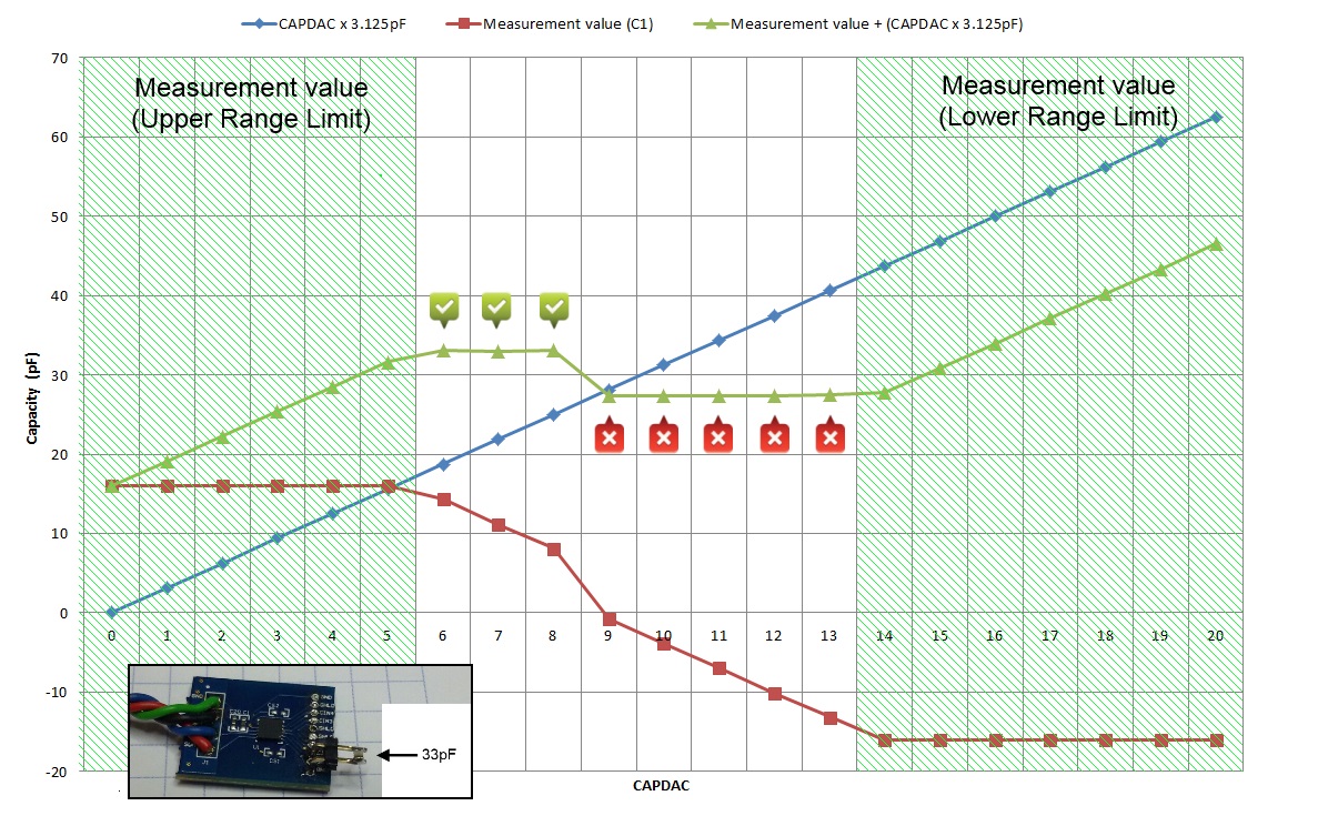

    I observed this behavior first on my own hardware with my own firmware. I build up five prototypes but all show the same behavior.
    Later I used the TI Evaluation board to verify my setup.
    But the evaluation board shows the same behavior. To illustrate the problem, I have taken a measurement series with the evaluation board.
    I connected a fixed capacitance of 33pF to channel 1 and increased CAPDAC step by step.
    Therefore I used the TI software (FDC1004 EVM GUI 0.0.0.7).  The  graph shows the logged values.
    As the Evaluation Board shows exactly the same behavior as my own boards, I exclude a defect of the chip.
    I assume that it is due to the FDC setting.
    To facilitate the error diagnosis I attached the log-file and the exported settings of the evaluation board.
    I would be very happy if you could find the reason or show me a kind of workaround.

    This behavior repeats itself when switching from 27 to 28. Then another displacement in the curve can be seen.

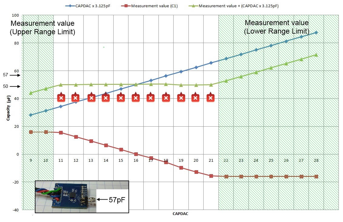

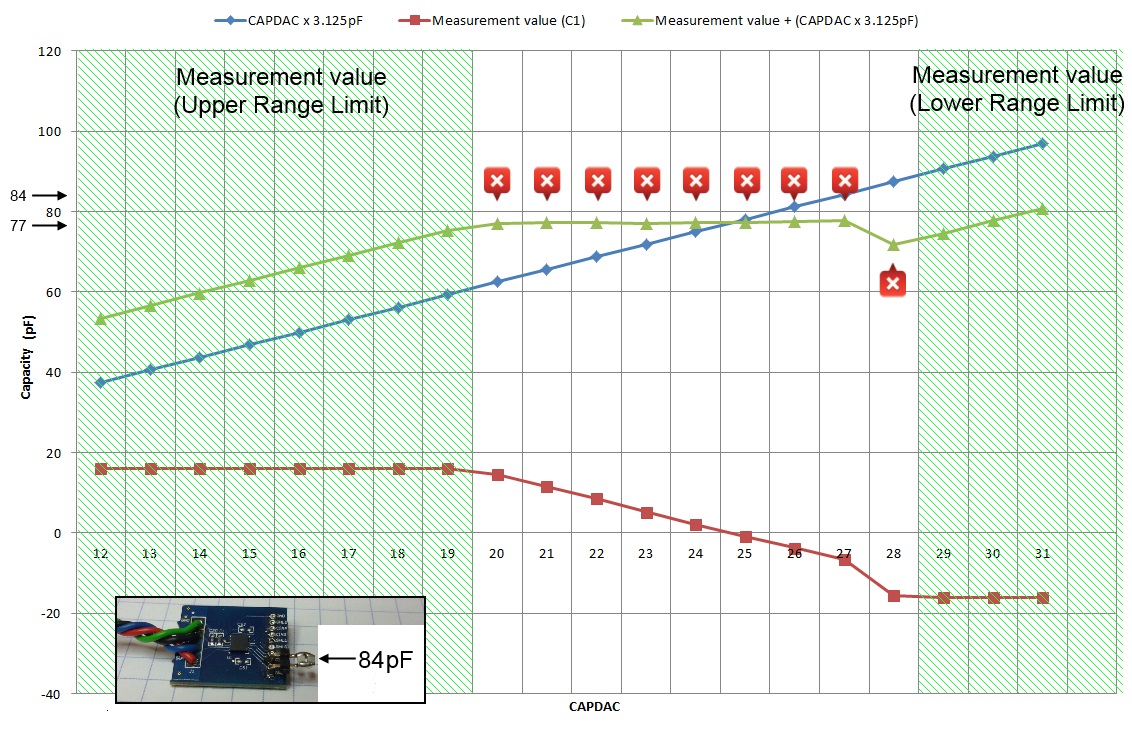

    today I have been thinking about Kandhasamy`s proposal and I made some measurements to verify if this could work.
    I've made three measurements with different capacities (33pF, 57pF and 84pF).
    The problem I observed is, that every measurement with CAPDAC higher than 8 differs by approximately -6pF.
    Measurements with a capdac higher than 27 differ by approximately -12pF.
    At the moment I'm at a loss.
    I had suspected that the error is due to the configuration of the FDC registers.
    I therefore read the FDC registers after each measurement and compared the settings with the setting for CAPDAC < 9, but I could see no pattern.
    I saved all the measurement result in excel-file`s. One file for each measurement. Each file contains one sheet with the measurement values and the graph, and a sheet for each capdac setting.
    Here are the data:
    Measurement with 33pF connected at C1:
    Measurement_C1_33pF.xlsx
    Measurement with 57pF connected at C1:
    Measurement_C1_57pF.xlsx
    Measurement with 84pF connected at C1:
    Measurement_C1_84pF.xlsx
    I'll wait for the moment and take no further attempts.

  • HI Michael and Kandhasamy:
    I talked to validation about this issue and they ran some experiments and looked at your data more careful. In final test, the CAPDAC is measured from code 0 to 7, trimmed for that, and then the rest of the codes are interpolated based on code 0 to 7. This introduces a gain error especially towards code 31. On bench, they measure all codes and trim so that's why this issue was never seen. Even at CAPDAC 8, there was a very small difference /error but not as significant as what you are seeing.
    The CAPDAC was not designed so that the full scale range is 0 to 100pF and be changed on the fly. It was only designed to offset the capacitance within the specified input capacitance range. One thing that you could do is to use the offset register to offset the measurements based on what they should be. The only drawback is that since there will be a variation from part to part, you cannot guarantee the modified measurement will be the same each time. It depends on your application and precision requirements.
    Hope that clears things up.

    I would like to hold on to the chip, even if the measured values differ in the upper regions. I've also been thinking about correcting the measurement values with a kind of correction table. However, it is not practicable determining a correction table for each part manually. At least not in series production.
    Here is what came up to my mind:
    In my application I have to measure two channels (C1 & C2).I could connect fixed capacitors to C3 and C4 which could serve as a kind of on board reference. The tolerance of these capacitors should be as small as possible. In this way I could determine the difference between the connected capacitance and the measured capacitance and create a kind of correction table for diffrent capdac values.
    With the values from the correction table I could correct the measured values of channel 1 and 2.
    This presupposes that the deviations is independent of the channel. For me this is difficult to verify. Maybe you or your colleagues have further information regarding the deviation between the channels.
    I'm not sure if this could work or whether it is a rather stupid idea.
    Maybe you can tell me your opinion.
    Best regards
    Michael
  • I'm not quite sure if that will work because there will be some deviations from part to part and among channels even though they try to trim the parts close to each other. I would assume that it would be dependent on your system requirements and accuracy/precision needed.
    You could try it and test it with other boards with different parts to determine if the variation becomes worse. That is something that we do not have data on.
    David Wang
    Capacitive Sensing Applications
