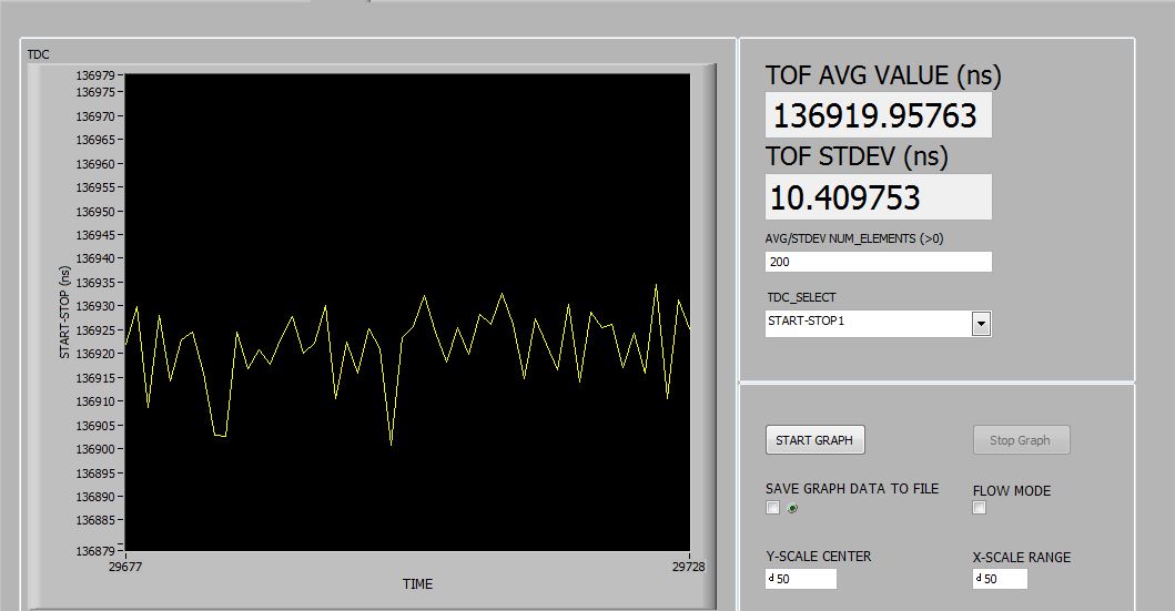

I'm currently conducting an experiment to see how the TOF varies with O2 Concentration.
I have a TDC1000-GASEVM/TDC1000-BSTEVM and am using the TDC1000_7200_EVM Software.
However, the graphical output of the measured TOF is very noisy and fluctuating by about 100ns, when it should be quite constant if the O2 concentration is constant (i'm using a portable oxygen concentrator to provide flow through the sensor)
It also outputs a fluctuating TOF when the sensor isn't connected to any oxygen source.
  • Hi Madeleine,
    Could you please save and upload your config file and a capture of the TOF graph? How do the fluctuations compare between the oxygen source and open air? Are they about the same, or is one worse than the other?
  • Hi Scott,
    After completing more work on this today, i'm not so worried about the fluctuations, but more concerned about if my TOF is correct for my transducer measurements.
    Please find attached my config file and screenshots of graphs at 90% and 20% O2. Additionally, my transducer is approximately 5.5cm, so using the formula TOF = distance between transducers/speed of sound I am not getting the correct values.

  • I suggest taking a look at the START, STOP, and COMPIN signals on an oscilloscope. I think it is likely that the ringdown from the transducer is triggering a STOP signal well before the return echo is able to make its way back to the transducer.
    For debugging purposes, set the NUM_RX register to "No RX event count" and turn on the Continuous Trigger. This will generate a STOP for every valid signal within the measurement window, and allow you to monitor the signals with your oscilloscope.
    With a 5.5cm distance (one way), you would expect the round trip TOF to be somewhere in the 300-350us range, correct (speed of sound roughly 330m/s)? To start with, you can try adjusting the TIMING_REG[7:0] in the GUI to about 100. This will blank the signal for 280us (since you already have the Blanking enabled in the CONFIG3 register) and should avoid any erroneous stop signals prior to your true return echo.

  • Hi Madeleine,
    Since you are firing directly toward the receiver and not a reflector and waiting for an echo, you would only account for the one-way time. This would be about half the 300-350us, so 150-175us.
    It looks like you have Damping enabled, and are currently using Mode 0, which is intended for use with a single transducer receiving and transmitting. I suggest turning off Damping and switching to Mode 1, so that the second transducer is now used as the receiver.
    Regads,
  • Hi Scott,
    I tried on both mode 0 and mode 1 (with damping disabled)
    However, on mode 1 my TOF is around 390us, and on mode 0, my TOF is around 150us. Mode 0 also has a much lower standard deviation of approximately 20.
