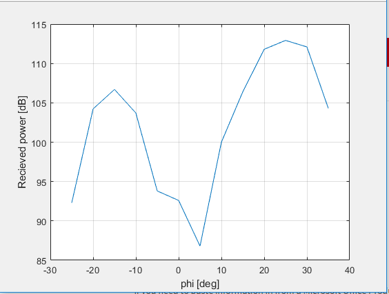

  • Hi Joe,
    I have placed a corner reflector in a distance of 1 [m] from the radar at
    the same height and then rotated the radar in the elevation angle phi, and
    documented the received power in dB as shown in the "mmWave Demo Visualizer".
    This is the results I get:
    As you can see, we lose around 20 [dB] when mounting the radar at phi=0 because of this radiation pattern.
    Can you explain this?
    Is it normal?
    Boaz
    We don't currently have antenna measurements of the EVM. We have simulations. The simulations at 78.5Ghz do not show this offset. (see previous graph - shows 5 deg), The simulations at 81Ghz show the two peaks, but the null is shifted to -8 degrees. In the simulation graphs these are shown as azimuth changes in Rx.
    Please tell us how many EVMs are measuring this way in your batch, and if the older software has the same effect on 1 bad EVM.
    I will ask, if we have different batch EVMs that could replace the mis-performing ones.
    I will try to get an EVM in your reported SN range, to test. I don't see an elevation affect on my IWR1642 EVM which is about 6-8mo old.
    Joe Quintal

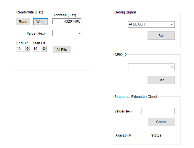

  •  Hello,
    If you use Radar Studio which can be downloaded from the Ti website, and you have the Devpack board,   You can use the sample configuration attached, and add one set of manual operations, (RegOps tab) to write a debug value, @0x4320140C, read, modify bits 16.19 with 0x7.  This will activate the 40Mhz crystal clock to the J2 connector, should be 1v amplitude, 40Mhz with 50 ppm.   This can be used to validate the 40Mhz clock.

    I will need some description of the setup in order to test the PLL with the radar studio.
    Except the IWR1642 EVM, Do I need?
    1. The DFP board?
    2. The TSW1400 board?
    3. A scope?
    Boaz
  • Hi Joe,
    After following the instructions above I don't see any signal coming out to the J2 connector.
    I do see the 40 MHz sine wave when I connect directly to the oscillator.
    Boaz

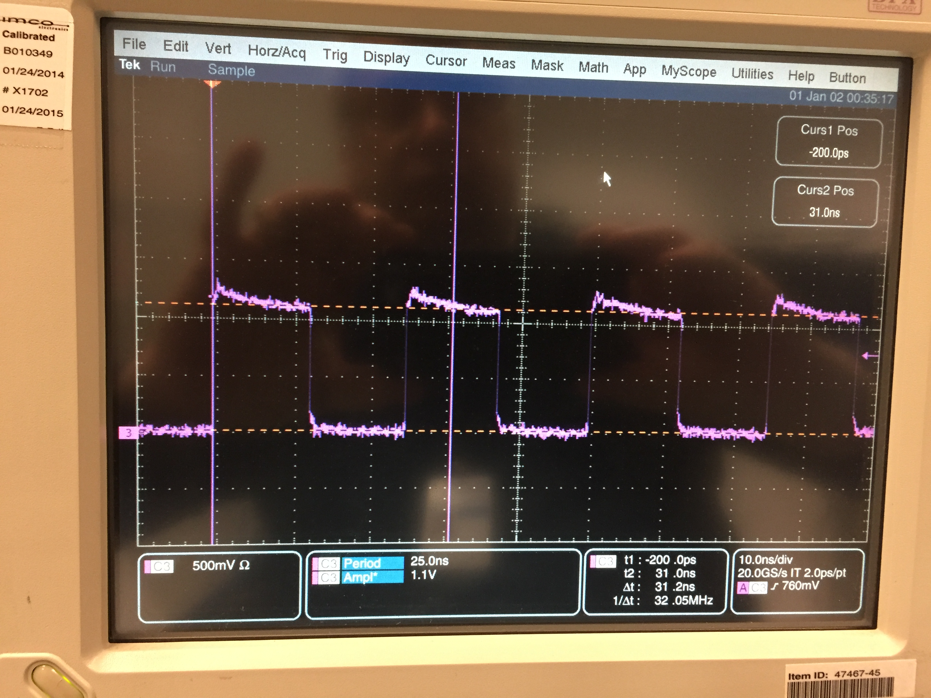

  • Hi Joe.
    I got it.
    The signal looks quite different from yours:
  • Hi Joe,
    From my measurements I get:
    good board - 40 MHz with 12 PPM
    bad board - 40 MHz with 17 PPM
