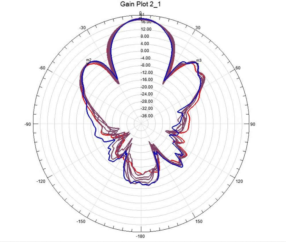

    I have simulated the antennas, and I can get per element antenna directivity gain similar to the ones you shared.
    However, my question is related to radar equation/link budget and radar FOV (field-of-View).  how to calculate the max range distance due to path loss, since you need gain TX and gain RX.
    if the modulation scheme is BPM, Tx1 and TX2, transmit the power at the same time, would that be forming an array ? please see below my simulation of TX1+TX2 and RX1+RX2+RX3+RX4 as an array in azimuth plane.
    should I use array gain of TX1 and TX2, instead of gain of per element antenna ?
    Muhyin
     TX1+TX2
     RX1+RX2+RX3+RX4

    could you please elaborate more on no path loss ? the signal will propagate through air, and i think should get some path loss. in attached TI document, page 15, it is shown there is.
    when i select the rx number 4, the gain is increased. is this at bore sight 0 degree azimuth ? what is the gain, if the signal coming from angle 30,45 or 60 deg ?

    The calculation is at bore sight, you would need to combine the radiation pattern in the xWR1642 or xWR1443 BOOST User Guide to get the off axis gain, as that would be different depending on the angle.

  • Hi Joe,
    Could you please share the information of combine radiation pattern ?
    especially at +-30 deg. as in our simulation. it indicates low gain, due to null on array 4 antenna RX .

    Normally we are limited to 2 simulateneous Tx, for BPM or TDM MIMO.   These use the 4 Rx antennas.  I do not have antenna pattern measurements for this case.
    I will ask the other application engineers.
