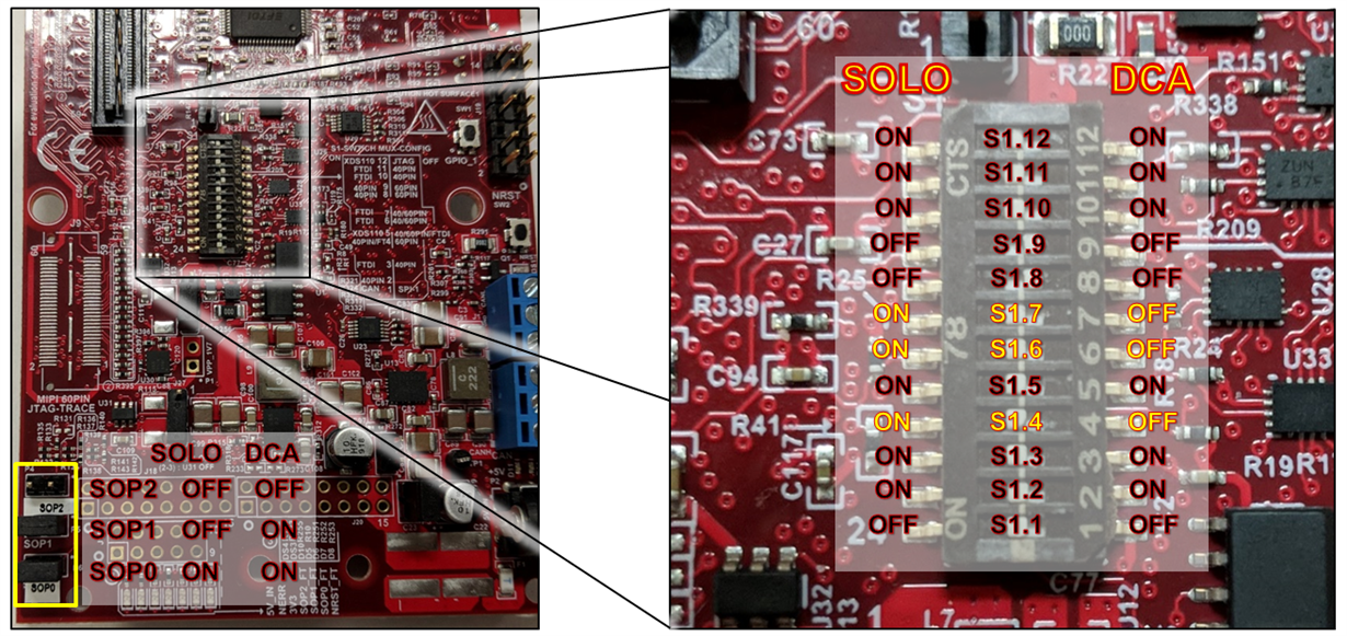

I'm trying to use mmWave Studio 2.0.0.2 to work with "IWR6843ISK+MMWAVEICBOOST" combo and DCA1000EVM. I'm pretty sure that I get the two boards connected correctly. I can see all the 4 FDTI ports and also the 2 XDS110 ports under "Device Manager". I'm successful with the first step. I'm getting stuck in the step of "RS232 Operations": I have the a COM Port (COM11) for "XDS110 Class Application/User UART" under Device Manager/Port, the FDTI Connectivity Status is "Connected". I have also closed the jumper on SOP0 and SOP1, leaving SOP2 open. But I am getting an error when I click on Connect under RS232 Operations:
Error: [RadarAPI]: Error: Connection failed: Calling ConnectTarget returned 3
and the "RS232 Connectivity Status: Disconnected" is not turned into "Connected".
Could you help?
