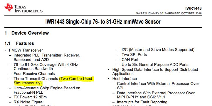

I have a question about the number of simultaneously transmit antennas in IWR1443.
The IWR1443 data sheet states that simultaneous transmission is possible with two Tx.
However, I am confused because the OOB demo is capable of transmitting 3 Tx and Cfg notifying 3 antennas.
I compare the IWR1443 with the IWR1642 and I understand that the added third antenna is an antenna with resolution in the elevation direction.
Using the OOB demo as an example, if 3 Tx is set, are you transmitting at the same time, or you are using one of the two azimuth antennas and one elevation antenna at the same time?
If it is not transmitting simultaneously on 3 Txs, I also want to know how to realize MIMO for azimuth and elevation direction.
(I understand that implement MIMO using 3 antennas, two in azimuth and one in elevation.)

Hi Takuma,
The antenna is not transmitting at the same time on all Txs- they will be sending chirps at 3 different times.
Please take a look at the user guide for more help on the demo visualizer.
http://www.ti.com/lit/ug/swru529b/swru529b.pdf
-Chloe
Hi Chloe,
Thank you for your reply.
I would like to clarify further, but in the case of IWR1443, is it correct that TDM-MIMO is realized by transmitting three Txs at different timings?
Takuma
Please see section 4.1 of this app note for help on TDM-MIMO.
http://www.ti.com/lit/an/swra554a/swra554a.pdf
