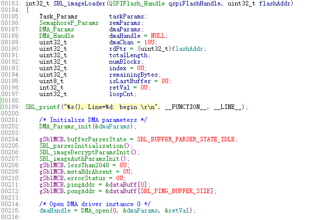

IWR6843ISK: SBL: SBL_imageLoader() Fail to Downloads the Application Metaimage from FLASH to respective RAMs
Part Number: IWR6843ISK
Other Parts Discussed in Thread: IWR6843, UNIFLASH, MMWAVEICBOOST,
Hi TI Expert,
We want to use SBL to control image update, but meet a issue when test SBL: Fail to Downloads the Application Metaimage from FLASH to respective RAMs
fail log as below,
Debug: Loading backup factory default image from Flash address: c0180000
SBL_imageLoader(), Line=198: begin
SBL_imageLoader(), Line=252: gSblMCB.metaHdrAbsent = 0
SBL_imageLoader(), Line=260: gSblMCB.bufferParserState = 3
SBL_imageLoader(), Line=271: numBlocks = 242, totalLength = 496128
SBL_imageLoader(), Line=292: loopCnt = 2
SBL_imageLoader(), Line=298: Switch the buffer
SBL_imageLoader(), Line=303
SBL_imageLoader(), Line=305
SBL_imageLoader(), Line=307
SBL_imageLoader(), Line=310: Switch the buffer
SBL_imageLoader(), Line=292: loopCnt = 3
SBL_imageLoader(), Line=292: loopCnt = 64
SBL_imageLoader(), Line=292: loopCnt = 65
SBL_imageLoader(), Line=305                            // block at here
The related code as as below, (just add log in code)

    We are not able to reproduce the issue. Is there any changes that you have made to the SBL code.
    Yogesh
  • Hi TI Expert,
    We just to add log for checking the fail reason, and does not change any other code.
    BRs
    Could you please format the SFlash using Uniflash first then flash the SBL and application metaimage again and see if you get this error?
    -Nitin

    Could you please answer couple of question to narrow down the issue:
    1) Are you using TI MMWAVEICBOOST + IWR6843ISK or is this your own custom board.
    2) If this is TI MMWAVEICBOOST + IWR6843ISK:
        Did you try to send the same file using xmodem protocol to see if you are able to update.
    3) Did you try to connect to CCS once the log stopped. If yes, where was the Program Counter, could you please share some details.
    Yogesh
