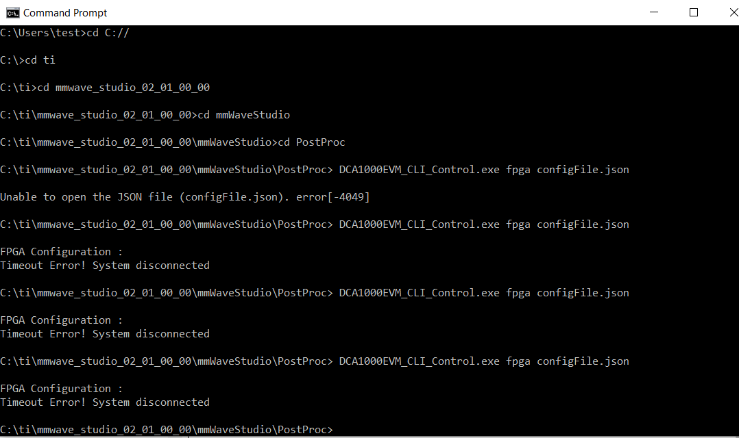

    However, when I try to use DCA1000CLI with command window, it reports that disconnect to FPGA.
    Our MMBoost board version is ES1.0, so the mmwave studio version might be used mmwave_studio_02_00_00_02, but the DCA1000EVM_CLI_Control.exe doesn't exist in this package and only in mmwave_studio_02_01_00_00(supported ES2.0).
    Could the ES1.0 board support for DCA1000EVM_CLI?

    Can you send the screen copy of the error message?
    Please compare your setup with the attached figures below and pay attention to the switch and SOP setting circled in red on both DCA1000 board and mmwave IC booster.
    By the way, when you mentioned ES 1.0, are you talking about radar device or mmwave IC booster board?
    Zigang

    Ernie Chou 周佑昱
    the setup is as following:
    The error message and the demo visualizer setup are as following
    By the way,  the ES1.0 which I mentioned is the radar device version. I'm using iwr6843 ES1.0 module, and the depending software, mmwave studio 2.0.0 and mmwave sdk 3.2.1.
  • HI,
    The setup looks fine to me.   The error indicate the json file loading issue. Do you have that json file in that directory?
    I see you are running visualizer for binary code.  Were you able to run the code, and see output such as detection in visualizer?
    Zigang

  • HI,
    Did you ever used radar studio for data capture?  Do you understand that in order to connect to DCA1000, you need to select the static IP address in the PC local area network properties and connect Ethernet cable and disable wifi, disable firewall if you have any.
    By the way,   do you still see that error complaining about json file in your DOS command window?
    Zigang
