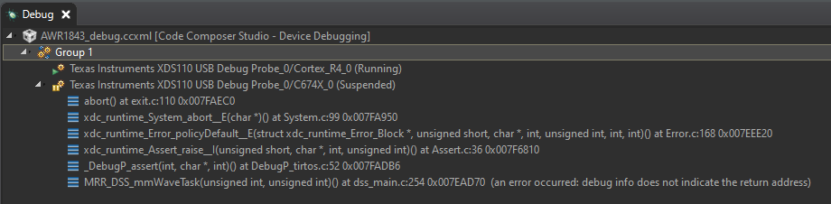

    After doing that, I still get an error resulting in termination, but now in the dss:
  • This is the function call trace after it crashes:
    This effectively means that frame idle time is not sufficient to transmit all the object data over UART/CAN interface.
    And if you intent you stream all the object data over CAN interface and disable UART functions in the output function, use only CAN interface to stream the object data (not UART). This way you would save some time and may not get ASSERT.
    And in the last option increase the frame idle time in the configuration to avoid this assert.
    Jitendra
  • Thanks Jitendra! Problem solved
