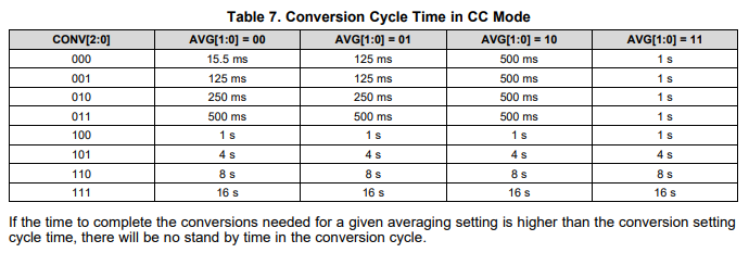

  • Hi Hector,
    Both OS and CC support averaging. Averaging increases the measurement time in either mode. Some CC modes target a refresh rate which is not possible with all averaging modes. This doesn't make those settings invalid; Table 7 explains what happens.
    It's not explicitly stated in the datasheet, but Table 7 also explains what happens to measurement time in OS mode. When averaging is disabled (AVG=00,) the measurement time is 15.5ms. Measurement time increases to 8x, 32x, 64x as you move to the right in the first row of Table 7.
    thanks,
    ren
  • Hi Ren,
    Both modes support averaging. What are the advantages of using CC mode?
    OS can support averaging and provide lower power consumption than CC mode which can reduce the self-heating effect.
    I still don't understand what differences between the two modes are?
    Do any benefits users select to use CC mode?
    Thanks.
  • Hi Hector,
    CC is the default mode and is more convenient to use. You can read the temperature register at any time to get the most recent temperature measurement. To use OS, you must trigger a measurement to start, wait for it to complete, and then read the result.
    thanks,
    ren
