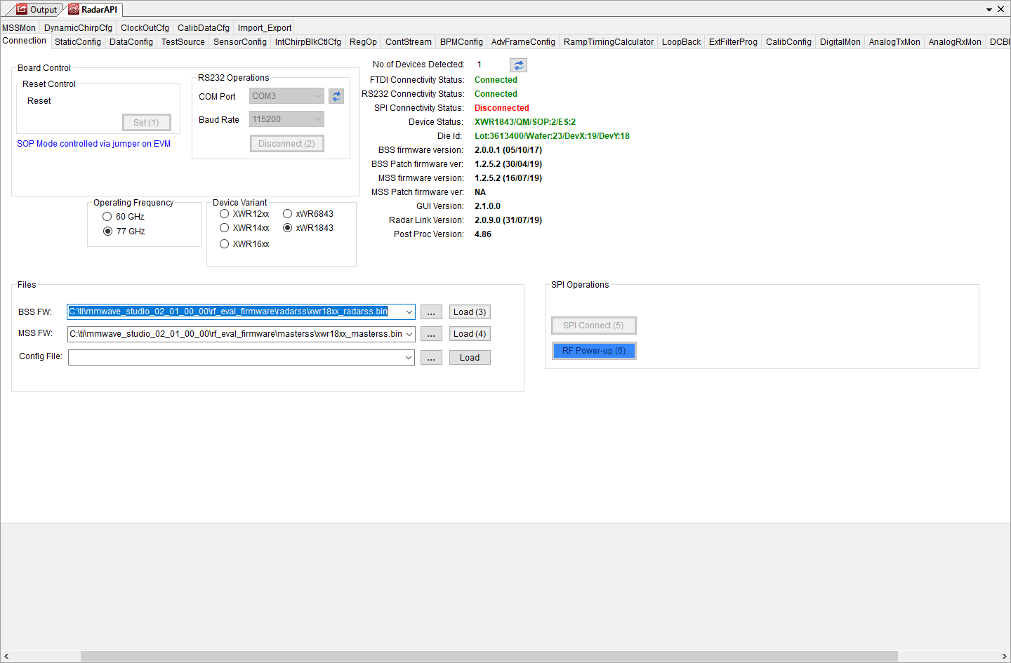

[12:22:28] [RadarAPI]: ar1.PowerOn(0, 1000, 0, 0)
[12:22:28] Status: Failed, Error Type: RESP TIMEOUT
[12:22:32] MSS Power Up async event was not received!

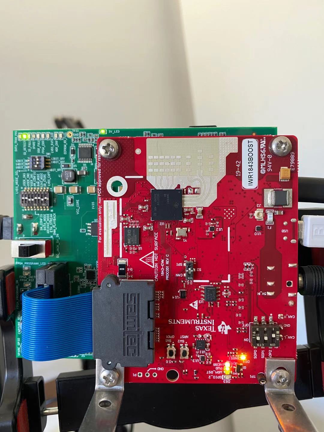

1. all 6 ports can be seen in the device manager
2. I can see the packages Ethernet
There are my device snapshot and mmWave studio screenshot
Could u help me solve this problem?

  • Hello Officers,
    Is the MSS Path Firmware ver: NA in the mmWave studio connection section after clicking the "Load MSS FW" botton means something.
    I actullay checked the training vedio of DCA 1000 EVM again and it shows same in the video.
    Xi

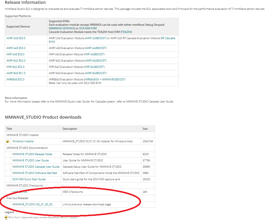

  • Hi, Zigang
    First of all, thanks for u reply.
    I have checked each version of mmWave studio and I didn't find a compatible version with my device(IWR1843BOOST).
    There are only 4 versions of mmWave Studio, including 2.01.01.0 , 2.01.0.0, 2.0.0.2 and 1.0.0.0. In their release notes, my device is't in the supported device list. In addition, my device(IWR1843BOOST) should be came out in second half year of 2020 so I think the earlier version should not be working in this way. I actually have tried each of these 4 versions and non-of-them was working.
    Is that means I need to write my own code which capture the raw data from ethernet port.
    Xi
  • Hi Zigang,
    The problem is “The firmware version does not align with the silicon version“ and I cannot change the silicon verison. So I am thinking where I can find the newest verisoni of MSS firmware. I have tried to search in TI website but I didn't find one. I also searched in the SDK pacakge and I can only found BSS firmware not the MSS one.
    Xi
  • HI, Xi:
    I consult with the team. It turns out that the release notes has a typo, and it support XWR1843 ES2 instead of XWR1843 ES1.
    IWR1843BOOST is just the board name, not the device name.  Your device is XWR1843ES2 based on your second picture in your original thread.
    Please try with the latest radar studio version 02.01.01.00.    If it still does not work,  please try to run SDK OOB demo with IWR1843BOOST by itself (without DCA1000) to make sure the device is working.
    Zigang

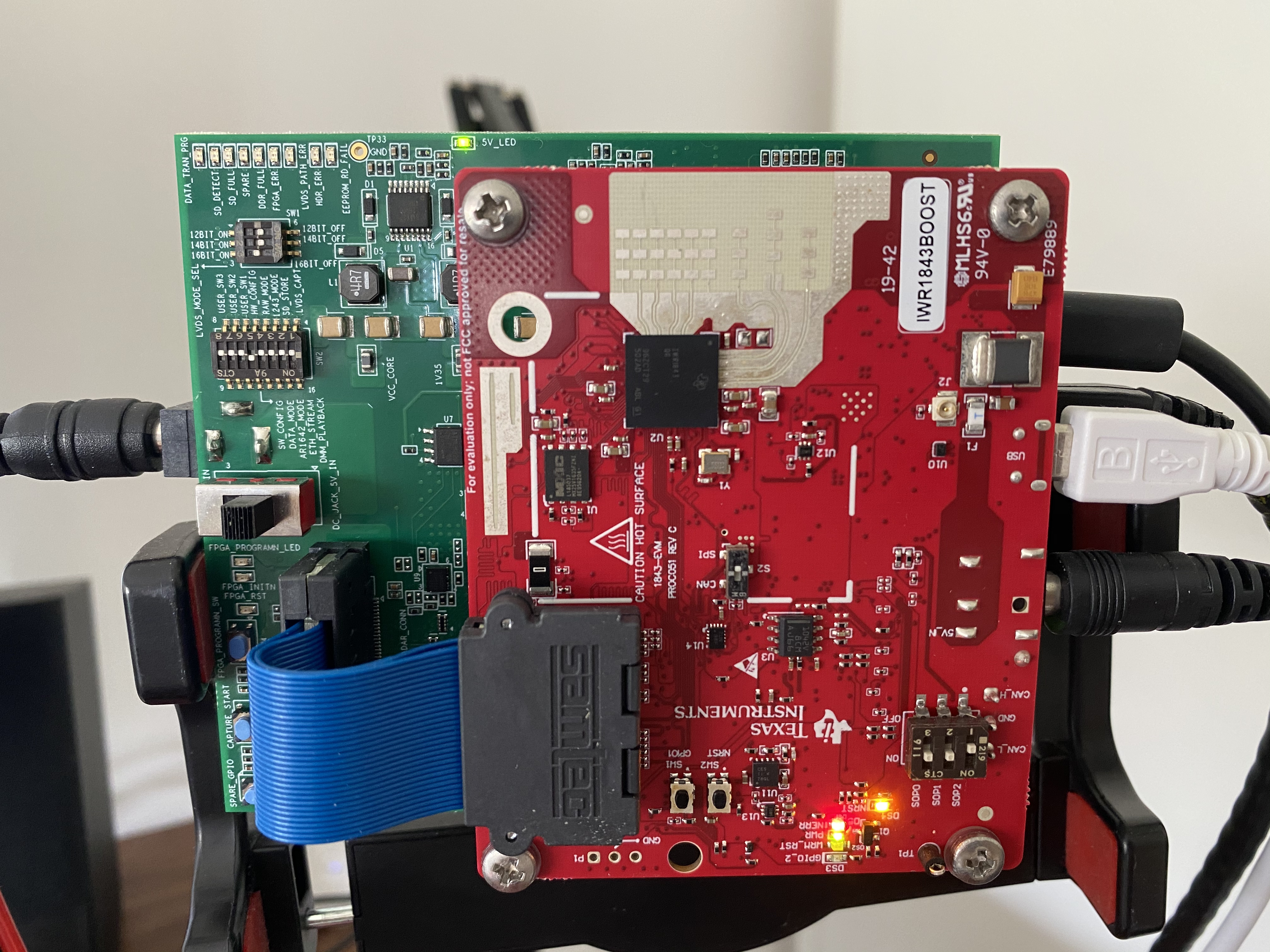

  • Get a feedback within the team:
    The S2 switch needs to be set to the “SPI” position. It appears that the switch is set in the mid-point position. This switch is used to toggle between the SPI and CAN connection being brought out on the EVM. The S2 switch needs to be set to the SPI position. The SPI protocol is what is used for issuing commands in mmWave Studio to the AWR1843BOOST EVM. This is why the SPI Connect step is erroring out every time, regardless of the firmware being loaded onto the device.
    Please make this change, setting the S2 switch to the “SPI” position, and see if this resolves your issue.
    Zigang
  • Hi, Zigang
    I have checked S2 switch several times and it is in the position pointing to SPI mode. Despite this, I have tried to run it again but the problem is still the same.
    The solution that the team point out is the one I have found in the other post.
    And you can check the picture, the red box shows the position is on SPI.
    Zigang

  • Here is the feedback I got:
    QM means it is a IWR board not AWR.  The firmware should be the same for both IWR and AWR boards.
    Can you probe on a scope the SPI pins to check if there is any SPI activity?
    Zigang
  • HI,
    I got my IWR1843 board, and it works for me.
    So please double check
    1) your blue cable (that connect between two boards) are connected well.
    2) your sw2 is switch to SPI, please double check with scope on SPI pins.  It is possible that your SPI connection is not working well.  In that case, please check another board if it is possible.
    Zigang
  • Hi Zigang,
    I don't have an oscilloscope device now. I actually double checked the 60pin cables and it is not problem.
    Do you suggest me to purchase one in order to test the status of SPI pins.
    Xi
  • Hi Zigang,
    BTW, I could use the LVSD to collect the raw data. Therefore, I think that the only problem is located in the SPI connection. And I also purchase a new set of power supply which will be delivered in 3 days.
    Xi
  • HI, Xi:
    Sorry I can not make a decision for me.  If Oscilloscope is not much user to you in general, maybe you can order a new board.
    Zigang
  • Hi Zigang,
    Good news, the new board is working for me. For the old board, all funcitons are working except the SPI connection which drives me crazy.
    Finally, I found out the problem and thanks for your consistent support.
    Xi
