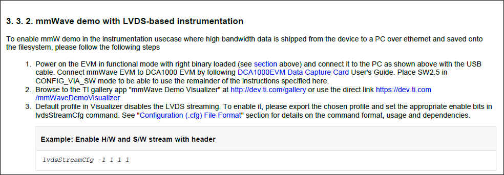

I was wondering if it is possible to setup my devices to do both raw data capture with the DCA1000 device and at the same time capture preprocessed data over UART/USB (with a mmwave icboost board and xWR6843 EVM board). In the preprocessed data, I would have applied algorithms such as FFT, CFAR, etc as provided by TI.
My aim is to be able to compare the performance of my self developed algorithms vs that from TI. Also, I will like to use the raw data for other forms of analyses.
