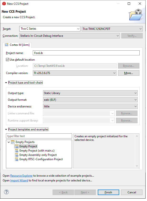

I'm using CCS version 11.1.0.00011.  I'm trying to create a static lib.  From the pulldown menus I select "File", then "New" then "CCS Project".  See below for the settings I chose.  I click "Finish" and the project is created.  I then go to project Properties for the project (FooLib) and when clicking the "Build" property I get the message shown in the second image below  "The currently displayed page contains invalid values".
Is this a bug???

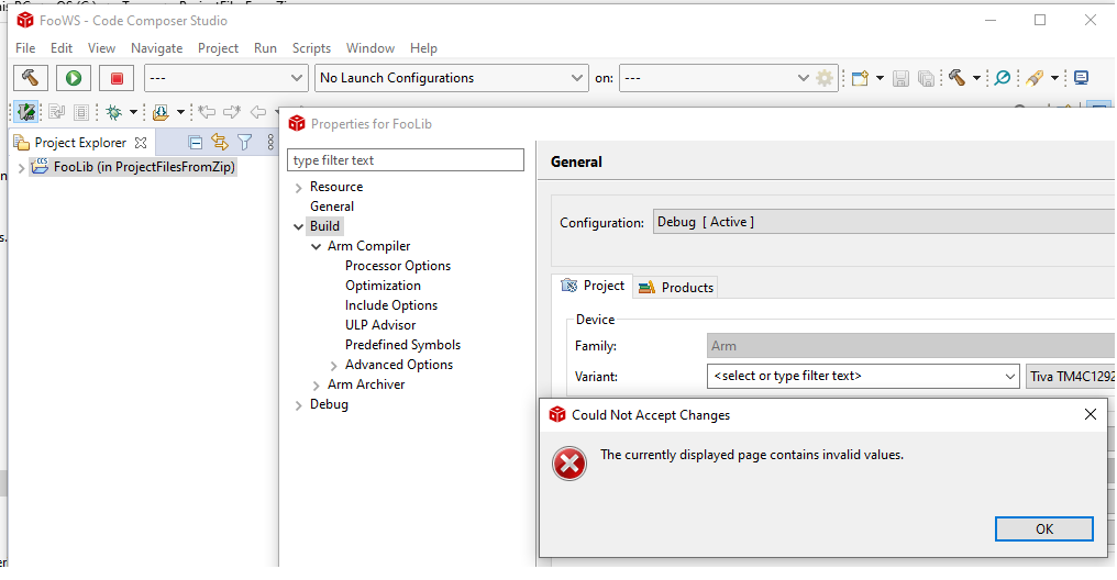

  • Hi Ki - Thanks for the feedback.  I did as you asked and I get the same problem as before.  See the screenshot below.  When I go to properties of FooLib after importing it and click on "Build" the same message appears.
    It's interesting that if I click on "General" and then select "Build" again I don't get the error message but it just shows an empty page for "Build" as shown in the second screenshot below.

    Also, in your screenshots, I notice a few toolbar buttons which I do not recognize.  Could you please let me know if you've installed any other Eclipse plugins into your CCS, or if you've updated any of the Eclipse/CDT components?  If yes, could you let me know exactly what you did?  It is possible that you now have an inconsistent set of components, and you might have to re-install your CCS (btw, CCS v11.2.0 is now available, and I recommend you install that instead).

  • Hi Terence,
    Installing CDT over CCS is probably what is breaking the Properties dialog.  You should actually not need to install CDT, because CCS is already built on top of CDT, so CDT is already there.
    Could you try installing CCS 11.2.0 and see if that fixes your issue?  You can download it here: https://www.ti.com/tool/download/CCSTUDIO

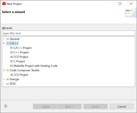

  • Hi Terence,
    As Ki mentioned, a "CCS Project" created in CCS, will only support TI devices.  But CCS does include CDT, so you should be able to create "CDT Projects", and use MinGW, for example.  If you install a fresh copy of CCS v11.2.0, and go to File > New > Project..., you will see a generic Eclipse New Project wizard that allows you to create projects other than "CCS Project".  Everything you see below under the "C/C++" node is a CDT wizard (with the exception of "CCS Project", which is also repeated there):
    So you should be able to create any type of CDT project directly in CCS, without installing any additional plugins.  The only caveat is that if you run into any issues with CDT projects, we might not be able to offer much guidance or any support.  We don't have any control over the CDT functionality in CCS.
    Also, please let us know if installing a fresh CCS v11.2.0 fixes the issue with the Properties dialog.
