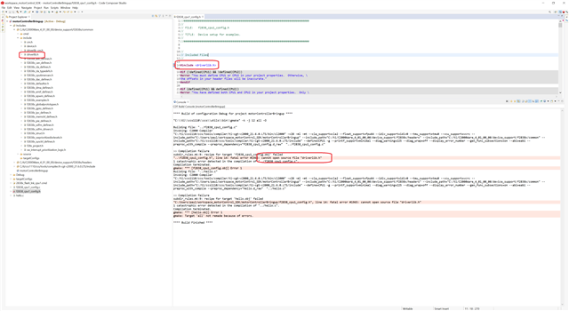

I am getting an error during build, in which the compiler cannot find a file, however this file is from the included section of the project. Is there a reason CCS cannot see this file?
Paul,
The compiler is not able to find the header file as it is in a subfolder of one of the include paths specified in the project. If you take a look at the include paths for the project you would want to add ${C2000WARE_ROOT}/device_support/f2838x/common/include
Alternatively, you could add the /include to the #include statement
