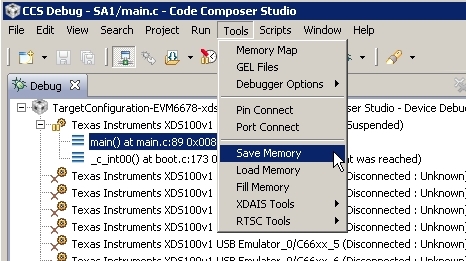

I installed the latest ccs5.1 release ((5.1 RC1, Release Candidate,  5.1.0.08020, Oct 12, 2011), along with BIOS-MCSDK 02_00_03_1, Platform is Win7-64bit.
Now I am missing some menue entries in the Tools Menue, actually all Profile/Trace/Analyzer entries are missing.
I use a free license, with EVMC6678 board and xds100v1 emulator.
see screenshots below.
Any sugesstions ?
regards
Alois

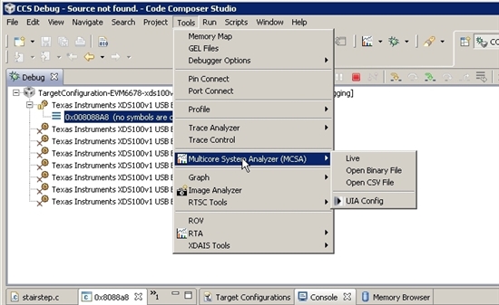

In ccs5.1 rc1 tools menue entries are missing:
the ccs5.0 menue looks perfect.

  • Hi Alois,
    we have been able to reproduce this issue, caused by an incompatibility between the MCSKD (intended for 5.0) and the System Analyser built into 5.1.
    For the moment, one of the only work arounds, is to unintsall 5.1 and install it again uncheking the MSA option.   You should then be ok.
    We are looking into this and sorry for any inconvenience.
    Lisa
  • Hi Lisa,
    the issue is solved now, the workaround is perfect !
    Just for clarity: I reinstalled ccs5.1 and then MCSDK, unchecking the MSA option is done during MCSDK installation.
